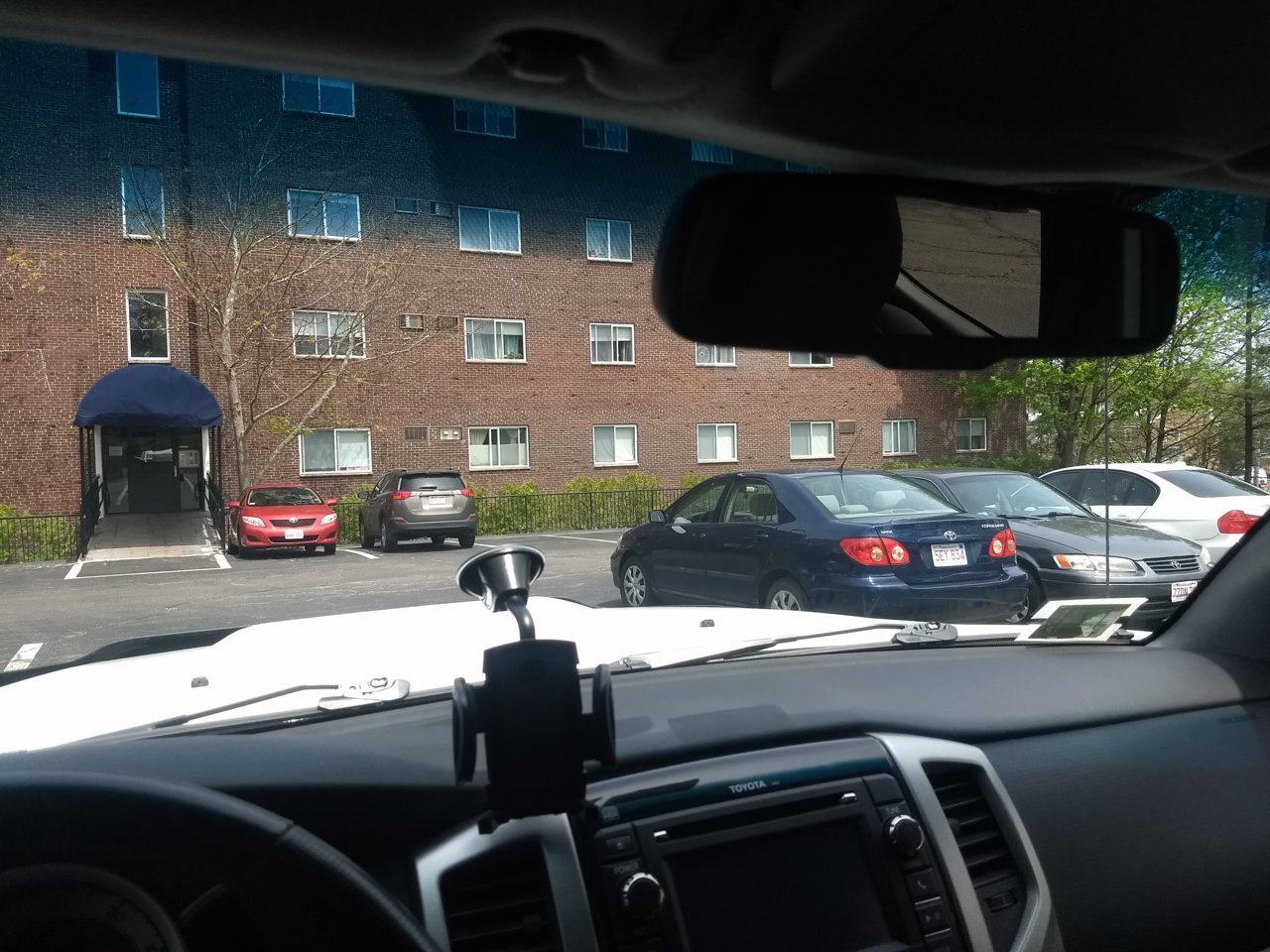

    Here's the new windshield. I'm currently epoxying the old shoe higher up.

    Finished product.
