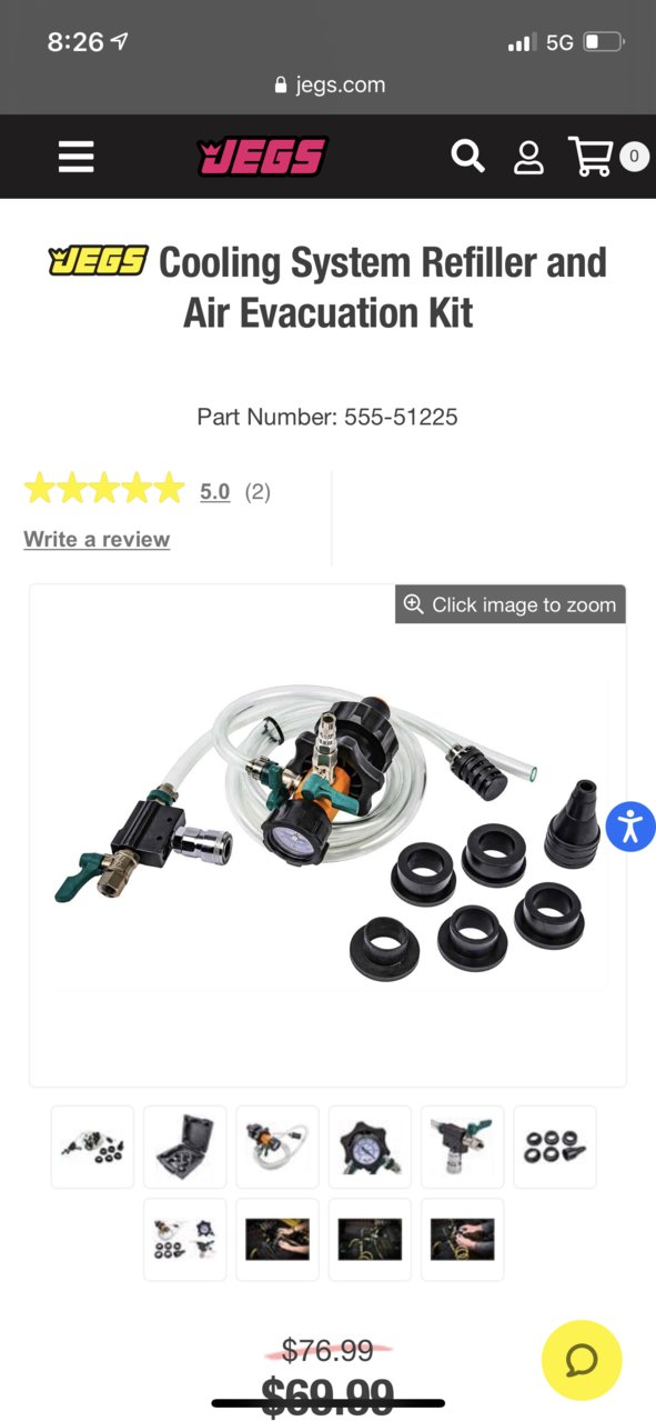

    I had a similar problem on my 07. Couldn’t get all the air out of the system to save my ass. Tried every trick in the book. Picked up one of these and it worked great. Might do the trick for you. 5962914D-94A4-4E4D-9947-BCFE23E16AF4.jpg

    It does take a constant 90psi to pull the vacuum in the system so you need an air compressor at least 20 gal. I don’t think anything smaller will work.

    Yea those work good for cooling systems prone to airlocks, I use the AirLift branded one at the shop. The downside for a DIYer is the price and the need of a decent size air compressor.

    That is a negative, nothing is circulating through the radiator. I ordered one of those cooling system refill and air evacuation kits. When it does come in I will have a go at it.
