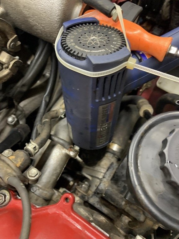

    Like I said I would get to it. There was trapped air between the thermostat and the water pump. I tried opening the highest point on a temp sensor, no air came out. I tried pulling a hose at the bulkhead water valve and no air came forth. I tried pressurizing it to no avail the water pump was not circulating so...
    I did this.. I placed a heat gun set on high right on top of the thermostat, removed the spark plugs and spun the starter off and on until the thermostat opened up. and once it did the air finally vacated. IMG_7206.jpg

    That's a clever trick, glad it worked out for you:thumbsup:

    Gotta admit that was a very strange one.
    Glad you got it figured out.
