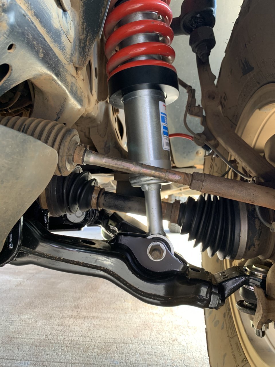

    Last week I got the following done(pertaining to my inquiry):
    - New OEM LCA’s with new OEM cam bolts
    - 1” Toytec Spring Seat Spacer for the TRD Baja Bilstein coilovers
    - Driver’s center of hub to fender 23 1/4”
    - Passenger’s center of hub to fender 23 3/4”
    - Half tank of gas
    - New wheel bearings/hub assemblies(if it matters)
    To add what I already had done:
    - 295/75R16 BFG TA KO2
    - CMC
    - Pinch weld flattened
    - Icon Tubular Delta Joints
    - Icon RXT Leafpack on Option 1
    - No armor, sliders, bed accessories
    I had the shop set my alignment as followed:
    - Caster 5° even D/P
    - Camber 0° even D/P
    - Toe 0° even D/P

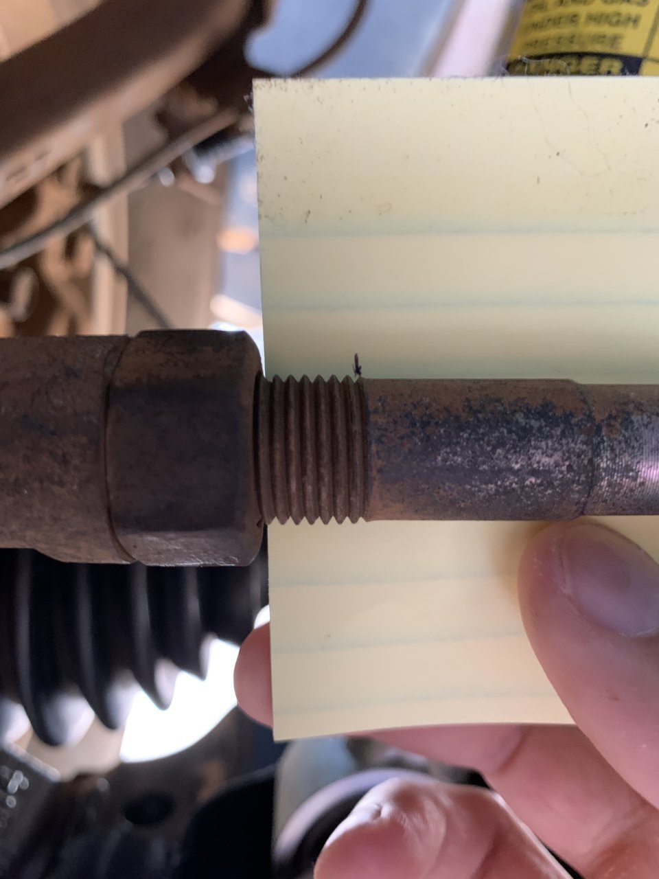

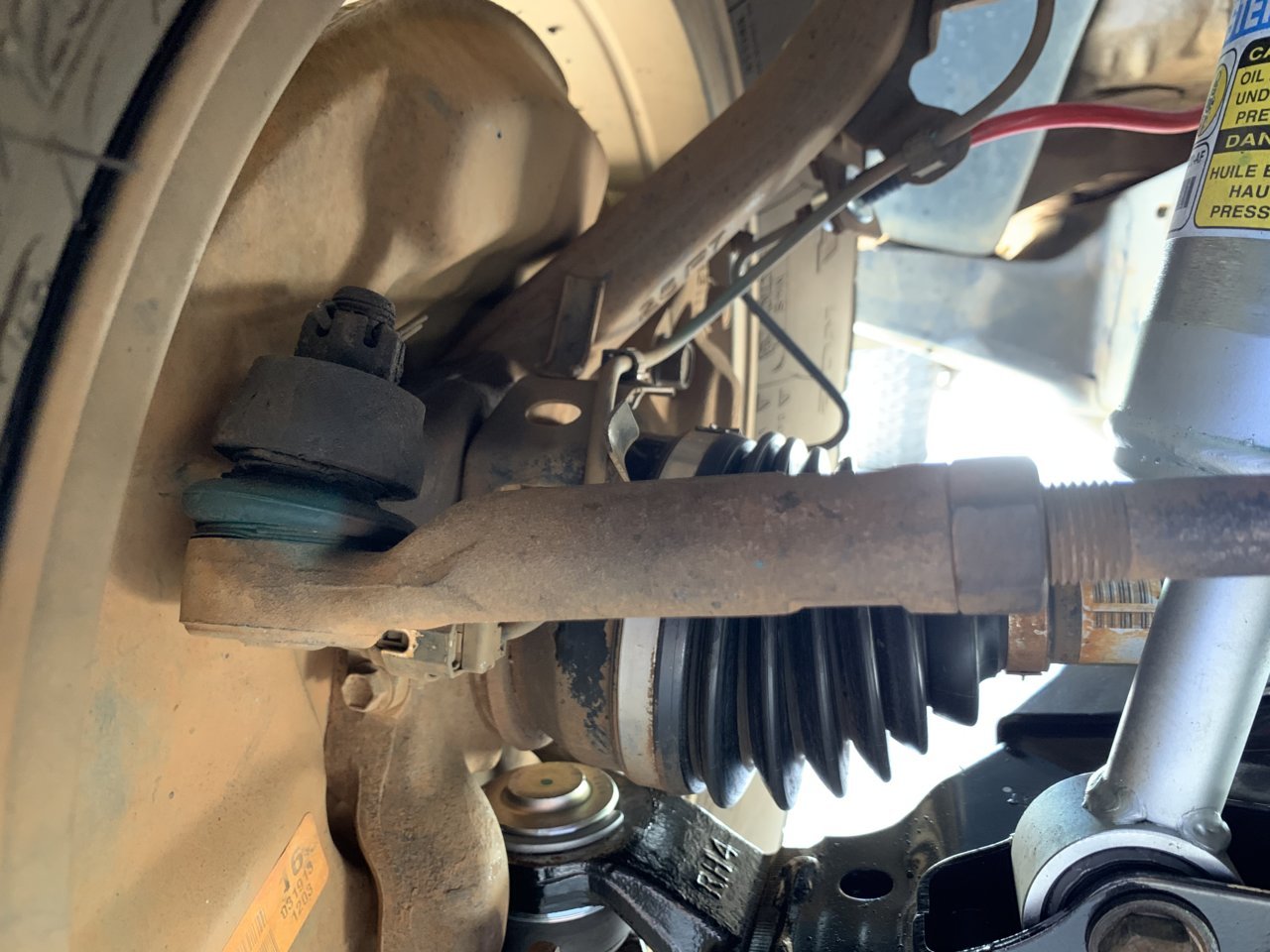

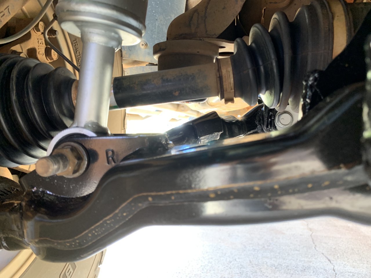

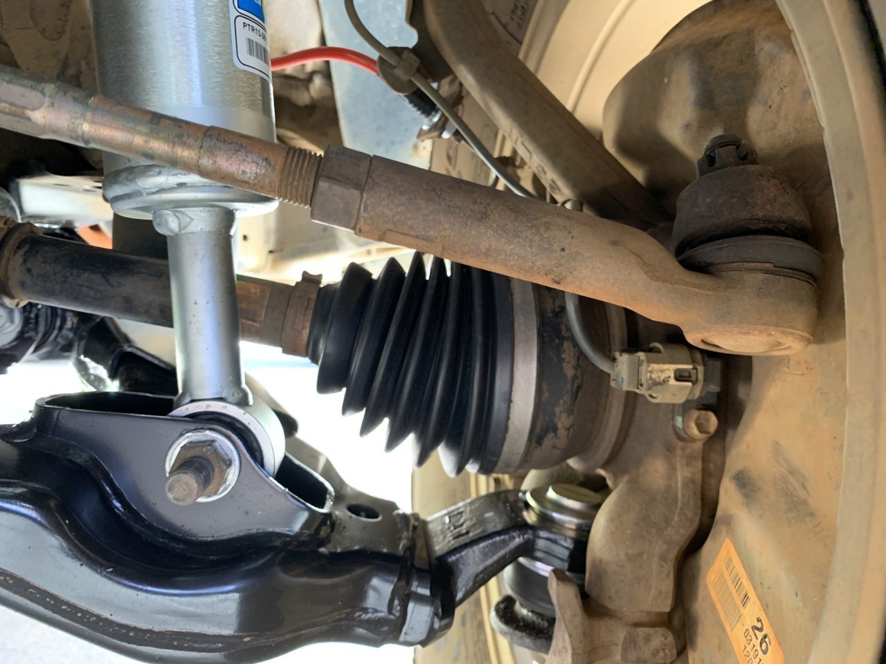

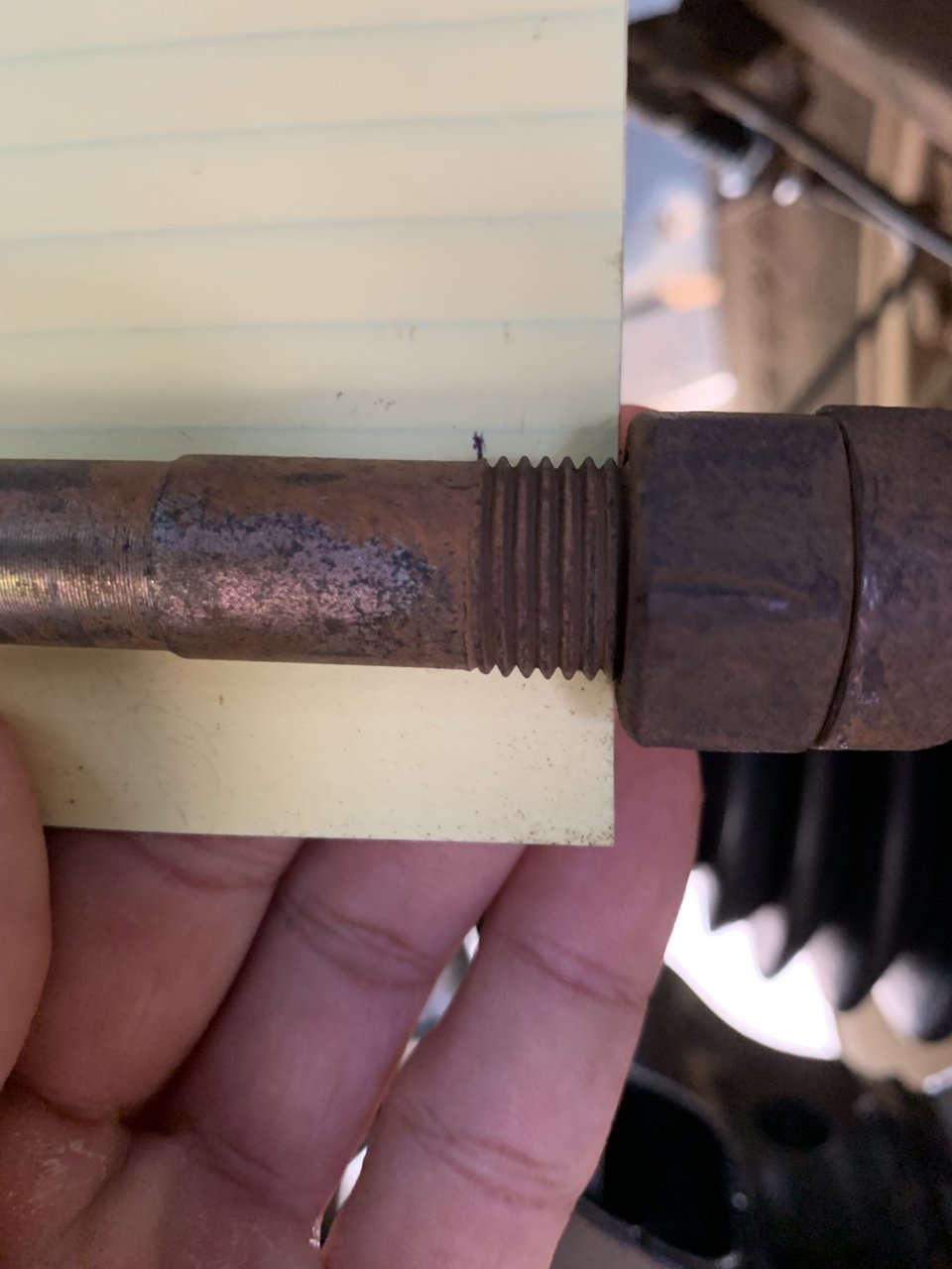

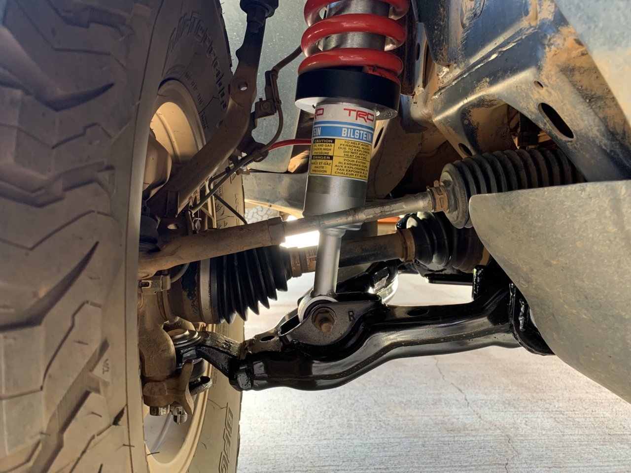

    It was pouring rain on my drive home so I couldn’t hear of any abnormal noises and avoided the shoulder of the road when I was allowed to. When I drove the truck again a couple days later, I noticed bump steer on the passenger side about 2 or 3 times when the front tire hit a dip in the road. It jerked the steering wheel for that split second but returned back to the starting position. I read through a lot of threads and started with the simplest method by reducing the tire pressure. The shop pumped it up to 35psi so I aired it down to 32psi. It actually did make a difference as expected for E-fuckin-rated tires. I ran that psi prior to my previous alignments. There’s still just very slight bump steer as I purposely drove over the same dips and then some after declaring a bit. Pot holes of course will have some effect to it. There’s lots of talk about tie rods and angles, the threads on them and having it even on both sides. Here are some pics of my angles and please let me know if my cv angles look bad lol. I read in a thread that to do a quick comparison on the thread length, mark on a piece of paper from the nut to the end of the threads. The pic angle on the driver’s side wasn’t dead on when I used the marking from the passenger side. Didn’t realize it til I got home.
    Passenger’s
    Driver’s
    So, how do my cv angles and tie rod angles/threads/ends look? Lol

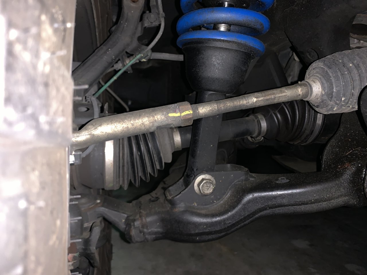

    CV’s look fine to me. Here are mine... 23 1/4” both sides hub to fender.
