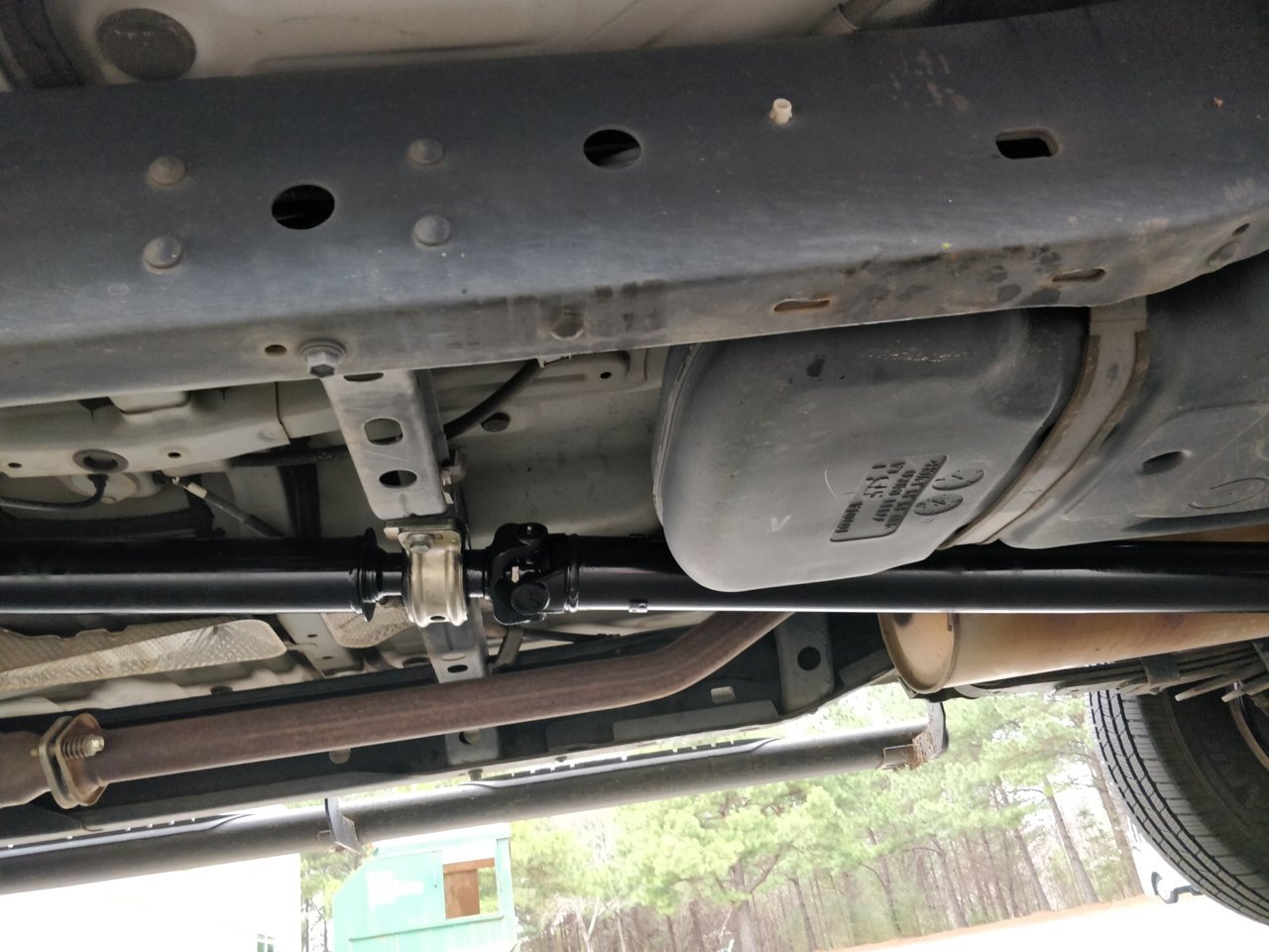

  19. Feb 26, 2019 at 4:09 PM
    #19
    jross20
    jross20 [OP] Well-Known Member
    Feb 19, 2018
    #244913
    2,028
    John
    Georgia
    2000 4Runner SR5 4x4 | V6 | Auto
    Tundra 5100s F+R, OME 880s+890s, duro bumps, etc
    Wow they even painted it!
    Larzzzz and 6 gearT444E like this.
