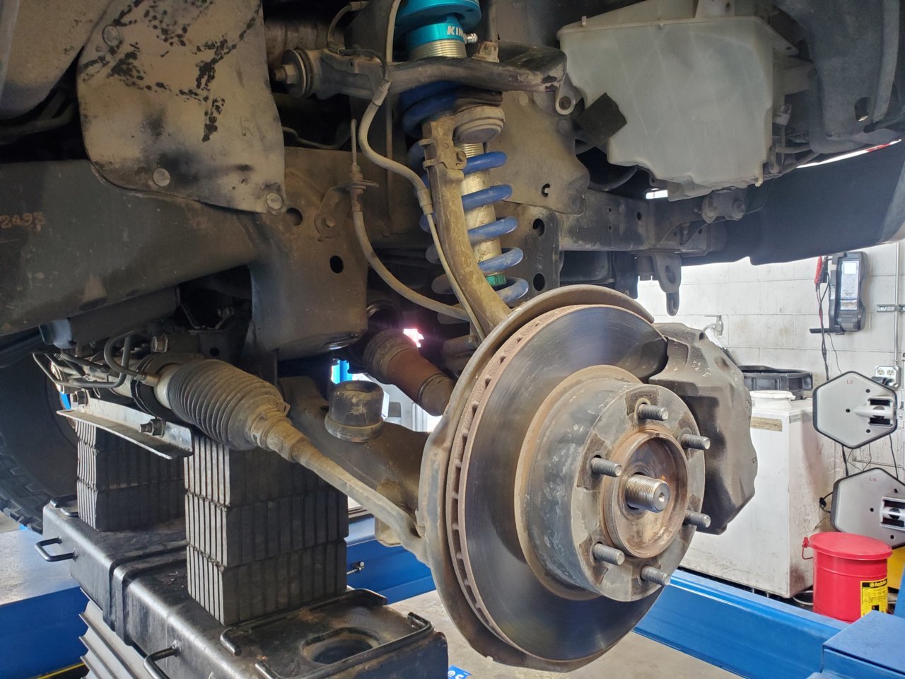

    What kind of lift do you have going on there? Is it like Jenga?

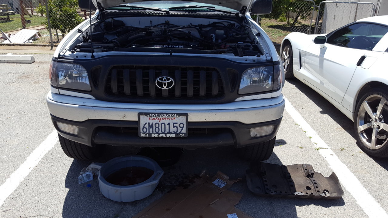

    When I used to be a Sales Manager and F&I Director, I'd use the lift at our dealership whenever I wanted.
    Weekends I'd bring extra clothes and worked on my rigs when I needed to; beat working on the ground outside in the elements.
    Here's when I used to work on shit at my old house in the parking lot where I'd do everything from suspension work, to maintenance, and everything in between. Even worked on my Corvette or Mustang 5.0 sometimes if I couldn't use one of the lifts.
