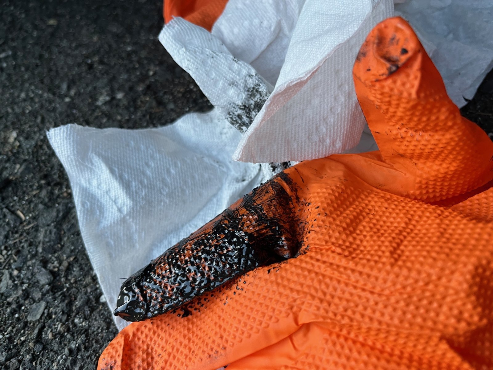

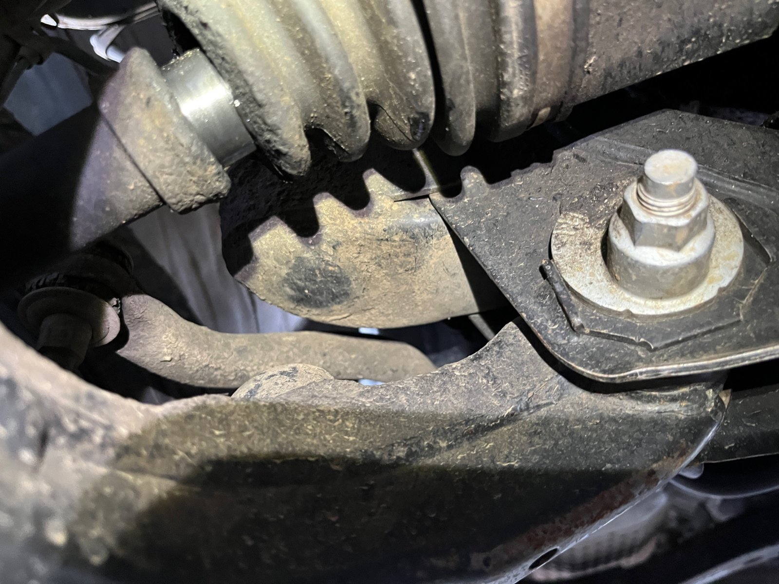

    Just purchased a tacoma with my son and we found that both inner CV boots are torn.
    I've read a few threads that state that you should keep the originals if you can. Mine are not making any noise and I can't feel any problems, but there was not much grease remaining in the boot (but there was some thin grease).
    I have attached a couple photos of the CV boot and the grease that I was able to feel/pull out with finger.
    Do you think that I can just reboot and regrease my current set or should I replace the CV joints altogether? It has 160K miles.
    I have watched a couple CV boot replacement YouTube videos and some mark the relationship of the bearing to the axle and others do not. Does this need to be done?
    Thanks in advance.

    If they don’t pop, reboot. I bought the kit off Amazon and they sent the wrong one and now in time sake am going to test Napa’s. So don’t order from Amazon. Yes you should mark the bearing and housing. Wouldn’t be the end of the world if you didn’t but it wears in a certain way. If you change the way it sits it’ll wear slightly differently/more

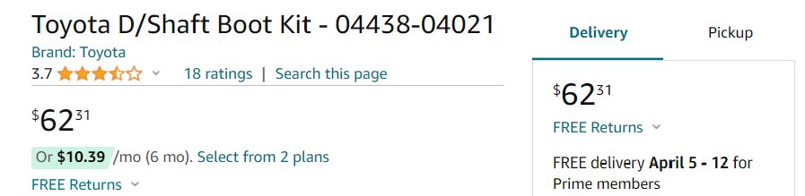

    Amazon has the correct kit in stock. If you're thinking about rebooting your OEM CVs, I'd grab 2 kits now before they are out of stock. Also suggest review this well detailed write-up on the job. https://adventuretaco.com/guide/how-to-rebooting-a-tacoma-cv-axle/
    https://www.amazon.com/dp/B00GKHJ2RO
    If you order from Amazon, make sure it is listed as Shipped and Sold by Amazon. If it's not, you're rolling the dice that it isn't legit. Also note, Amazon currently shows only 1 kit in stock. I'd keep checking back as their stock has been changing day to day.
    Another alternative would be to check with your favorite online toyota parts dealer. As I understood it (directly from Toyota Colorado Springs), the nationwide backorder on the CV reboot kits was expected to be fullfilled 1st or 2nd week of April.

    By pop, I mean when turning if you hear a popping noise they are bad. If not they are fine. Just replace the boot timely.

    I thought that as well until I placed an order a few weeks ago with Toyota (Colorado Springs). Received a nice email letting me know that it was on backorder and nobody had them in stock. The ETA was the first or second week of April. All in how quick you need the kit(s) I guess.

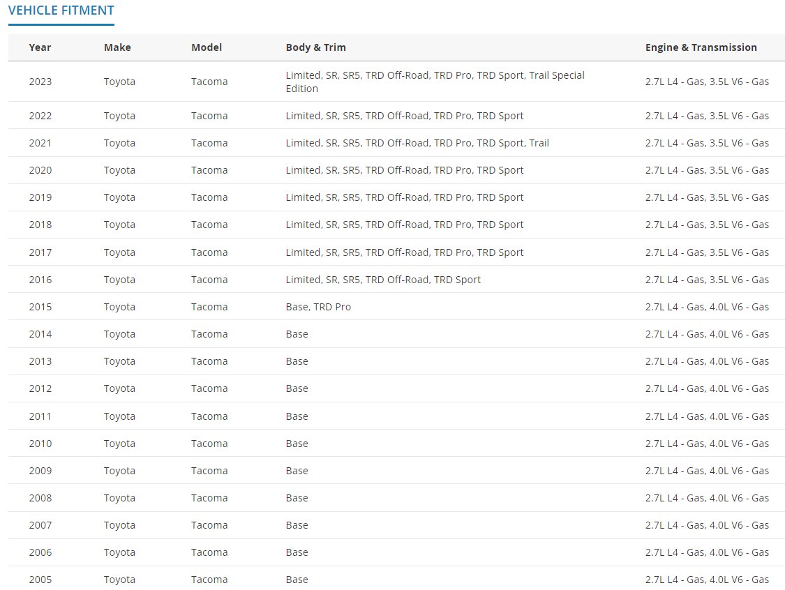

    Ouch, the part# you received is definitely the wrong kit. The correct part# for first gen is 04438-04021. This is why if I order any part from Amazon, it will only be something that is listed as SOLD and SHIPPED by Amazon.

    Exactly what happened to me. Axles are out the truck with the wrong replacement boots ugh. Going with Napa’s extended travel and see how they fair. Keeping the oem axles as spares
