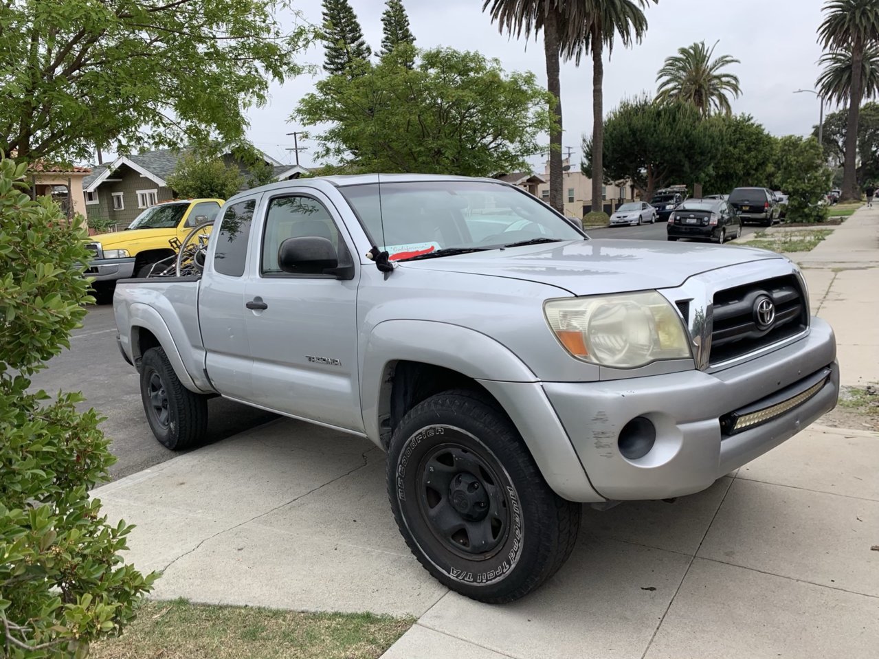

    Hey everyone! First time on here, just had a few questions as to what my next step should be with my 2008 taco l4 manual transmission.
    Picked it up just 2 years ago at 165,000 and started burning through its mileage. Finally hit the big 200 last November and it started misfiring and is burning tons of oil.
    So much so that I had to take it to a buddy of mine and pay a little extra to get it smogged (F*ck California)
    My boy is tough and is still moving around, trans is amazing.
    but I’m at a crossroad where I don’t know if I should rebuild the damn thing or swap it out with a crate or junkyard find. Any advice or opinions on the matter and what kind of service I should perform at this age in it’s life
