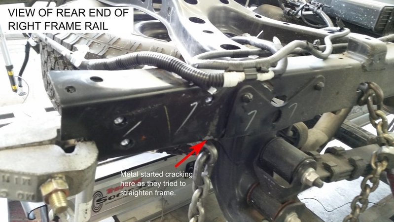

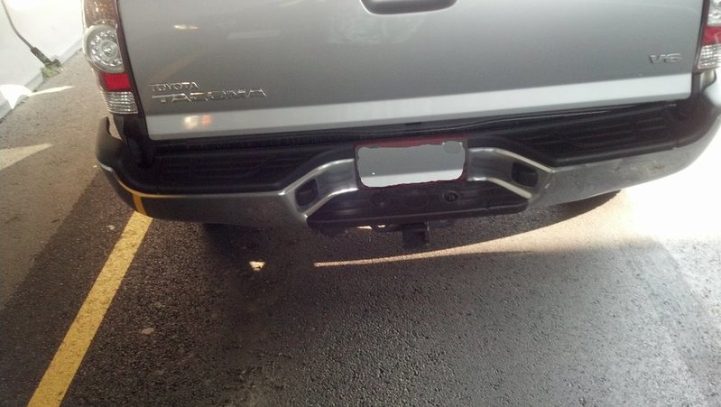

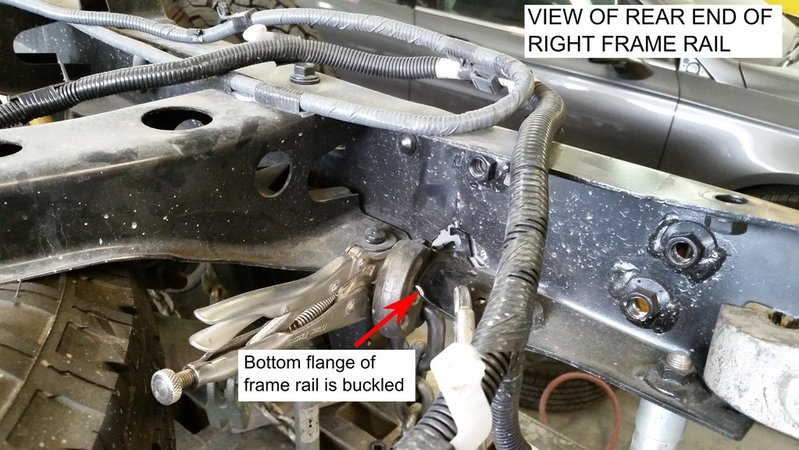

  14. May 7, 2015 at 8:58 PM
    aandse
    aandse [OP] Member
    May 6, 2015
    #154687
    6
    Tacoma 2014
    Here are pictures of the damage to the rear end of the right frame rail. Also included is a picture of the rear end of the truck after the accident. The bed of the truck escaped without a scratch (just a dent on the underside). The bumper, hitch, and frame took the blow.
    The body shop said the frame was true from the rear shackle (point of buckling) to the front end of the truck. The only frame twisting and damage was to the rear (aft) of the shackle.
    The front end sustained only minor damage to some crumple structure which can be easily replaced.

    does the bodyshop have access to alldata? its a program that list all oem procedures and how they want things repaired.
