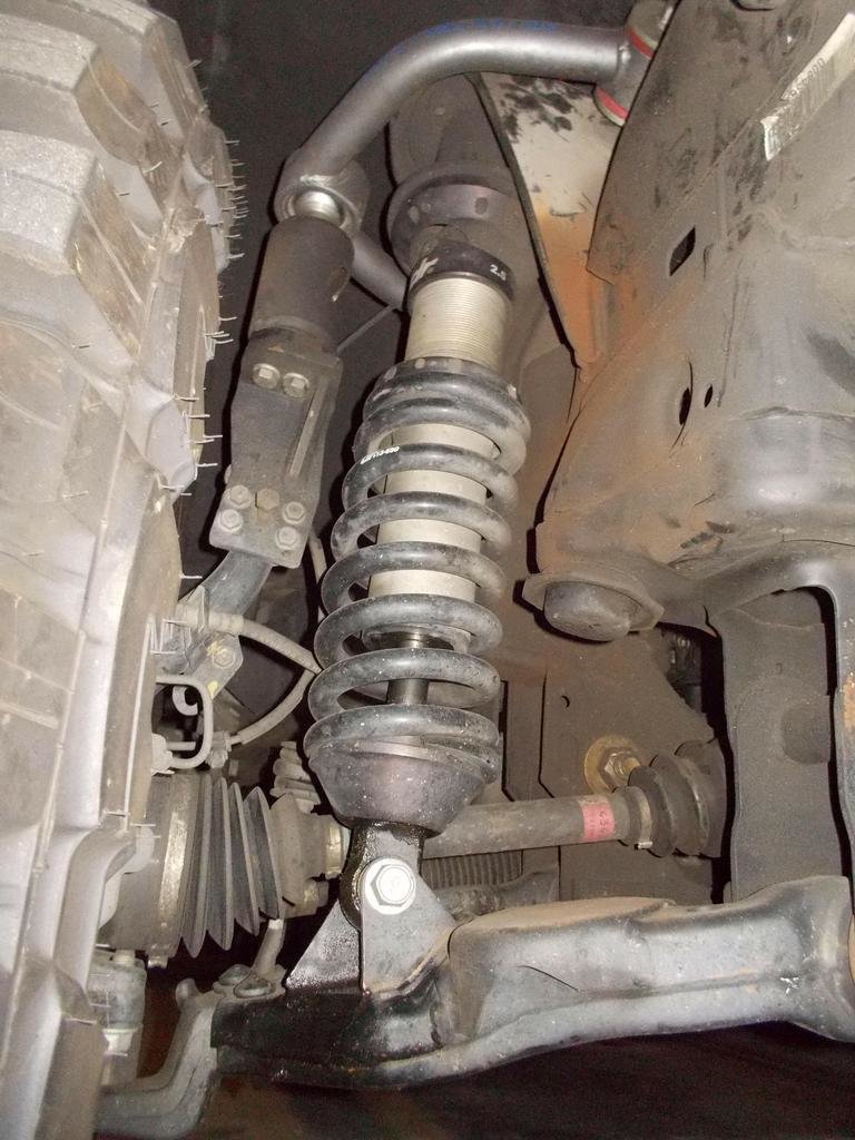

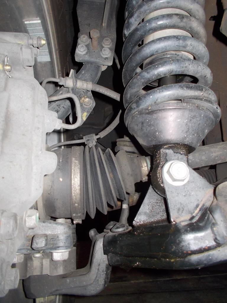

    Here are photos of the issues, beings DR has long since when out of business would sure like to figure out how not to spend another $1200 for a new set.

    Give Icon a call. I talked to them last week interested in rebuilding them myself. I spent about 1/2hr on the phone with them, they explained how to rebuild (there's also a few YouTube videos), different valving, and ordering parts.

    And now these so called great Donahoe Racing Coilovers are leaking oil. Kind of leaves me speechless on this high priced aftermarket stuff

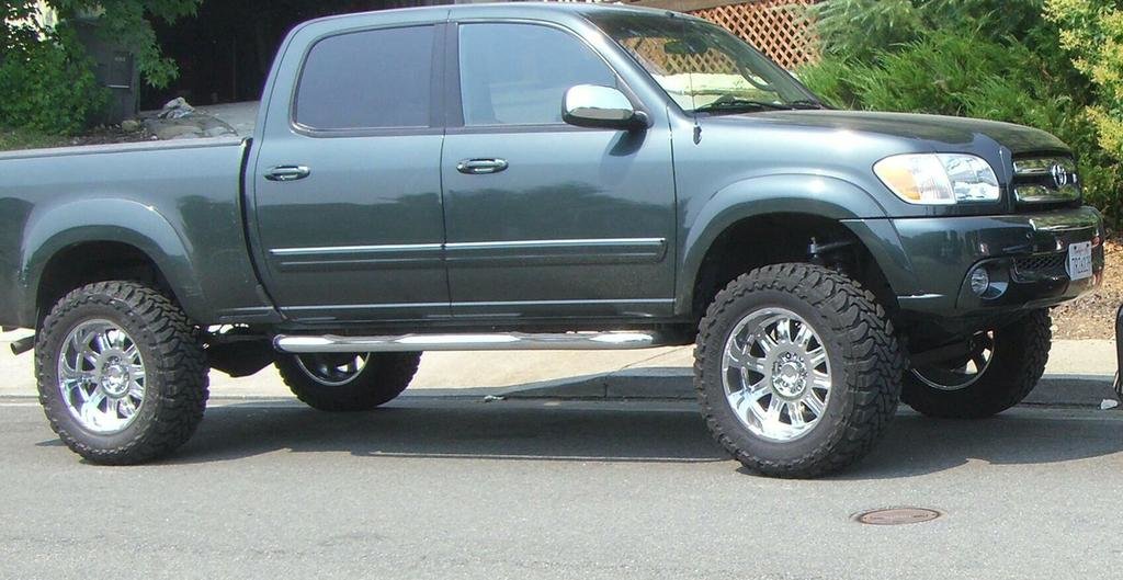

    Its just under 8" lift. Tuff country lift, with Donahoe racing coilovers and total chaos upper control arms 20" rims with 35" x 12.5" x 20" Toyo

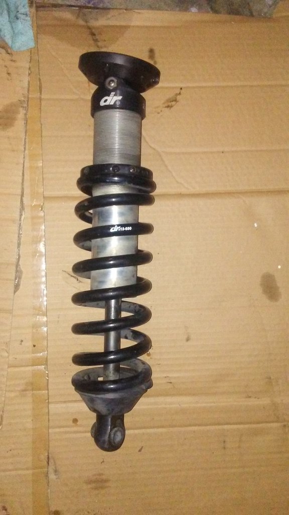

    Ok, well that wasn't that hard. There was some tension so it may be a little more difficult to put back on but not a whole lot once I disconnected the upper control arm.
    Now I need to decide of I should have both rebuilt. Anyone here have input? Only one was leaking. They have about 45k Freeway miles with some twisty roads, and very limited off road use.
    Not sure if it makes a heck of a lot of difference having one rebuilt and leaving the other alone but would love to hear what anyone has to say before I send the one off.
