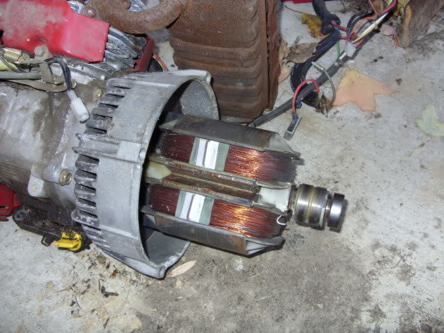

    Im Glad something worked. I got off the Rotor this morning. Thanks for the help!!! I am sure I will need more help. I will post more pics as it comes along. But my temp gauge repair didnt work. Followed the instructions exactly.

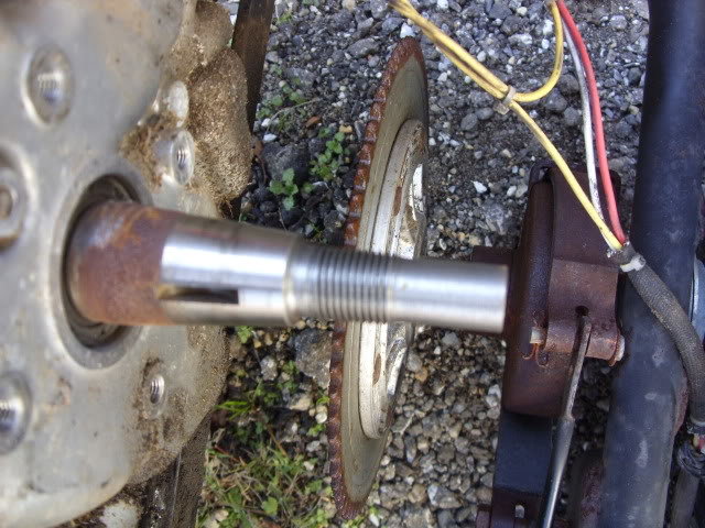

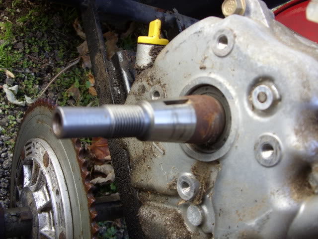

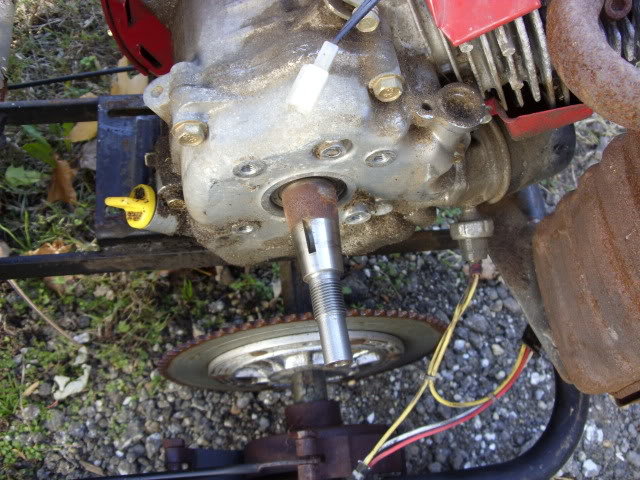

    Here are the pics with the rotor removed and it placed on the frame but not mounted

    Ok with the shaft being tapered there may not be much we can do with it for the go cart unfortunately. But there is a 6.5 HP motor on sale at Harbor Freight for $129 (not too shabby at all) which will fit my clutch and the mounts on the go cart. and my brother say this that he wanted to build. but he needs to buy a lot more before he can do that.
