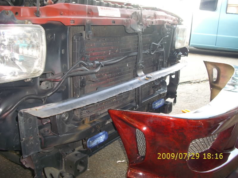

    Hickory, NC

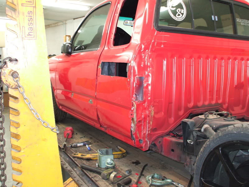

    Here are some pics of when I first got the truck. I traded the truck and the paint and body work for stereo equipment and labor, so all in all, I have around $1600.00 in the truck including paint and body work. Salvaged title.

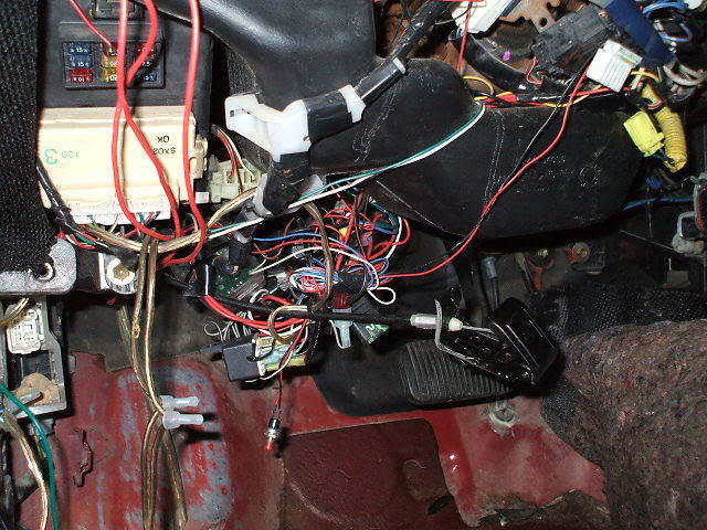

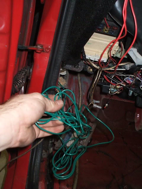

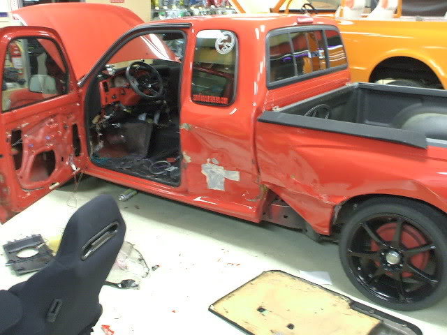

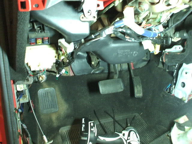

    My security/rs install:
    Start of body work at R&R Paint and Body:

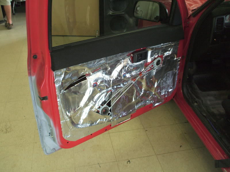

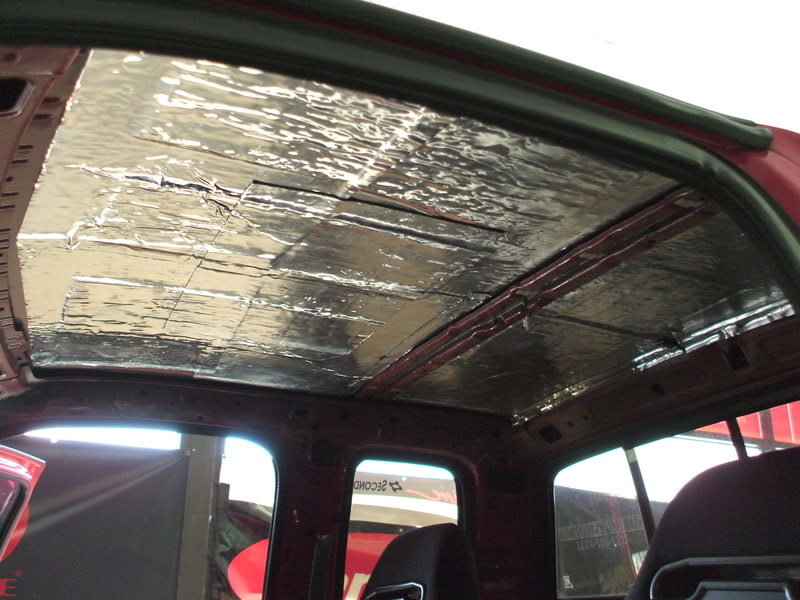

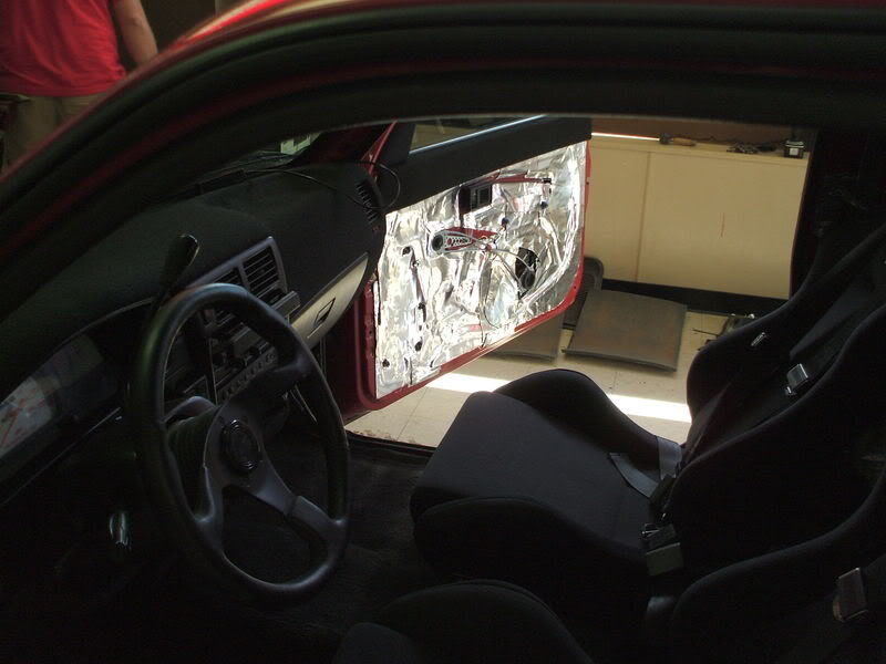

    Beginning stages of Second Skin Damplifier Pro:
    I also installed the Spal Deluxe power window kit:

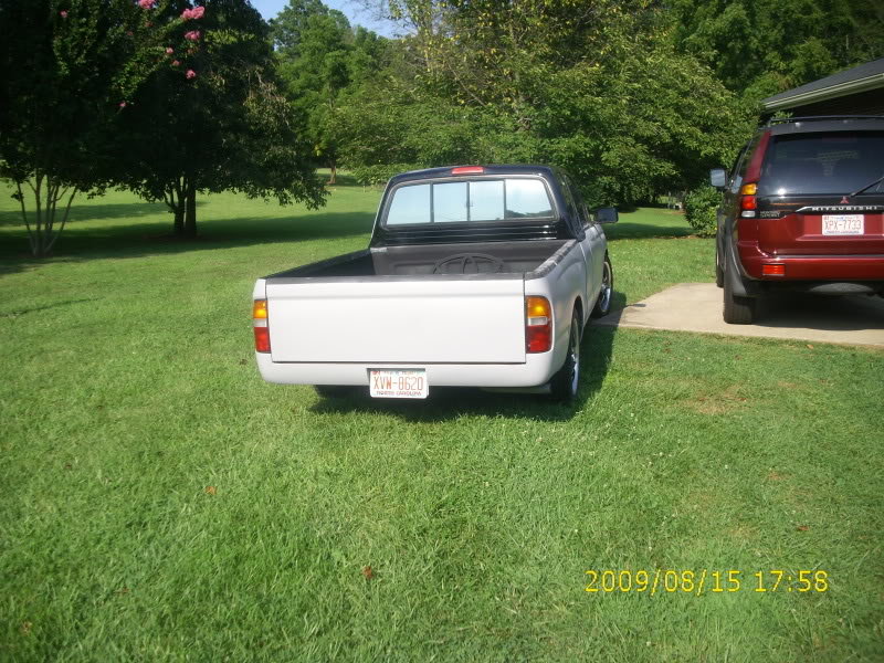

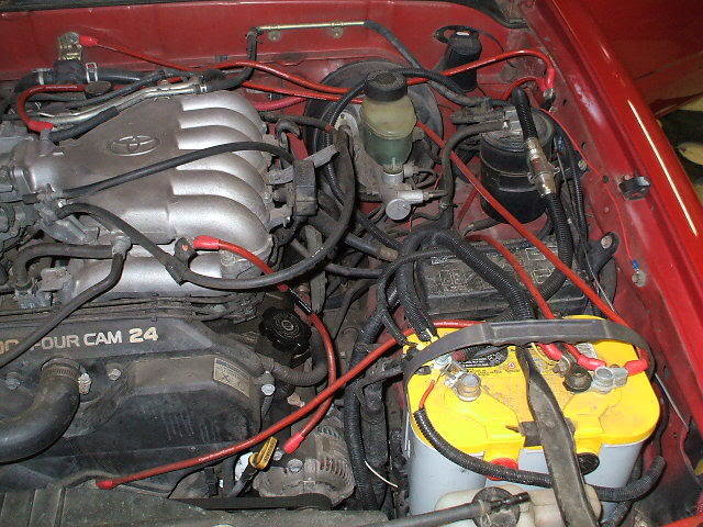

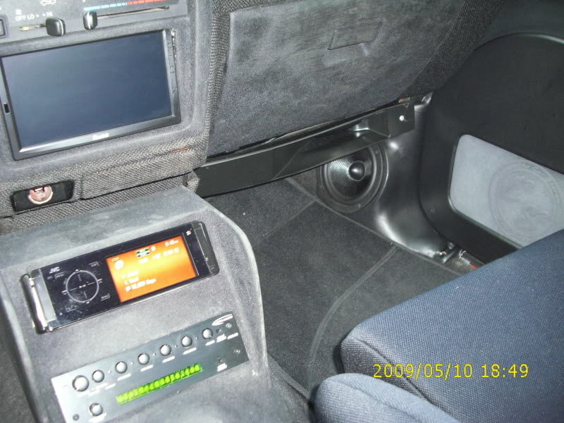

    Now, I didnt take enough pics of the Second Skin installation or the cable routing. Its all getting done over, so I WILL post it as I go this time. Here it is as it sits now. The bs black wheels were traded for factory 2006 Mazda 6 wheels. Fit with no issues. Wanted a taller tire wall for some better riding comfort.

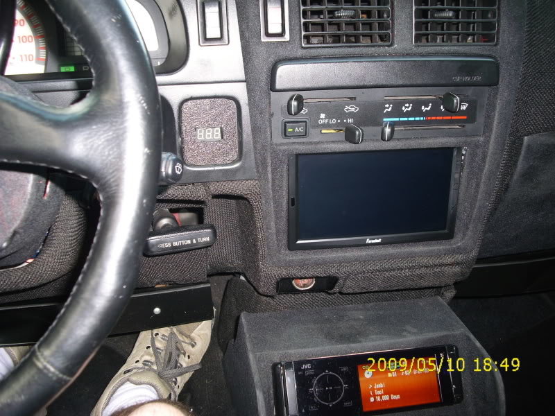

    Now, as you can see with the horn and mid installation, there are flaws. This was my first horn install. Jason Winslow and Joey Cloninger both took a listen and pointed out what I needed to do in order to get much better sound. The good news is that it sounds pretty much identical from either the driver or passenger seat and is centered very well. But there are gaps between the top of the horns and the bottom of the dash, so that will be addressed. The horns are NOT parallel with the floor, so that will be fixed. I am also going to move the CX's to the doors and return the kicks to factory.

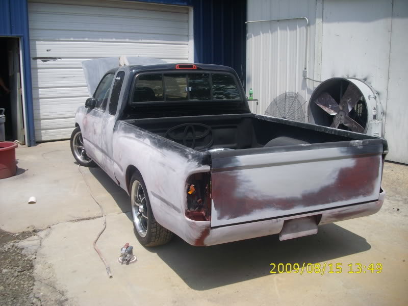

    You can see from this pic the beginning of the rusty scab that had to be repaired. It was pretty horrible. Whoever welded the tailgate handle left holes in the welds, so water came through the back side and started rusting the metal from under the paint. I think its licked now though. lol.

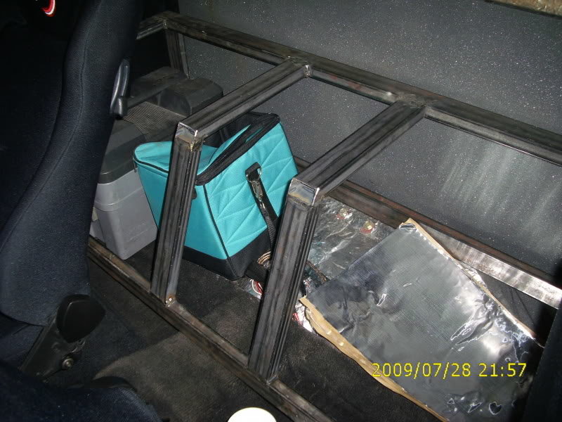

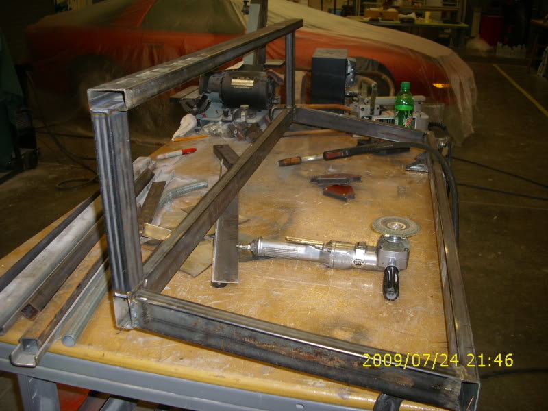

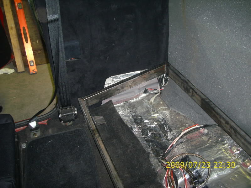

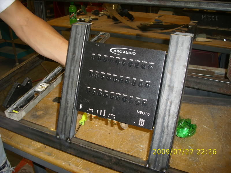

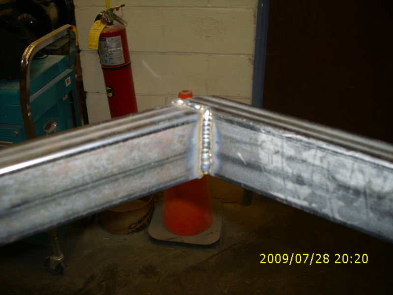

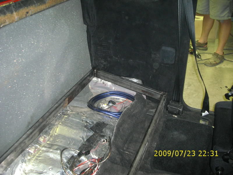

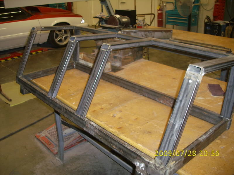

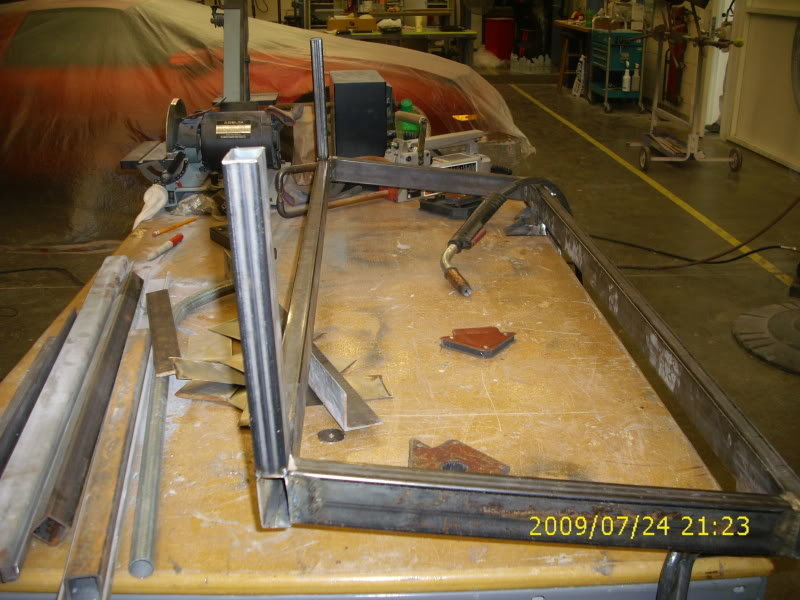

    Here is the amp rack I am currently still working on. You can see the 2 factory bolts in the rear floor of the truck. I have to weld a bracket up for that, and the other 2 points near the seat belts will just go through the floor. Should be secure with the 2"x1" square stock?

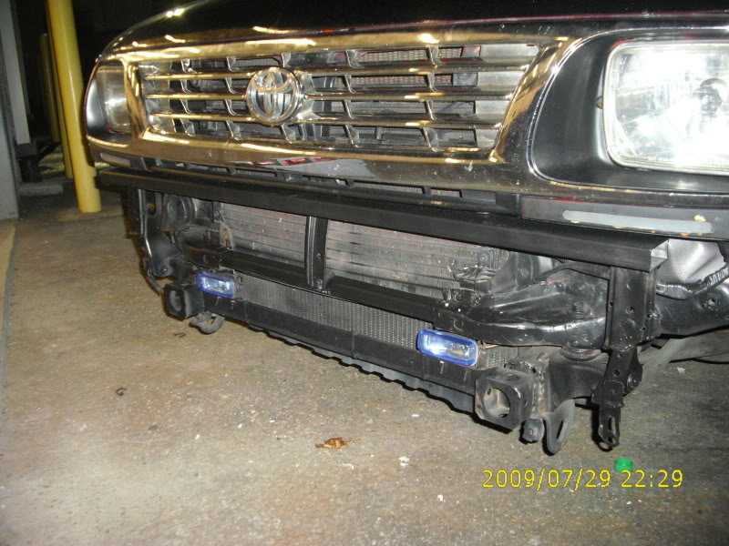

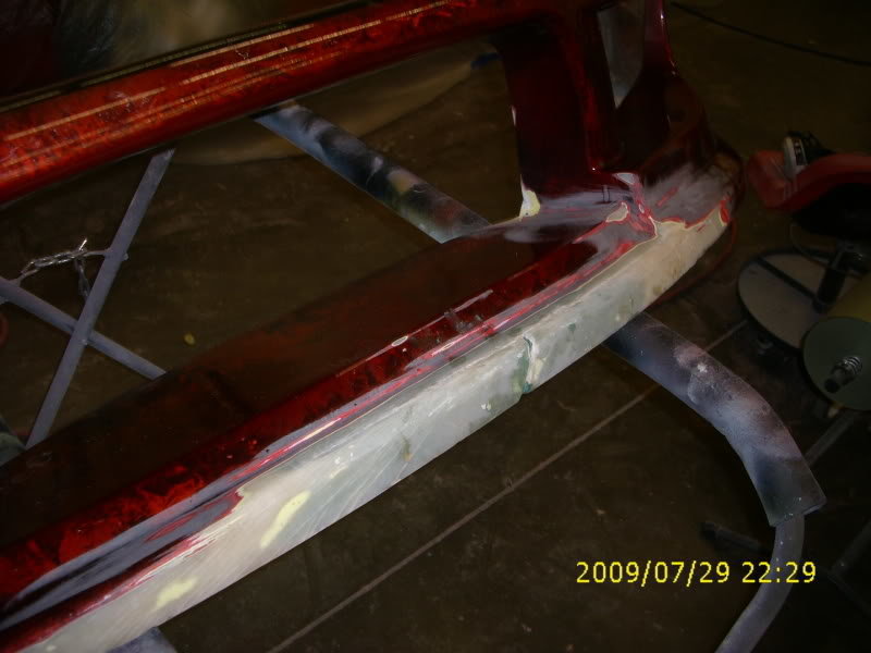

    This was the old bumper "reinforcement". Whoever cut it was trying to make a lumberjack saw I think. Anyway.....SCRAP!!
    I used some of the square stock to make it a little better. It makes a huge improvement to stiffen the crappy fiberglass bumper.
    Bumper is cracked all to hell...........hopefully it will be awhile before I have to do this again. LOL

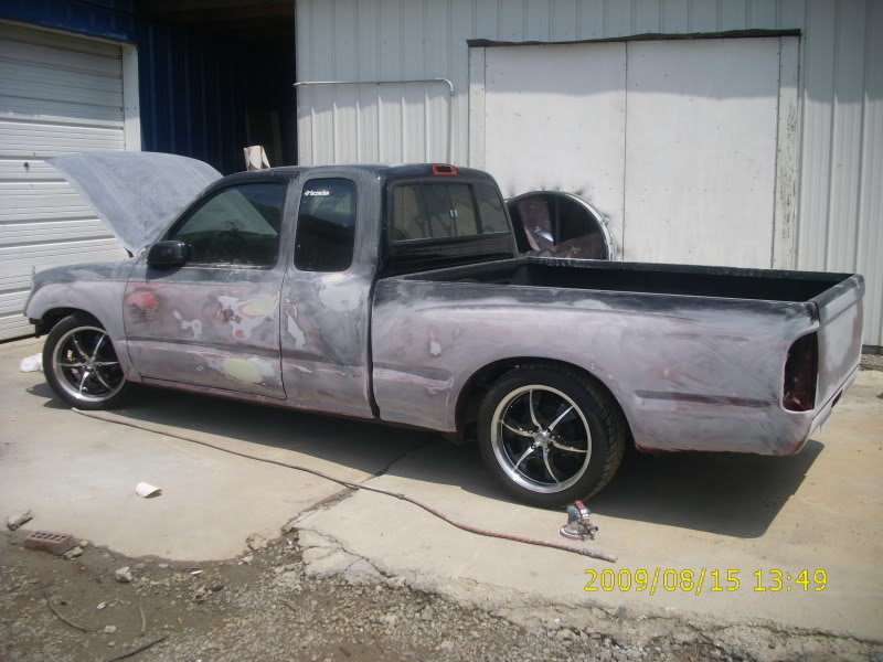

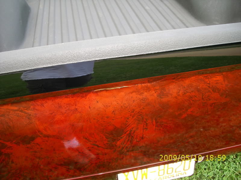

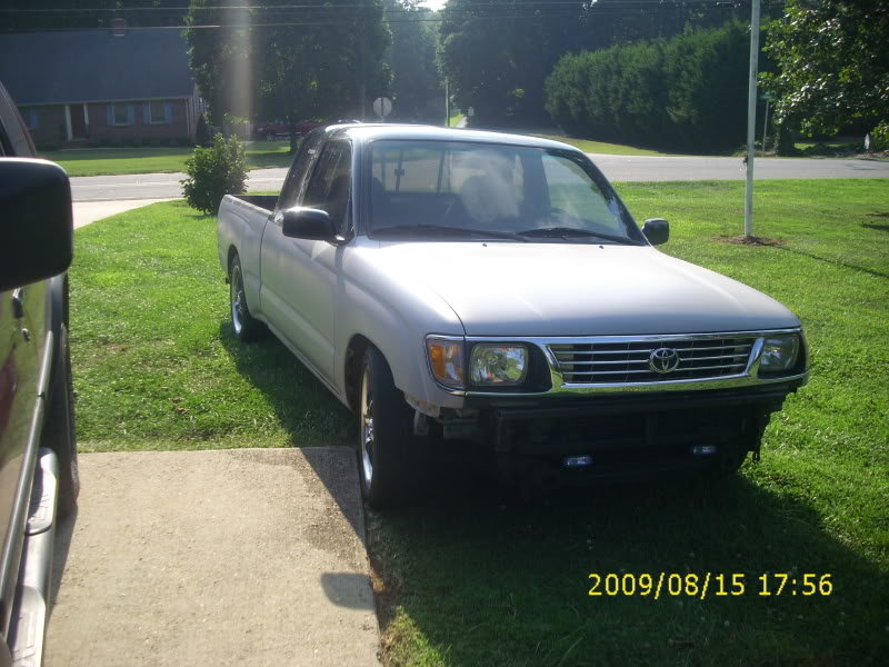

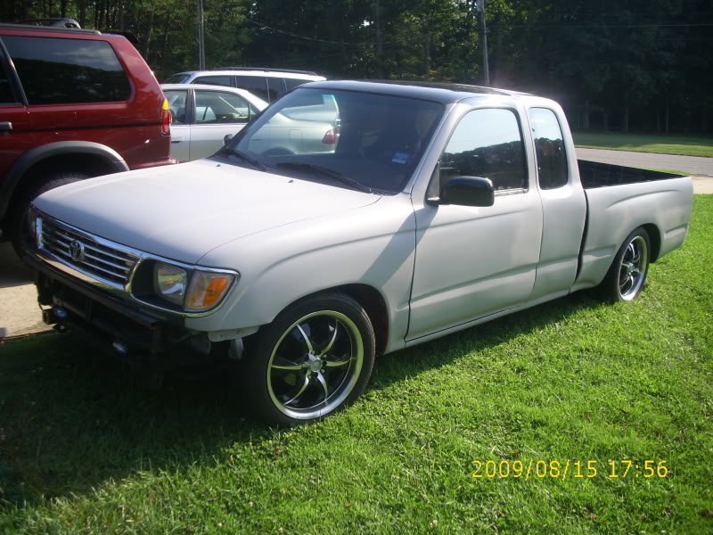

    Sanding "marble" SUCKS!! Tired of sanding....it will be another week before I do anything else. lol
    Oh yeah, got the new wheels as well.LOL. Traded for an old LED scrolling sign I had at my old store. :D
