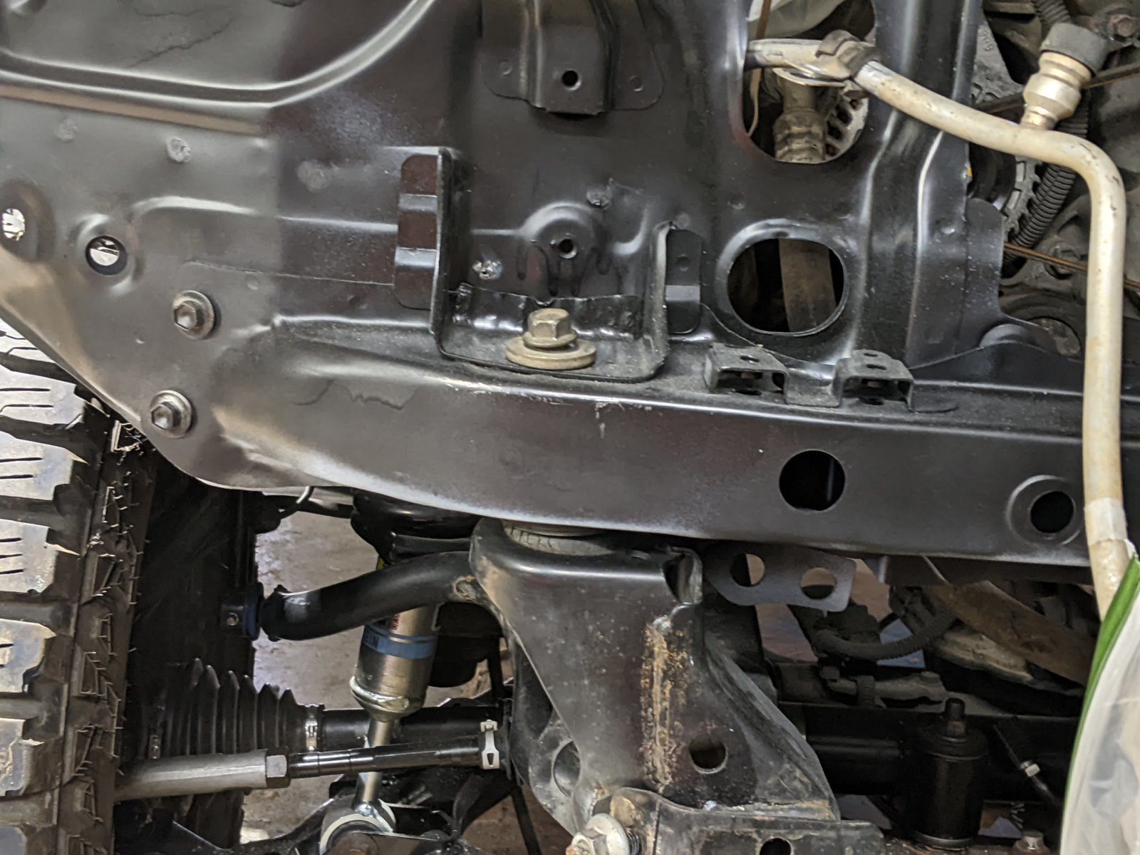

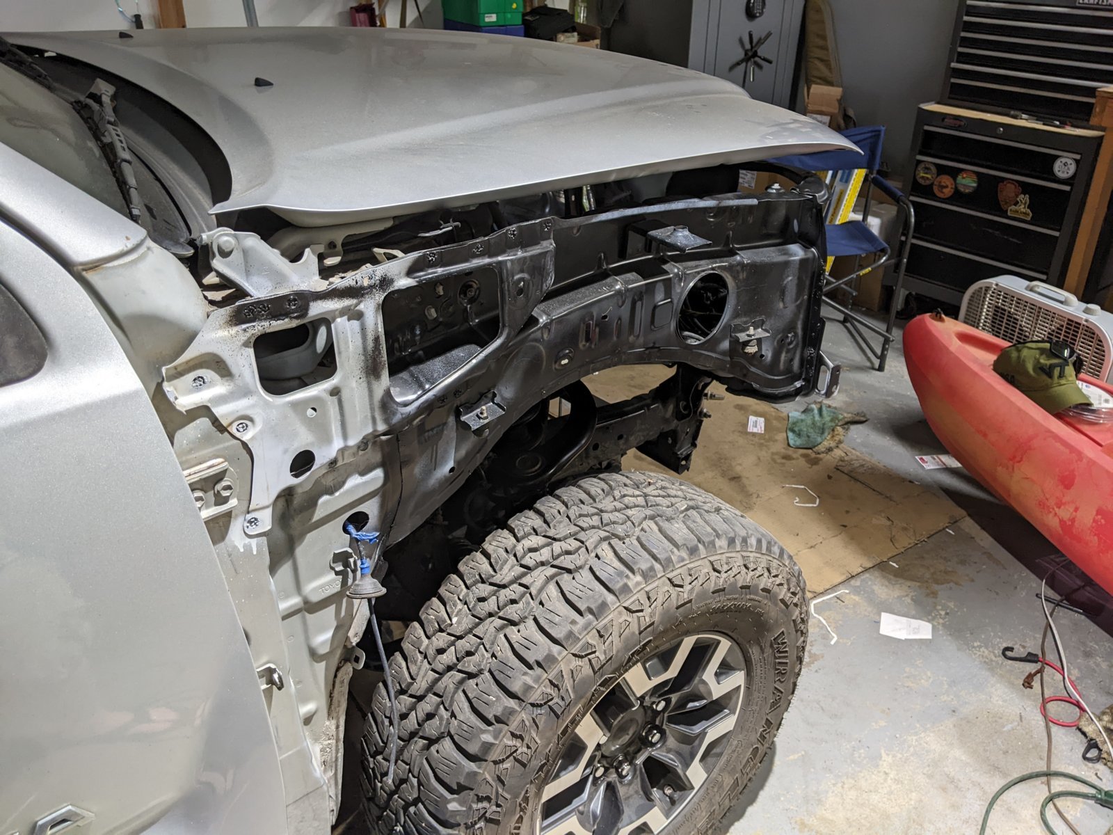

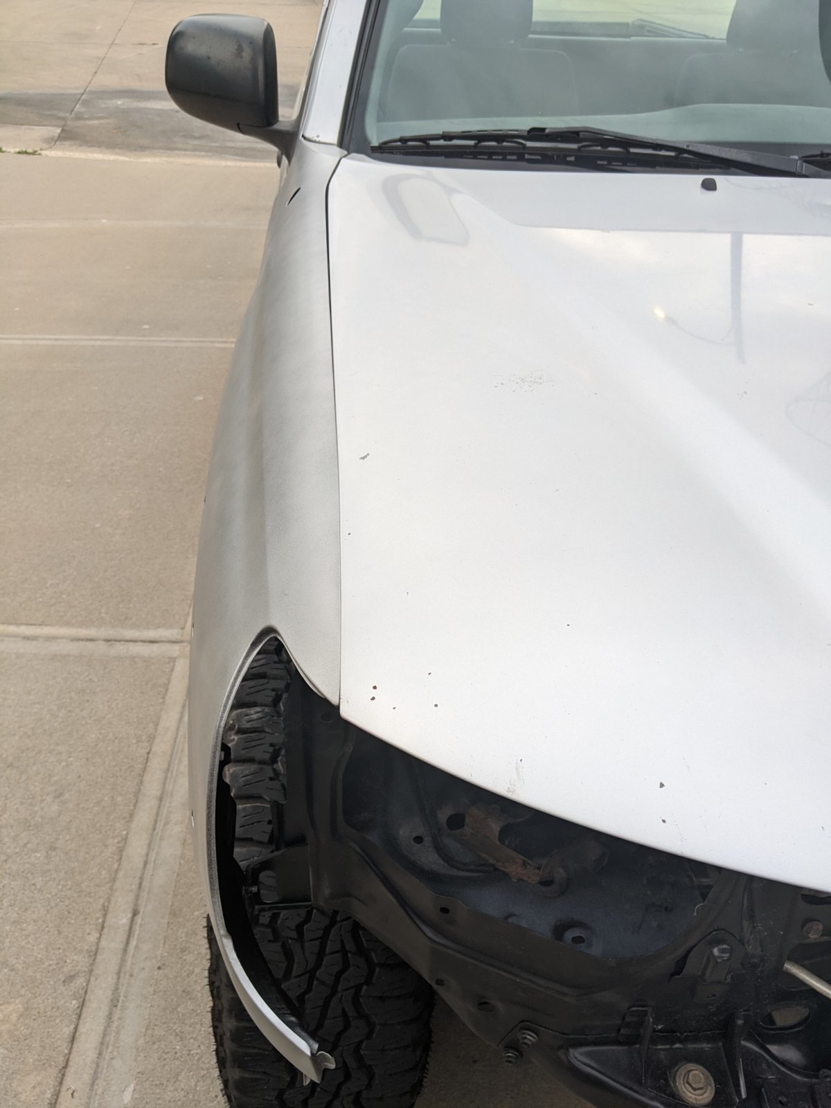

  7. Apr 20, 2024 at 8:14 PM
    #47
    kidthatsirish
    kidthatsirish [OP] Well-Known Member
    Jan 29, 2008
    #4485
    1,202
    2006 Tacoma Access Cab, 2.7L, 4x4, Manual Transmission
    President McKinley w/KLM 203P and threw the roof antenna, ICON RXT leaf spring packs (position 2), Bilsteen 5100s, ARE Camper Shell, Pop & Lock tail gate, Dash Cam

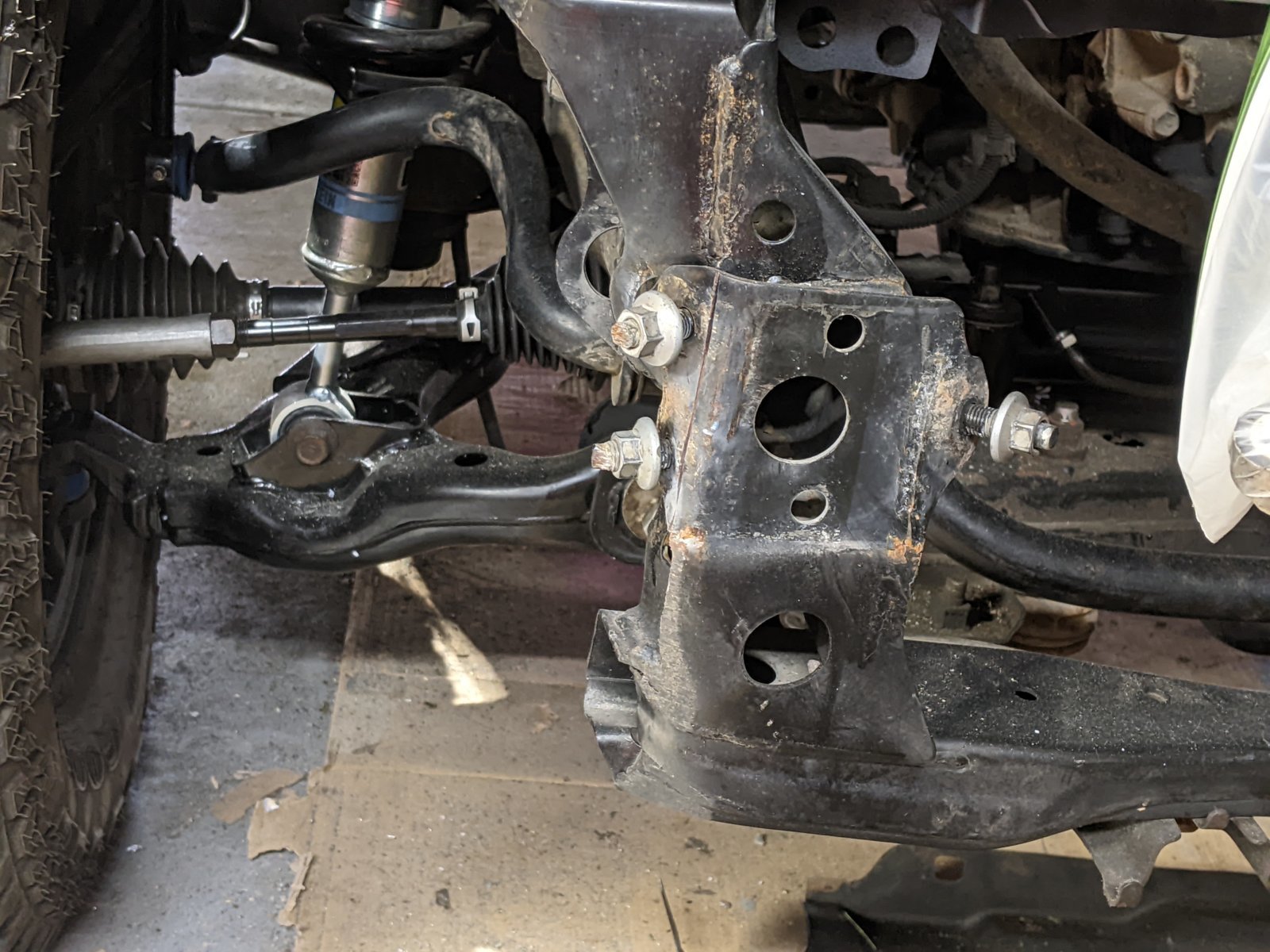

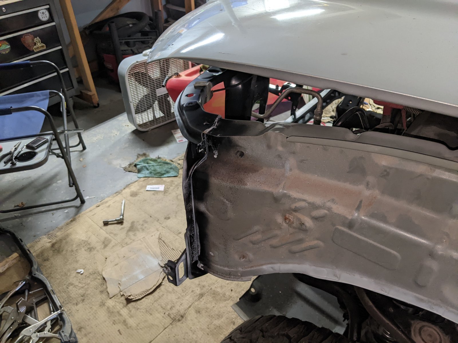

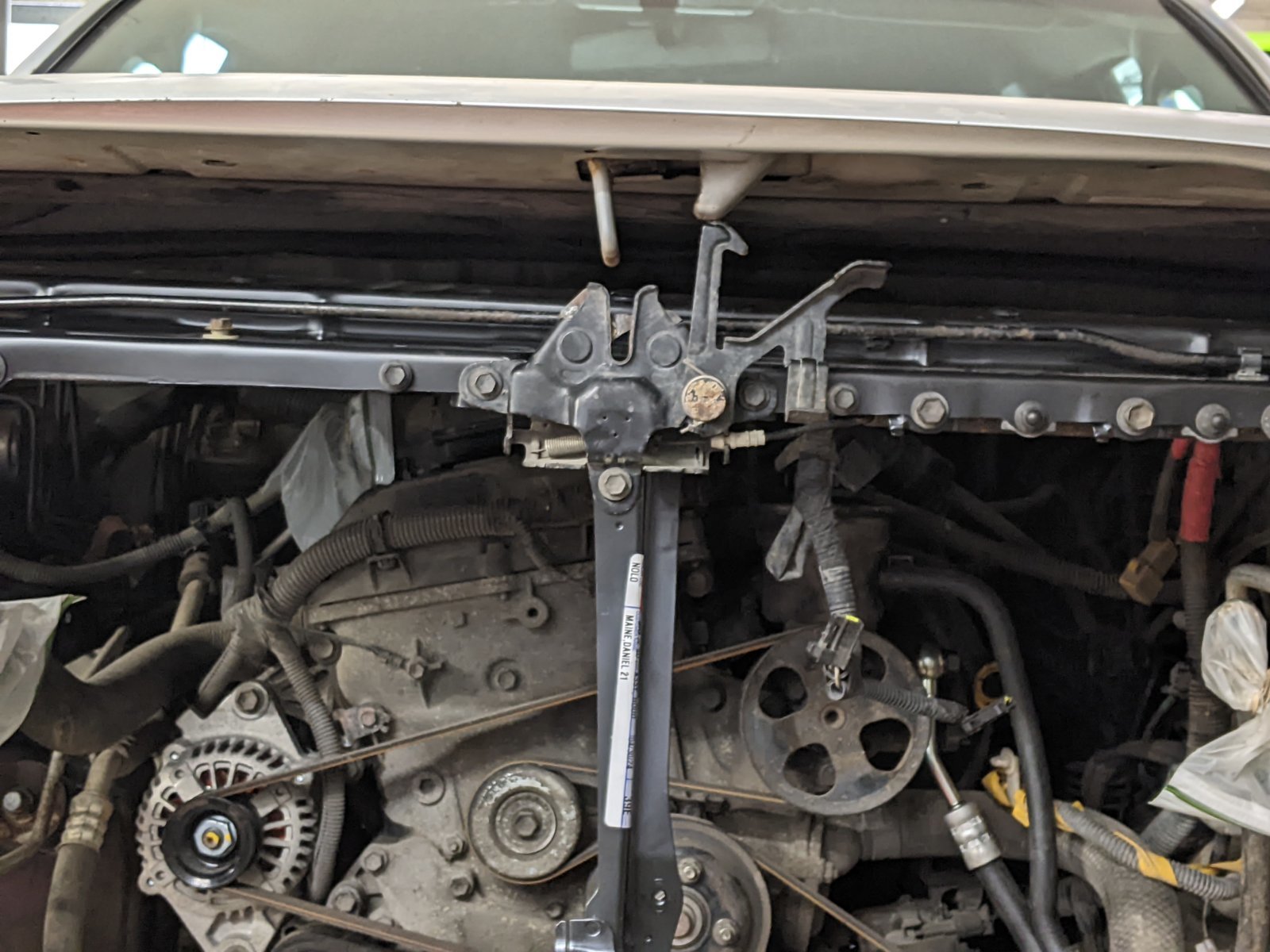

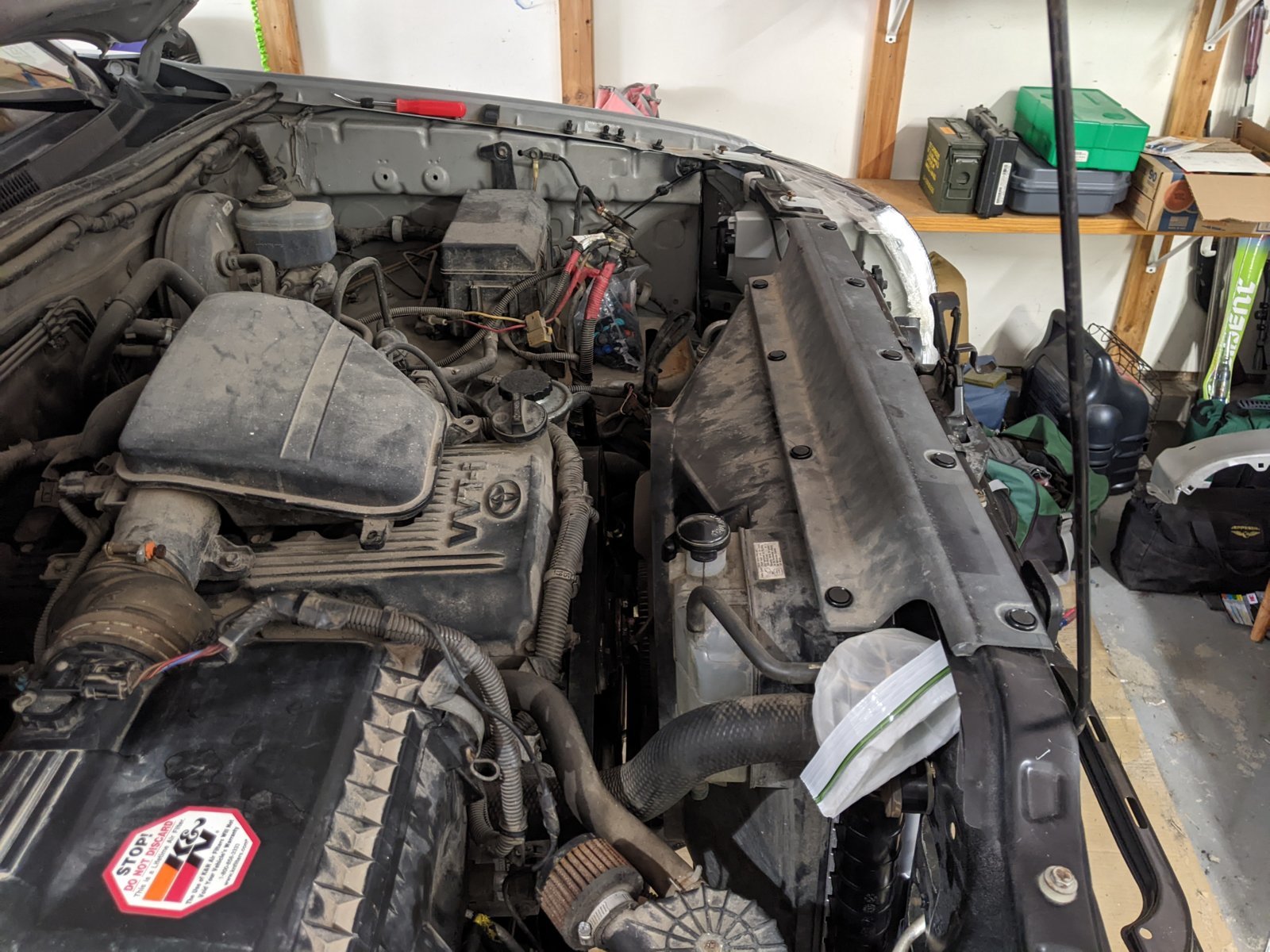

    PXL_20240420_213241093.jpg PXL_20240420_221006430.jpg So I figured I'd do some more documentation of the rebuild as I go along....1) Sonic people have questions they can ask. 2) So I can ask questions from others. 3) Because I'm learning a lot and sharing my experiences.
    RGJ and E3g like this.
  8. Apr 21, 2024 at 5:27 PM
    #48
    kidthatsirish
    Jan 29, 2008
    #4485
    1,202
    Had to move the kayak out of the way from the ceiling to open the hood higher. It was much easier, for whatever reason, to get the apron and fender rail out... likely because I had a bit more practice at that point.
    My primer and paint will arrive this week. I'm going to go splurge on a handful of harbor freight clamps this week.:rofl:PXL_20240421_230332075.jpg
    RGJ likes this.

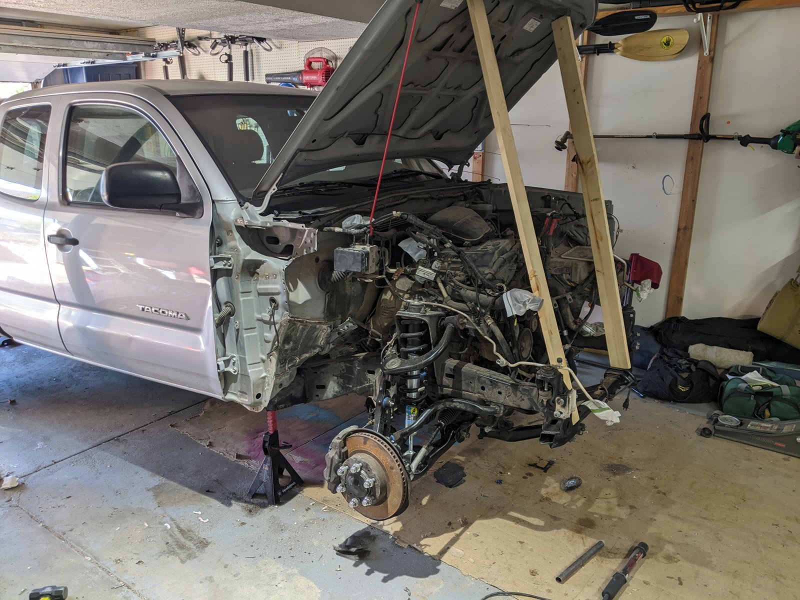

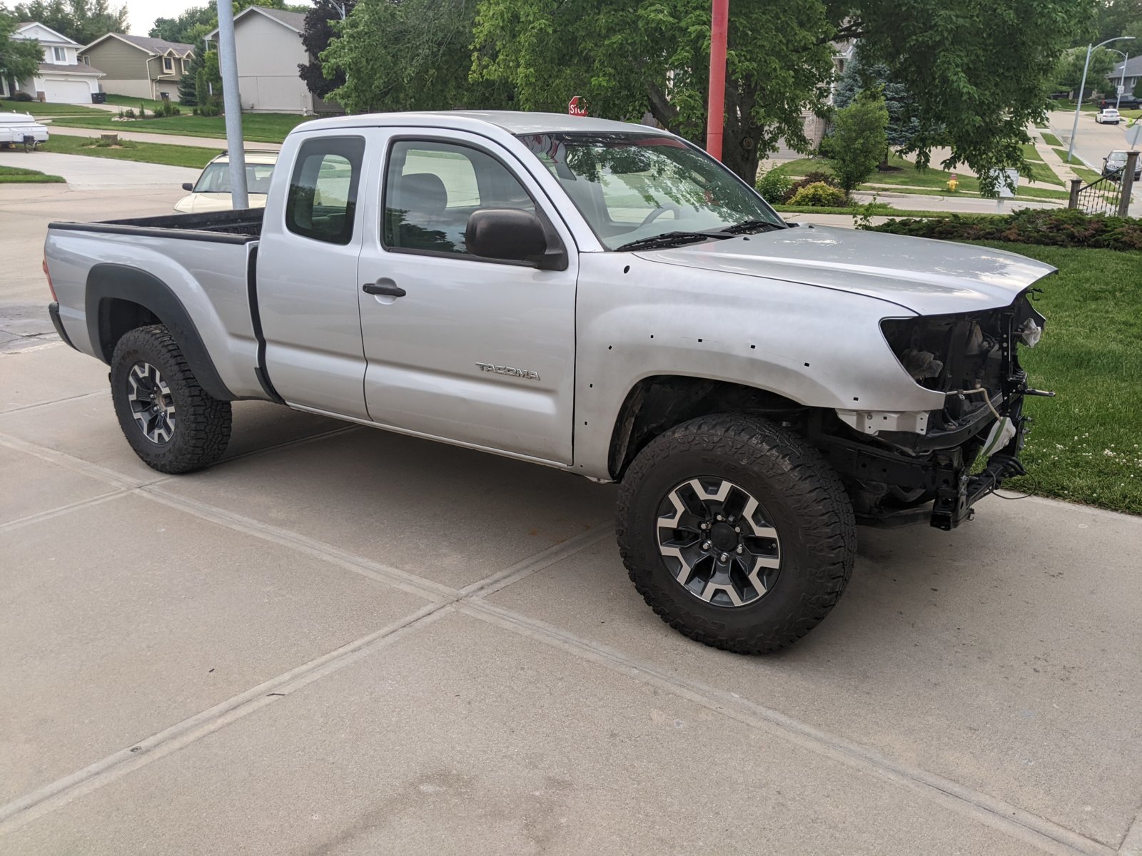

    Well....after replacing 75% of the front end suspension and steering components. I have finally received and welded on new "inner sheet metal.
    Different color, but I don't really care or intend to paint it as nobody is going to really see that stuff anyway.
    It's been an interesting ride so far. Used a harbor freight titanium 140 welder for the job. Turns out learning to weld thin sheet metal is incredibly difficult. But then again what else was it supposed to do.
    Used flux core 0.030 wire on the lowest settings possible. Basically did a crap ton of small little tack welds to fill in the plugs from when I drilled out the old metal.
    After doing so you can still see that my hood and engine compartment don't line up exactly. This will be the one of two times I intend to use another shop to help me out. I'll have them give a tug in the corner of that frame to straighten out the mounting plates and to help line up the hood and engine bay box. Once that is done it should be pretty much bolt on after that with a new radiator, new ac condenser (although my old one held pressure fine) and headlights, grill, etc.

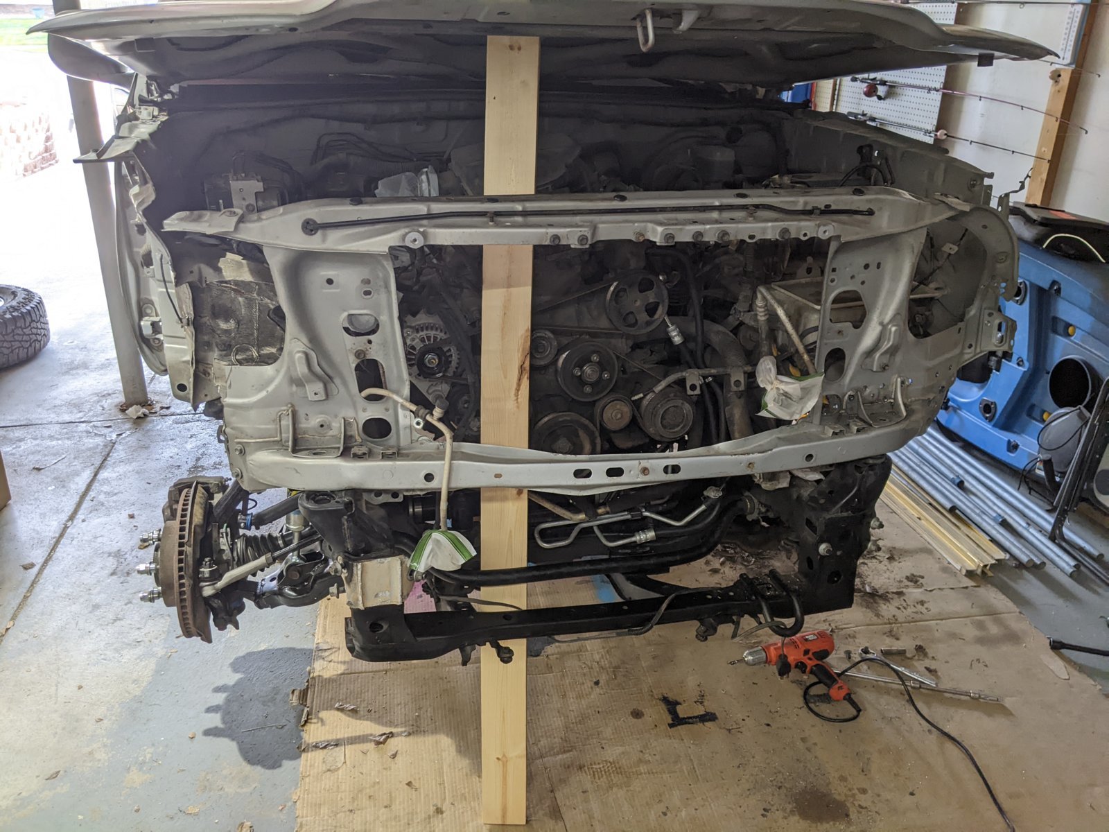

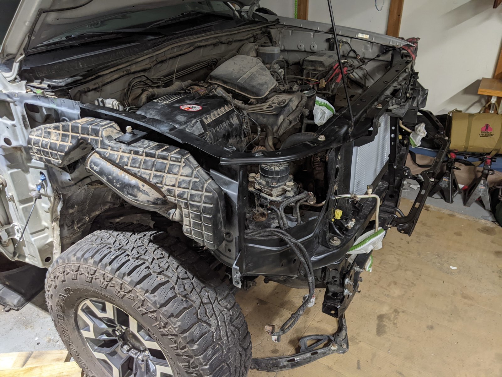

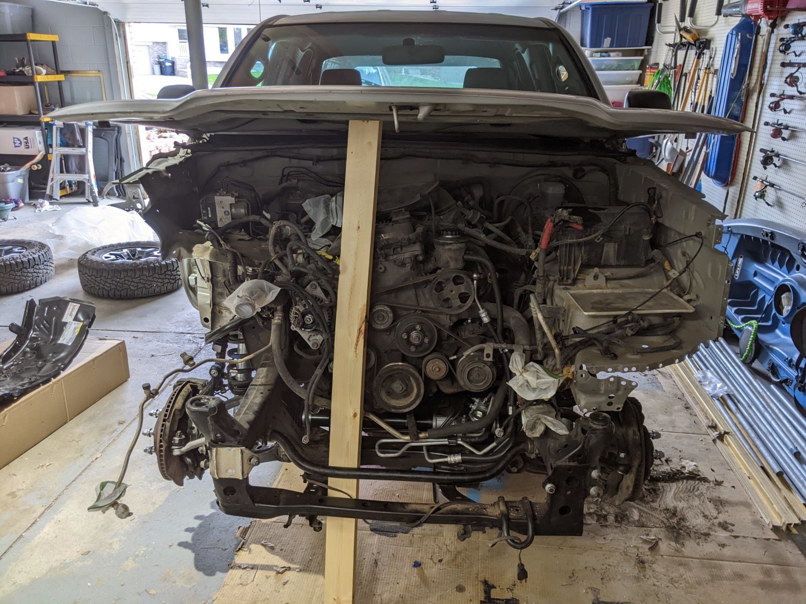

  12. Jun 18, 2024 at 4:37 AM
    #52
    kidthatsirish
    Jan 29, 2008
    #4485
    1,202

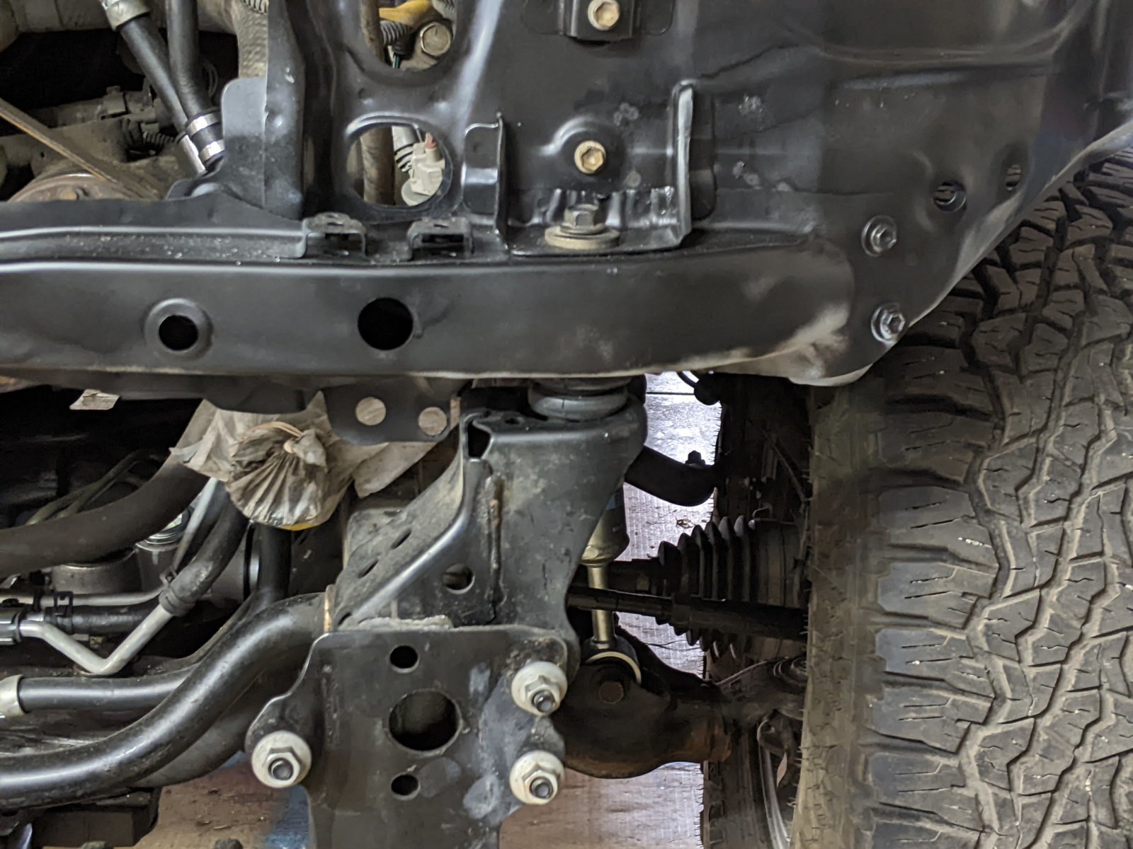

    PXL_20240618_005332139.jpg PXL_20240618_005136486.jpg PXL_20240618_005131010.jpg
    More updates to follow.

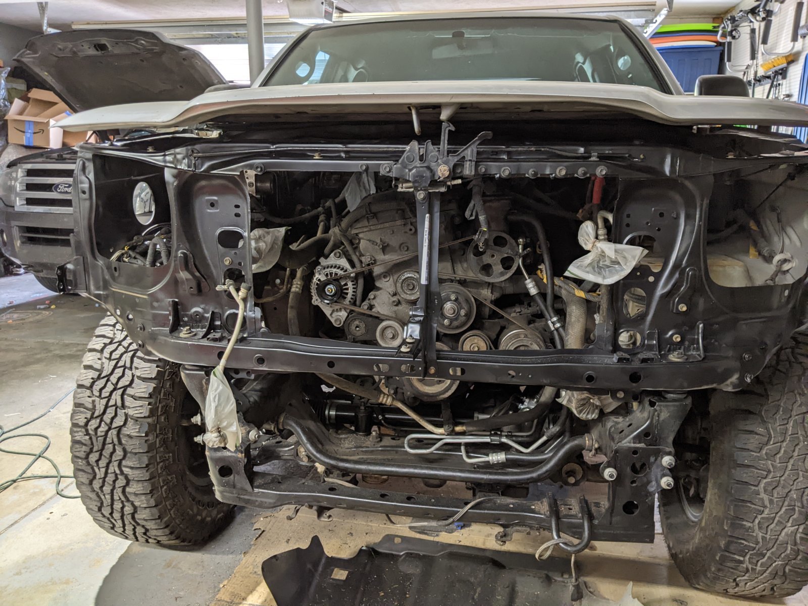

  14. Jun 18, 2024 at 2:37 PM
    #54
    kidthatsirish
    Jan 29, 2008
    #4485
    1,202

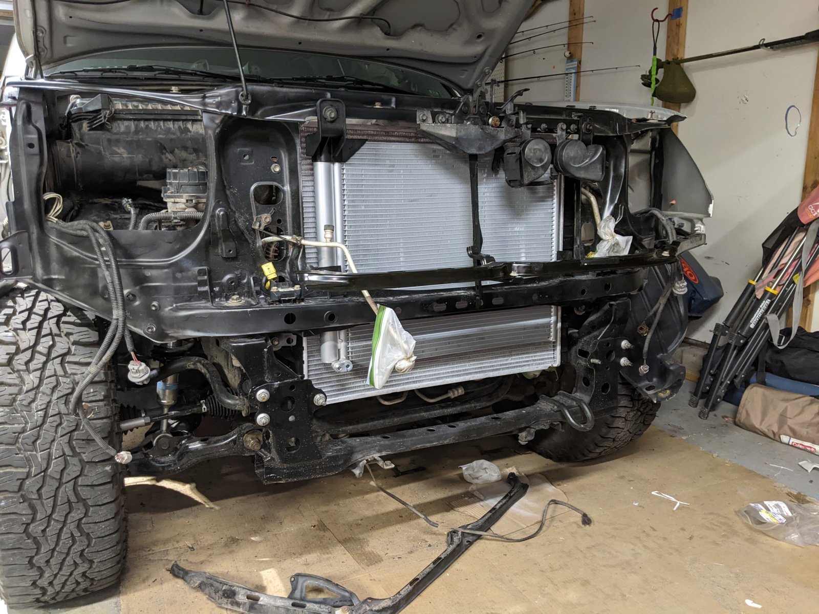

    Ok so I finish welding in all the inner metal, I found a frame shop that was actually willing to tweak the bumper mounts on the frame for me (most are not even willing to look at your vehicle when you tell them you are DIY, they dont want their name associated with it and or they only seem to want to deal with Insurance companies.
    Finally starting to bolt things back into the apron and right side inner fender.... definitely having to massage some brackets and what not, so far, everything I have bolted on except the windshield washer reservoir (aftermarket so im not 100% certain what the problem will be on that, but that isn't a huge deal)

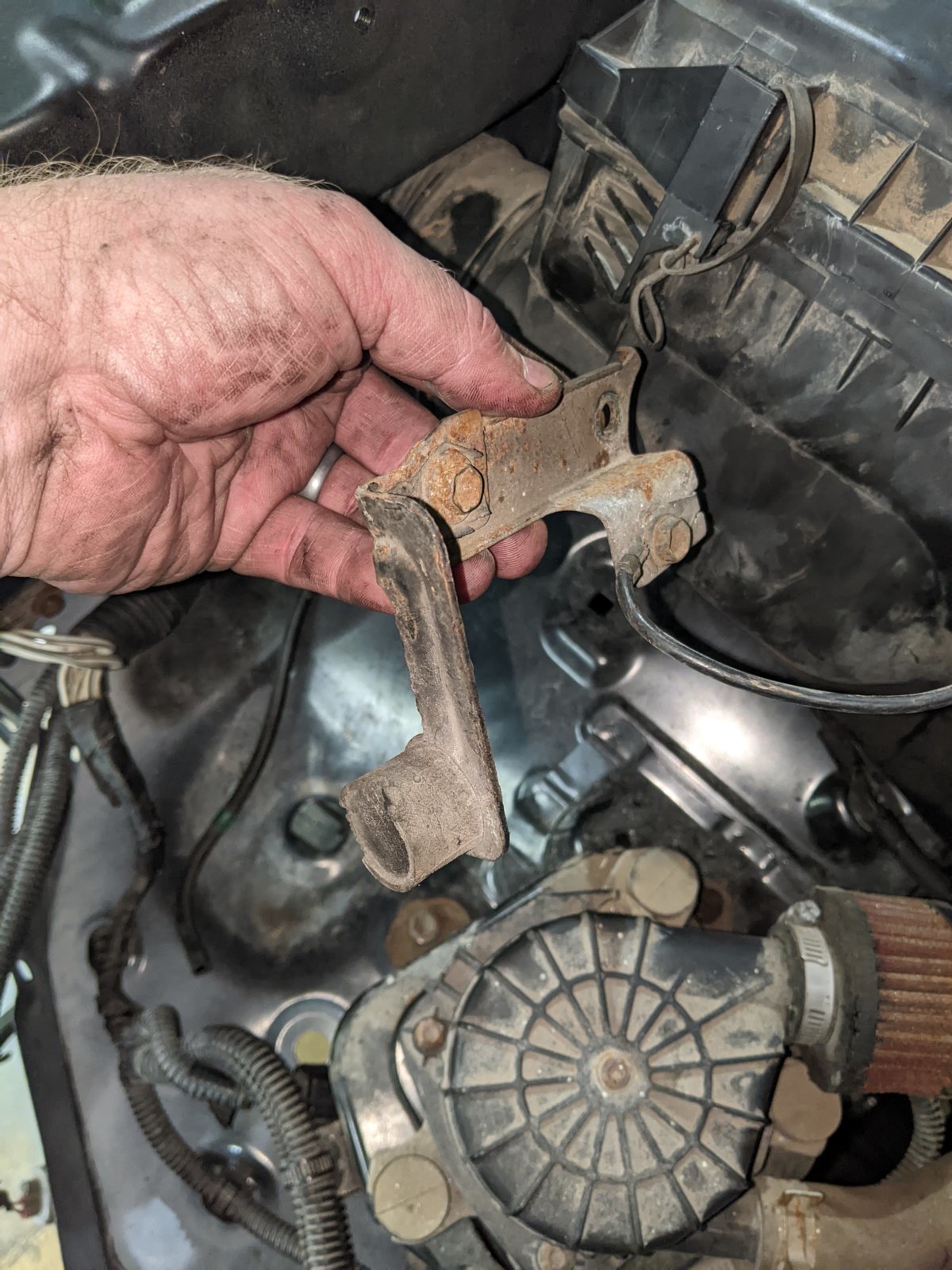

    I need HELP though....what is the below pictures item and where does it bolt up? I can't remember and based on the flow of the wiring harnesses it goes near the headlight I think....

    So for those who might be wondering that is actually half of a shock bracket for an AC line. Apparently during the accident mine must have split in half on the rubber.
    Three schools of thought:
    1) replace the bracket...equals money
    2) repair bracket... equals time
    3) remove bracket...it doesn't appear to provide and real function?

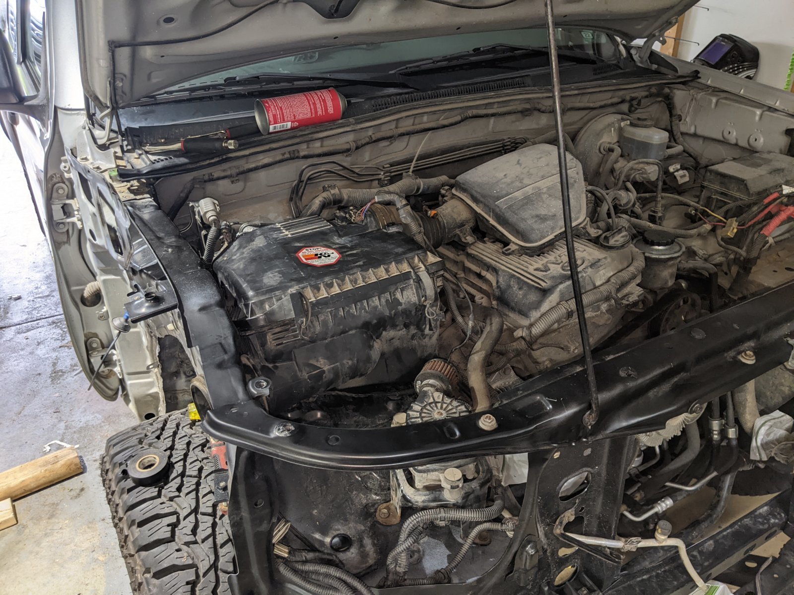

    PXL_20240619_020616337.jpg PXL_20240619_023327353.jpg PXL_20240618_214311117.jpg Gonna go with out the bracket....I think....
    In the meantime I fixed the air intake and mounted that to the fender, mounted the air intake system, rebent the bracket for the abs module and mounted that thing, mounted back the computer or control module that's by the abs module, mounted in the condenser, radiator, and fan clutch.
    Also installed some of the brackets.

    So I have the fan, fan clutch, fan shroud, and some of the headlight and grill brackets installed.
    I also put on the one headlight I could just to check for fitment. So far so good, but that is of course the side that didn't get hit so no huge surprise.... waiting on the correct antenna to arrive before I can get the new fender on and this the other headlight.PXL_20240619_162240718.jpg PXL_20240619_160632227.jpg

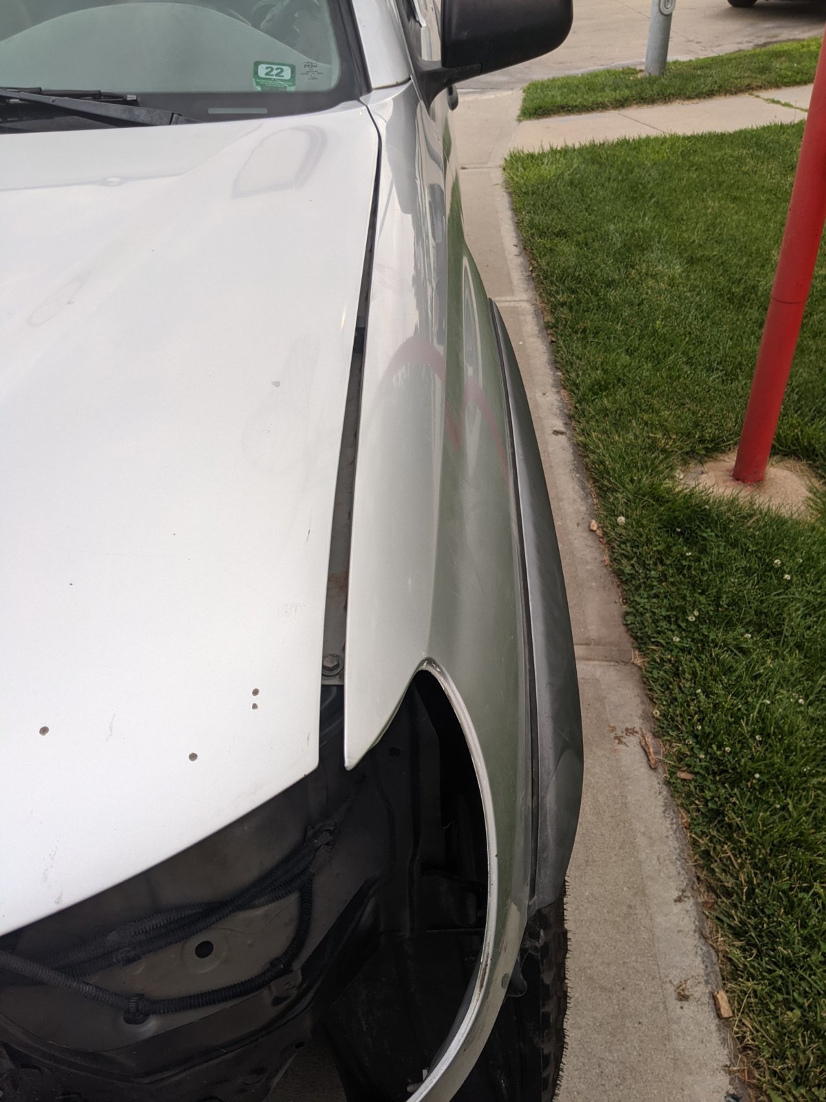

    In the meantime I am having a really hard time getting this hood to line up....it's ever so slightly to close to the fender on the side I got hit (by the grill) and ever so slightly to wide on the driver's side (by the grill). Gaps up near the windshield are pretty good.
    I have tried loosening the four bolts that hold the hood to the hinges to tweak it a little bit that way but I don't know if it will give me enough adjustment.
    Any tips or tricks would be appreciated!

    So....found out that on both the bolts from the hinge to the hood....and from the hinge to the rest of the truck, all have a shoulder that automatically center the bolt. So in essence, the only real way to adjust the hood, is to replace these bolts with regular bolts from a hardware store that don't have a centering shoulder and some washers to go with them. This allows you to get some play with the hinges and adjust more.
    Heading to home Depot tomorrow to get more bolts.
