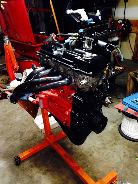

    Had my original engine rebuilt after 240,000 miles cause I thought I actually broke one or both the chains. I ordered a master rebuild kit from LCE. I bought there forged Pistons that were 20 over original oem. Had block bored and head cleaned up, and crank was in good shape. The only thing I've changed myself was clutch, pressure plate, fly wheel and throw out bearing. I know it's easier to remove Trans to install engine but it honestly went right back in wasn't forced and everything lined right up. Had everything ready tonight to just cold start it and it will not budge. I got engine back in May and put it back together in July but all internal work was done at machine shop. All I put back on it was timing cover, brackets and intake and header. So if anyone has any idea why it won't turn over I would appreciate it.
