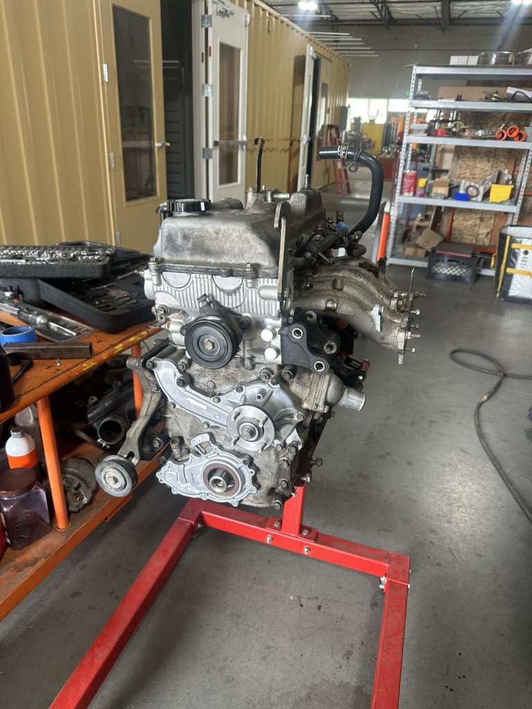

    Little update. Getting closer!

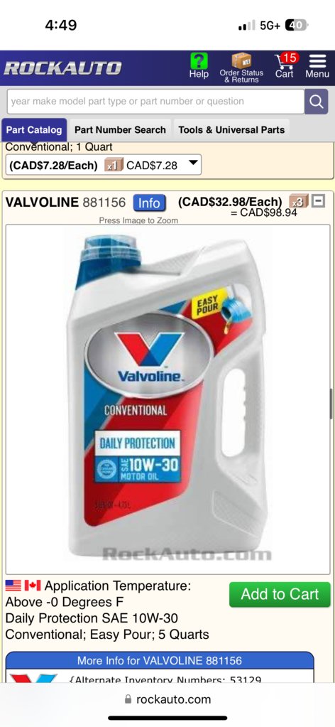

    do I have to email them or is it on their website?
  16. Apr 14, 2025 at 5:19 PM
    #196
    t0p_d0g
    t0p_d0g 私はタコマが大好きです
    Apr 17, 2023
    #422653
    1,653
    2023 TRD SPORT 4X4 DCSB CSM, 2004 TRD OR DCSB IRP
    I like to use a break in specific oil with high levels of Zinc standard conventional oil has low levels of Zinc which in my opinion is not enough protection for break in.

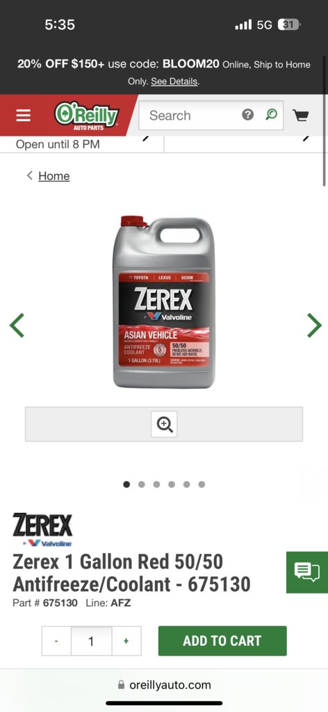

    Then moving forward after that I would switch to full synthetic. Red or pink OAT (Organic Acid Technology) coolant is great for Toyota including an aluminum radiator.

    is this good. It says it has hoat.
  20. Apr 14, 2025 at 5:39 PM
    #200
    t0p_d0g
    t0p_d0g 私はタコマが大好きです
    Apr 17, 2023
    #422653
    1,653
    That’s perfect coolant and you don’t have to use Royal Purple any good conventional break in specific oil will be fine.
