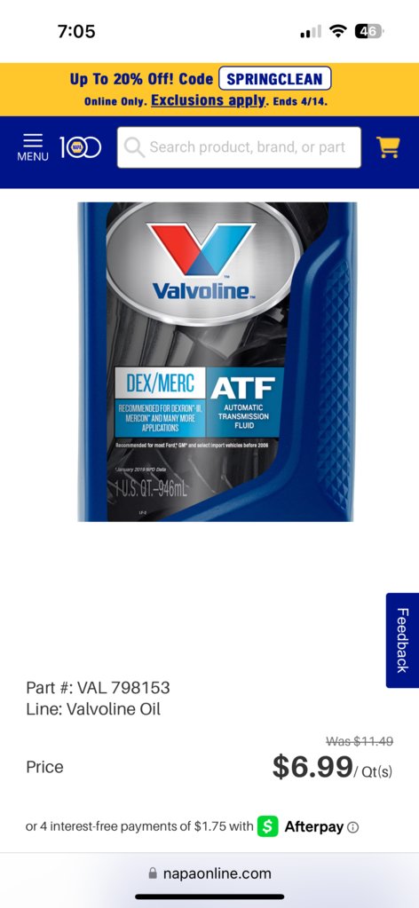

    okay and what p/s fluid would you use? I’m reading use atf is that right?

    ATF (Automatic Transmission Fluid) with a Dexron III specification.

    I did find it! Thank you!

    this should work

    As for atf.....
    max life is the way to go.....as long as you dont have any leaks
    for mine....front seal drips tiny bit in summer......so I have to use high milage walmart one........supertech me thinks
    max life is what I prefer for the PS

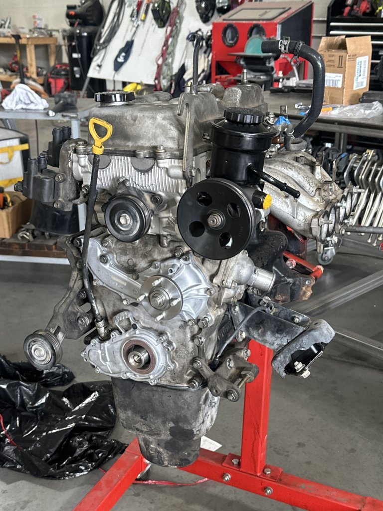

    Almost ready to drop in.
