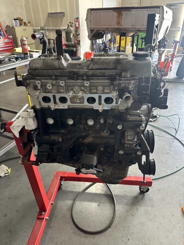

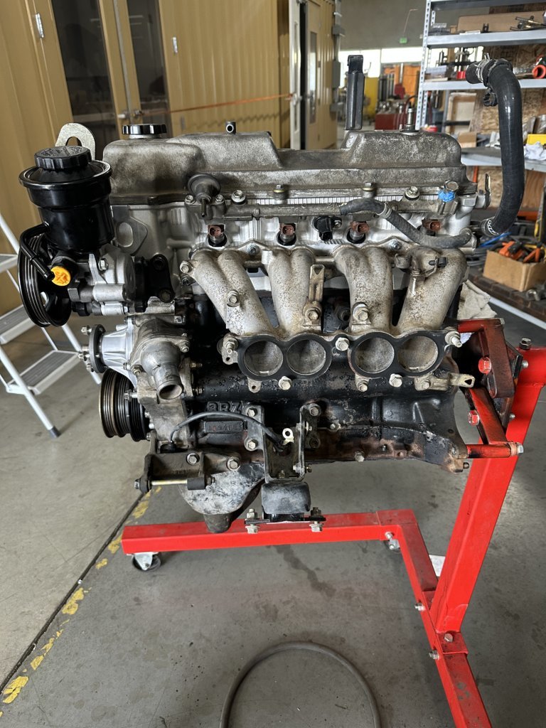

    Bilstein 5100’s with ome 881 coils on lowest setting, JBA upper control arms, LCE header, 31x10.5x15 falken wildpeaks.
    A few side shots. Just need to install the clutch when she’s hanging and then drop her in!

    that expose upper intake gasket, is that new or the one on the engine prior to the rebuild?
    if used, I wouldnt re-use it....
    easier to scrape it off now while on the stand....

    it’s a metal gasket and I was going to reuse it. The metal one should be fine if cleaned well. I’ll probably end up ordering one though.

    24 white Tacoma TRD Sport 2wd
    I wouldnt risk it,
    that goes for the lower too...
    Too much work to have to go back in for something like that vs sitting on the engine stand..

    yeah, I have a brand new lower one on there and I just ordered that one in the picture.
