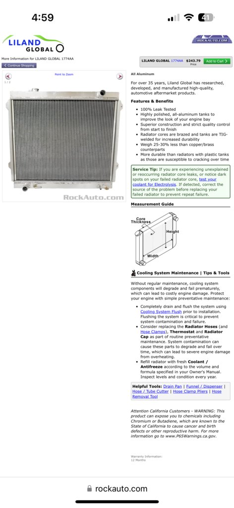

    3rz to 2Rz bebuilt block and new heads
    What kind of radiator is that.....
    mine's a 3 core champion....users are warned not to use
    I have to use either Peak10 or the prestone.......so as not to interfere with the metal gaskets and fipg
    need to use what ever that mfg recommends to be safe
    On the Denso it took about a gal and 1/3 for total system
    with the champ.....its now right at 2 gals

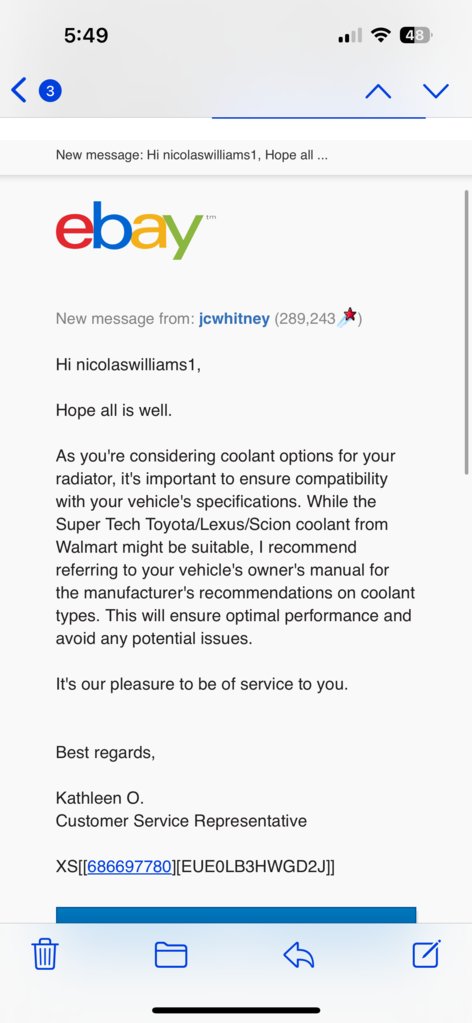

    I’ll message them and ask what they recommend.

    Bilstein 5100’s with ome 881 coils on lowest setting, JBA upper control arms, LCE header, 31x10.5x15 falken wildpeaks.
    this is the one I got

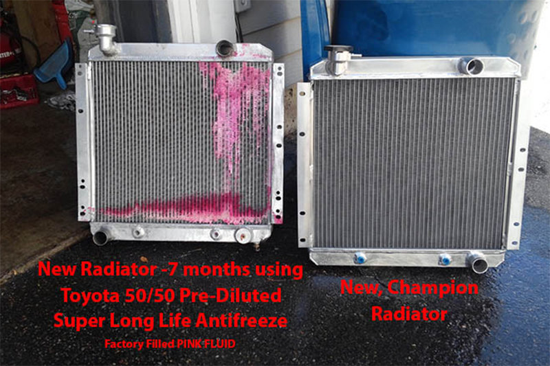

    You can safely use peak10 in any gas engine in the world.....
    prestone followed the same...........wrong additives will damage the seals/gaskets
    especially the multi layer metal ones......wrong additives and you get galvanic effect
    and any old coolant over 4 yrs slowly turns acidic........
    and you dont want that in a 200F environment
    Ive never been a fan of the pink stuff
    .......but everyone else here is.....guess thats all that matters
    https://youtu.be/Fa5CYRtga9Y
    this came out of a brandnew denso radiator after 6mo of use
    reman block and a brandnew head
    pretty sure it was the Zerex brand

    so basically I should change the coolant after like 6 months? This is what the people said where I got the radiator
    t0p_d0g likes this.
  12. Apr 26, 2025 at 5:58 PM
    #272
    t0p_d0g
    t0p_d0g 私はタコマが大好きです
    Apr 17, 2023
    #422653
    1,356
    2023 TRD SPORT 4X4 DCSB CSM, 2004 TRD OR DCSB IRP
    It looks like to me they are telling you to use what your owners manual recommends which I see no issues with the Walmart Super Tech it states aluminum compatibility so you will be good.
  13. Apr 26, 2025 at 6:04 PM

    The way I understand it is the red(hoat) reacts differently with different alloys....
    so while it only coats/ weakly binds with the aluminum, it can react with the brazing/welding that hold the aluminum box together..
    So using any radiator besides the stupid plastic one (denso) you're taking a risk....
    but keep in mine all that crap in the video happened in an oem radiator...
    I just lucked out and found all that when I drained it and switched over to the champion.
    I think all that crap was interaction between the new red(hoat) reacting with the new aluminum head......no body ever witness this.....except for the dealer mechanics.....and they cant say a word, or could lose their job.......
    And I dont even think they tell you this at champion......you have to get that info out of their blog....thats where that picture came from.
    Again the 100+ yrs green stuff works 100% with everything.....as long as it has no additives...
    .....which as far as I know, is the Peak10 and the newest max whatever...
    and the latest prestone, which is just like the peak....
    most all the other greens have anti corrosion additives which ironically can damage the multi layer metal gaskets..
    so you dont want to use just anything.
    If you want to research.......its all in hundreds of videos testing this, and whats been added in each coolant...
    You'll find toyota owners that would never jump ship from the red....
    and then other multi decade owners that laugh at these ignorant newer owners
    Way too many head gasket failure on 2rz/3rz....suspect coolant is culprit in half, and over heating on rest...
    IF denso radiator is used... at least the replacements fail after 5 or 6 yrs... necessitating fresh coolant.... they get that to look forward to

    And it doesnt make sense they tell you to change it after 6mo
    ....maybe they know something
    I know if I used the red stuff on a new head or radiator....I'd check a sample of coolant after 6mos
    and see if you get the same as with mine.....clumps, bottom floaters...
    again this was with the zerex brand....maybe the other red Hoat's are better...
    It took about 7 hot flushes to get all the red out.....and that in essentially a new engine...6 months old...
    So there is definitely something going on there....
    And I never use the drain valve.....I just pop off the bottom hose...
    ....that in itself can be another possible point of failure.
