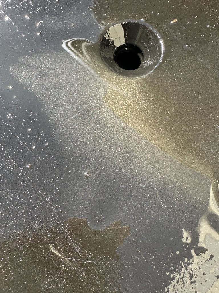

    It’s hard to tell from the picture cause it magnifies everything but it should just be fine shavings.

    yeah it wasn’t bad at all. I wasn’t worried.

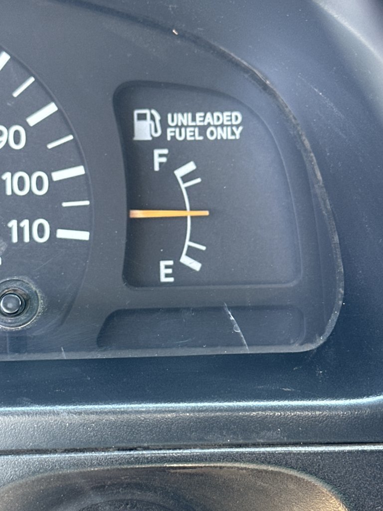

    Filled up last Friday morning and now I’m at 1/2 tank. I’d say I drove about 180 miles. I disconnected my negative yesterday for like 2 minutes and my trip a reset so it’s roughly 180 miles for 1/2 tank.
  20. May 8, 2025 at 2:58 PM
    #340
    t0p_d0g
    t0p_d0g 私はタコマが大好きです
    Apr 17, 2023
    #422653
    1,653
    2023 TRD SPORT 4X4 DCSB CSM, 2004 TRD OR DCSB IRP
    So is that around 20 mpg?
