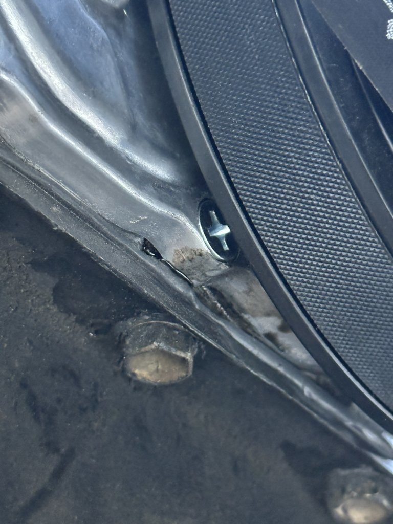

  4. May 8, 2025 at 5:15 PM
    #344
    98_3RZ_NIC
    98_3RZ_NIC [OP] Well-Known Member
    Jan 17, 2021
    #353073
    1,686
    1998 white extended cab
    Bilstein 5100’s with ome 881 coils on lowest setting, JBA upper control arms, LCE header, 31x10.5x15 falken wildpeaks.
    just noticed this…:annoyed:
  5. May 8, 2025 at 5:19 PM
    #345
    O'Silver_Taco
    O'Silver_Taco Well-Known Member
    Aug 26, 2021
    #375390
    4,171
    MD
    98 Dlx Sr5 ext AT Rwd
    3rz to 2Rz bebuilt block and new heads
    the famous cookie gasket....
    98_3RZ_NIC[OP] likes this.
  6. May 8, 2025 at 6:22 PM
    #346
    t0p_d0g
    t0p_d0g 私はタコマが大好きです
    Apr 17, 2023
    #422653
    1,653
    2023 TRD SPORT 4X4 DCSB CSM, 2004 TRD OR DCSB IRP
    Is that permatex squishing out? It looks too dark for new oil.
  7. May 8, 2025 at 7:24 PM
    #347
    98_3RZ_NIC
    Jan 17, 2021
    #353073
    1,686
    I only used a very little amount on the o ring. I didn’t permatex the whole oil pump. And I have the royal purple in remember so the oil is dark already.
  8. May 8, 2025 at 7:37 PM
    #348
    t0p_d0g
    t0p_d0g 私はタコマが大好きです
    Apr 17, 2023
    #422653
    1,653
    Oh yeah that’s right I forgot your cousin put the Valvoline in then you changed to the Royal Purple.
  9. May 8, 2025 at 7:46 PM
    #349
    t0p_d0g
    t0p_d0g 私はタコマが大好きです
    Apr 17, 2023
    #422653
    1,653
    See what @0’Silver_Taco suggests he seems to really know these 3rz engines.
  10. May 8, 2025 at 7:52 PM
    #350
    O'Silver_Taco
    Aug 26, 2021
    #375390
    4,171
    MD
    Well...my half moons leak a little......so no one is perfect
    I would just clean and watch it....
    it could be hair line passage weeping a little
    it might seal off
    Good news is all that's new and will come apart fast without any issues
    I dont like your phillip screws.....I like the allen ones from lce
    which of course their out of.....
    think I have an extra set
    98_3RZ_NIC[OP] and t0p_d0g like this.
  11. May 8, 2025 at 8:03 PM
    #351
    O'Silver_Taco
    Aug 26, 2021
    #375390
    4,171
    MD
    This is where having different adhesives....spray or what ever .....for those hard to hang gaskets can save you ass
    I've got 3m spray.....that blue stuff in the tube.....gasket shellac....tenacious oil
  12. May 8, 2025 at 8:10 PM
    #352
    98_3RZ_NIC
    Jan 17, 2021
    #353073
    1,686
    Yeah I’ll clean it and keep an eye on it. If it keeps leaking I’ll have to pull the crank pulley and tighten them and see if that helps.
  13. May 8, 2025 at 8:11 PM
    #353
    98_3RZ_NIC
    Jan 17, 2021
    #353073
    1,686
    I put permatex on my fingers and rubbed the o ring through it and then stuck it to the block in the groove for the oil pump.
  14. May 8, 2025 at 8:50 PM
    #354
    t0p_d0g
    t0p_d0g 私はタコマが大好きです
    Apr 17, 2023
    #422653
    1,653
    It looks like a small seep so clean it up and see what happens with it. If you do pull the crank pulley can you come up with something to replace those Phillip screws?
  15. May 8, 2025 at 9:17 PM
    #355
    98_3RZ_NIC
    Jan 17, 2021
    #353073
    1,686
    yeah I think so. I’ll buy some all ones. But personally I liked the phillips ones more because you can’t really over tighten them with a screen driver. I guess I didn’t tighten them enough. I thought I did.
  16. May 8, 2025 at 9:25 PM
    #356
    t0p_d0g
    t0p_d0g 私はタコマが大好きです
    Apr 17, 2023
    #422653
    1,653
    Don’t let it get you down it happens and you did an excellent job IMO.
