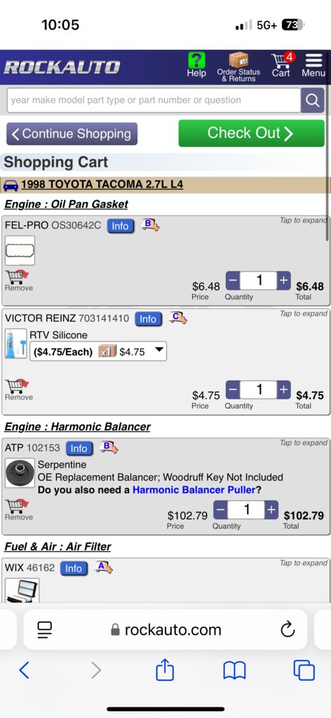

    according to rock auto it uses a gasket but I’ll do more research on that.

    It does not. They do sell a gasket but I recommend not using it as it will leak. Get yourself a tube of Toyota black seal packing from the dealer. Or use permatex black from the auto parts store

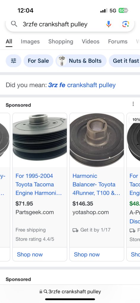

    there is all different part numbers for that permatex black. Which one is the right one?

    Should be the $146 one from Yotashop. But you can get that for a better price on RockAuto (and probably elsewhere too)
    You want the one that's a single pulley, I believe (double check what's on your blown motor). The triple pulley one is for the V6.

    I used permatex "The right stuff" when I put my engine in. I would not use a rubber or cork gasket. No leaks here over 8k on my Jdm engine that included bonus injectors, pwr steering pump, alternator and starter with engine. Although I did have to remove the 6 groove pulley and put a 4 groove on to use the alternator. Same with pwr steering pump.
