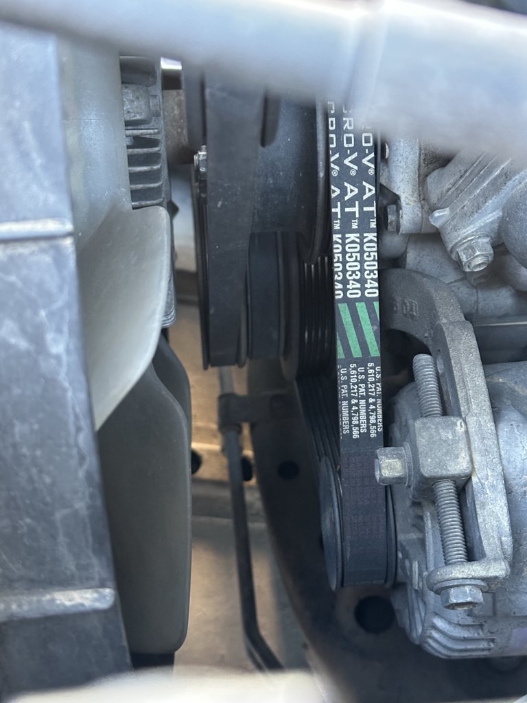

    triple pulley on my 2.7

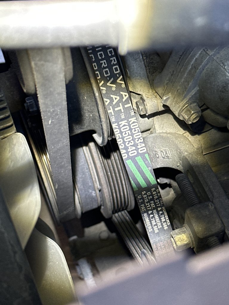

    I have the triple pulley on mine. Picture is from the battery side of the engine bay looking down. Should I replace that on the new engine?

    no worries. I just don’t want to buy the wrong part and it’s weird that they show a single pulley to be right when it’s a triple one. I want to have everything ordered and on hand so when I swap the new engine in it goes smooth.

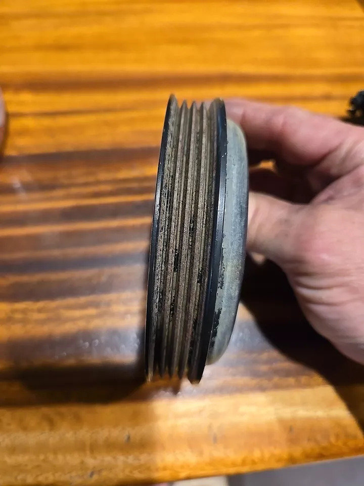

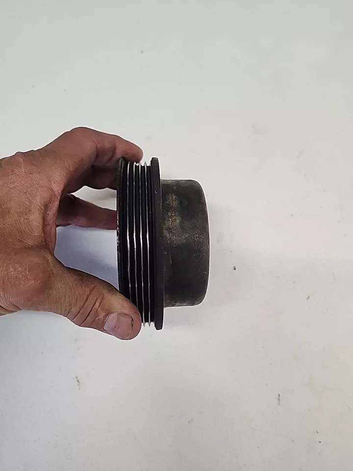

    You buy the single harmonic balance pulley...
    and then the other two bolt on to that.....one for PS....then the A/C one
    You need that single bolt to attach HB......that one you torque to like 200lbs...not reusable
    and the 4 bolts hold the two outer pulleys..
    generally the outer pulleys dont get replaced unless damaged or wobble

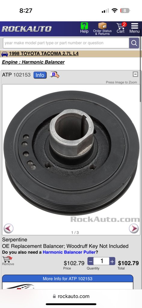

    im looking at the ATP one from rockauto. Its $102

    This one

    so those ones you posted in the pictures are good to reuse? They aren’t damaged in any way.

    As long as not dinged up or bent......they just drive accessories
    Its the rubber in the HB that goes bad eventually....
    no shortage on aftermarket these.......not sure oem's is worth the extra
