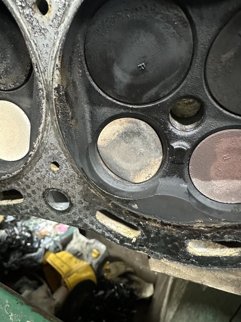

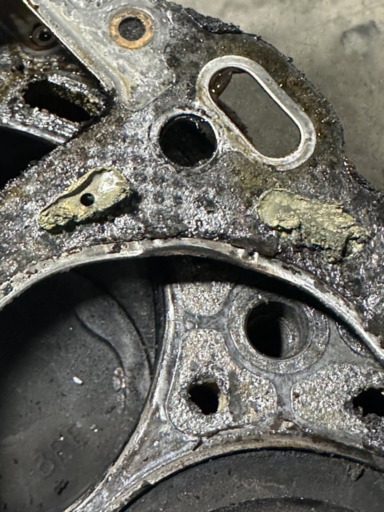

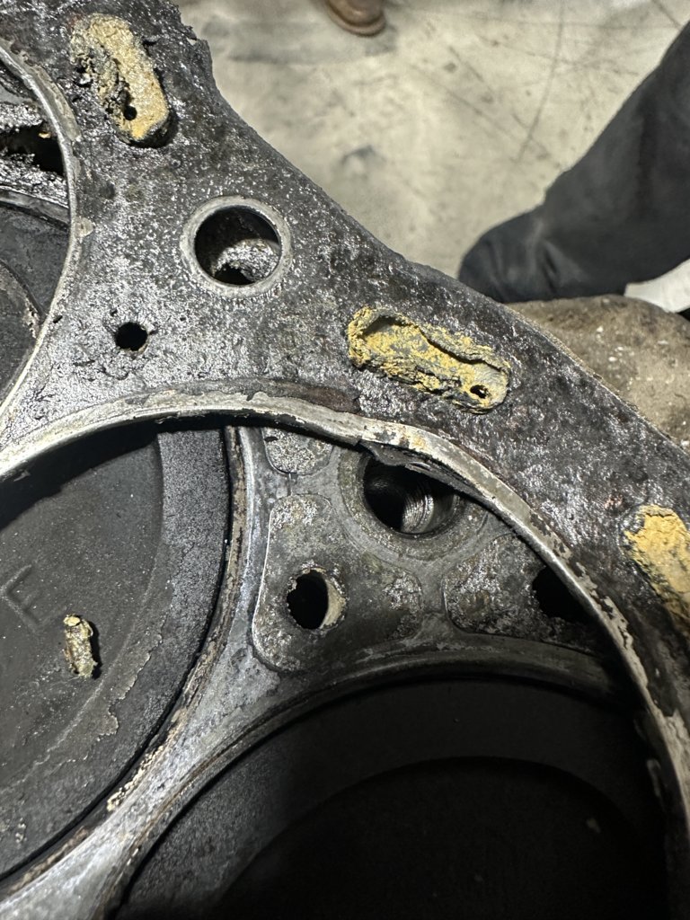

    Just don’t cut any corners.
    What’s up with that head gasket?
  3. Feb 13, 2025 at 8:08 PM
    #83
    98_3RZ_NIC
    98_3RZ_NIC [OP] Well-Known Member
    Jan 17, 2021
    #353073
    1,686
    1998 white extended cab
    Bilstein 5100’s with ome 881 coils on lowest setting, JBA upper control arms, LCE header, 31x10.5x15 falken wildpeaks.
    I won’t. And I have no clue. This is the first time over had the head off.
  4. Feb 13, 2025 at 8:12 PM
    #84
    t0p_d0g
    t0p_d0g 私はタコマが大好きです
    Apr 17, 2023
    #422653
    1,653
    2023 TRD SPORT 4X4 DCSB CSM, 2004 TRD OR DCSB IRP
    I would probably bore the cylinders, deck the block, build the head and resurface, new cam shaft is a must and have the crank checked out. Definitely have the block cleaned and new cam bearings.
