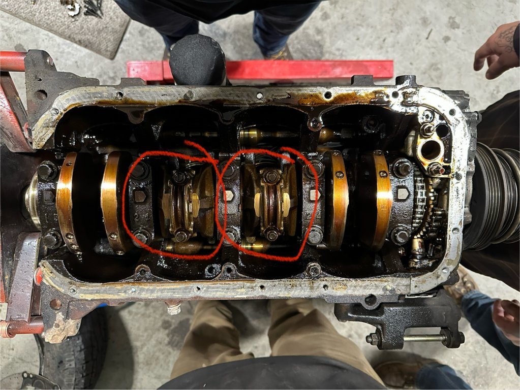

    If I were building the engine it being a cast iron block I would have it hot tanked and magna fluxed. If the cylinders didn’t meet spec I would have it bored. If the crank checks out to spec I would put it back with std. bearings. I always replace the cam shaft with almost any build. The head or heads depending on engine type always get rebuilt/remanufactured. As far as the rest of the components they get replaced.
    This is just a general idea IMHO. Sure you can pick it to pieces but it’s a general idea as said.

    What is the crankshaft spec where the rod bearing goes onto the crankshaft?
  6. Feb 15, 2025 at 2:44 PM
    #106
    98_3RZ_NIC
    98_3RZ_NIC [OP] Well-Known Member
    Jan 17, 2021
    #353073
    1,692
    1998 white extended cab
    Bilstein 5100’s with ome 881 coils on lowest setting, JBA upper control arms, LCE header, 31x10.5x15 falken wildpeaks.
    Like right here. So I can measure for tolerances when I get the new bearings.

    I don’t have a repair manual on this particular engine but I did find this.
    1998 Toyota 3RZ engine, the rod journal specifications are typically around 53.01mm (2.087 inches) in diameter, with a standard bearing thickness ranging from 0.0015" to 0.0025" depending on the brand and application.

    Three decimal places on the inch measurement isn't enough precision when you have to measure down to tenths (ten-thousanths).
    Standard crank pin per the manual is 52.987 – 53.000mm (2.0861 – 2.0866").

    awesome thank you! I’ll measure that tomorrow and make sure it’s within spec.
