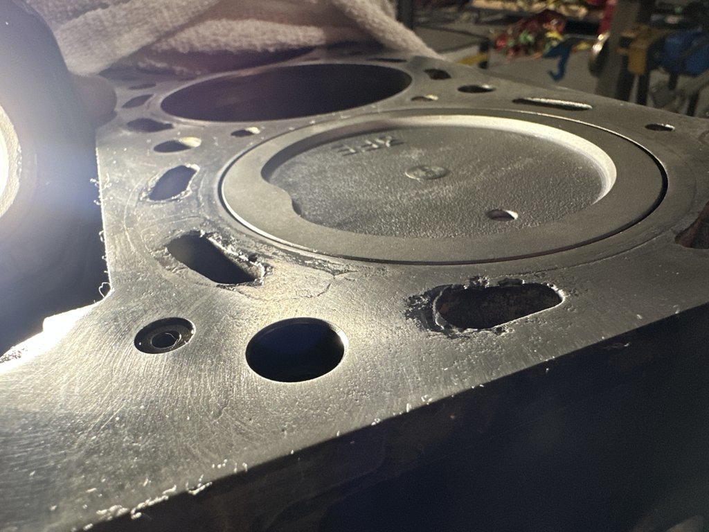

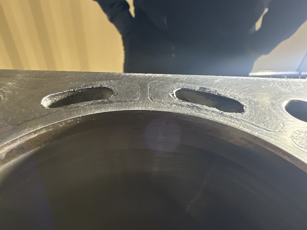

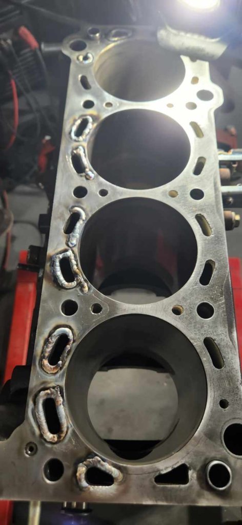

    sad. Had to tig weld the top of the block and take it to a machine shop and have them cut it back to factory spec. Would have had it decked but the guy at the machine shop looked at his computer files for the 3rz and there is no tolerance to deck so I had my cousin fill in the pits and the machine shop will clean it up.

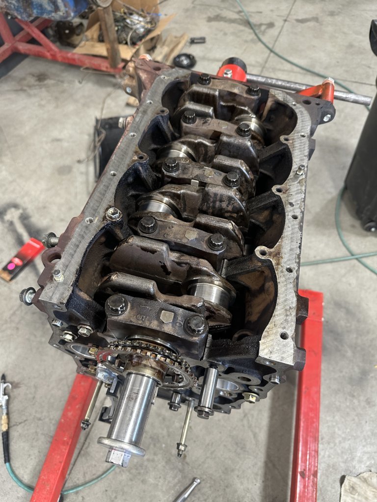

    is there a sequence to tightening connecting rod caps? I can’t find anything on that. I know there’s a sequence for main bearing caps and head bolts but I’m not sure about connecting rod caps.

    They usually just get tightened in steps. There is no pattern because the rod bolts only clamp the rod and the rod floats on the crank; it's not one of many bolts clamping a large piece like the head or block. For that reason, you can finish torquing one rod cap before moving onto the next. However, I prefer to do one step at a time on all relevant fasteners so it's easier to keep track of what's been done.

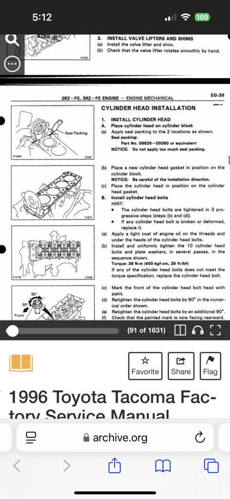

    Which seal packing is the best to use for the head gasket where it meets the front of the block? It gives a part number but I can’t find it.
