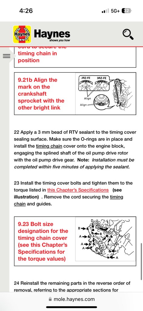

    Okay so I’m a little stuck on number 22. It says apply a 3mm bead of rtv sealant to timing cover sealing surface. Where is that at? Because where the timing cover meets the block there is a gasket and then at the top it sits on the head gasket and the bottom is the oil pan so where does it need the rtv at?

    I’m assuming Haynes directions are for installing with sealant only no gasket. When I’m using a gasket on any sealing surface I always apply a very thin layer of sealant to both sides of the gasket and then install. Not to head gaskets just things like timing chain covers, water pumps etc. This is my way of doing things so wait and see if dirty or red think different.

    okay then I’ll do a thin layer on both sides. Like very thin yeah?

    So where do you guys recommend applying the ultra black on the timing cover because I have gaskets for the timing cover where it meets the block. @Red_03Taco @Dirty Dude

    Some guys swear by dry gaskets I’ve just always used a very thin layer for piece of mind never had a gasket leak or fail.
