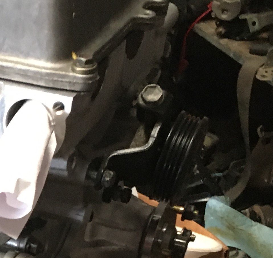

    On mine about a year after the engine was put in, I found a few bolts on accessory items on and around the engine had worked loose. My pulley bracket for power steer belt...had three bolts holding that bracket on the front on the engine that were all loose, one of them was hanging by a couple threads.
    This thread reminds me that its about time to check all those again...
    That and its time to eyeball the suspension.....I had the bellows pop off the passenger side tierod about a year ago too....fortunately I caught early enough....
    Good lesson is to recheck anything major done maybe 6 and 12 months out from the work...and annual inspections after that..

    Yeah it looks like they left those three bolts loose when they put mine back together...
    and that was a very well-seasoned professional mechanic crew that does about a hundred swaps and engine tear in's a year....
    most of them asian vehicles......and most of them Toyotas...
    that missing / late delay in getting the oil cannister bracket and parts....must of threw them off...
    it happens..........could of been the Corona too...
    I got a few bolts loose/missing in me......so I'm damn sure not gonna rebuild an engine myself........that would be stupid....
