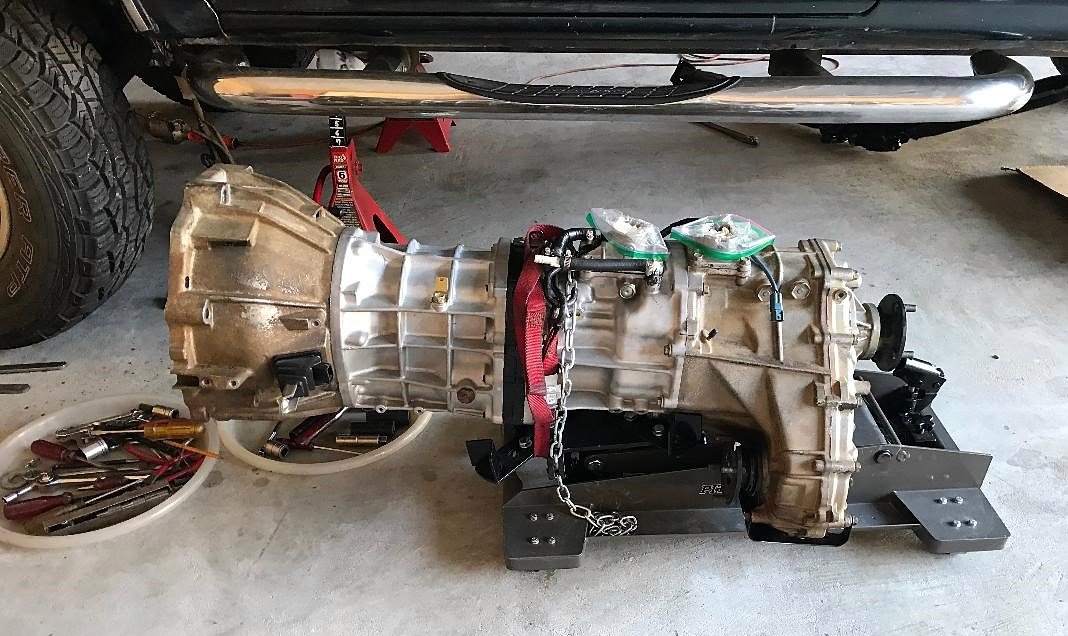

    OK! This saga continues. I returned the R150F tranny to Marlin for "warranty work" even though my '97 Taco was never even capable of leaving my garage. The tranny was returned to me 11 days later. But the gear box was, once again, stuck in gear! Luckily, the gear box was stuck in reverse this time around. So I removed the backup light switch which had already been installed, pried on whatever is inside the tranny back toward the center plate, and got it sorted out. The tranny would now shift gears as it should. What a goat rope!

    Same here and I agree. Many of the packages I have received in just the past few years thru UPS/FEDEX/USPS are damaged. Prior to that, I don't think I had a damaged package problem in 20 years. The shipping monkeys must be working overtime tossing our packages around. LOL
    The R150F is once again installed. But this time around, it is functioning as it should. Good thing too because with me being just under 70, removing/reinstalling a transmission is not as easy as it used to be. Now it's time for some more of that high quality Hunting/Shooting/Fishing/Hiking!

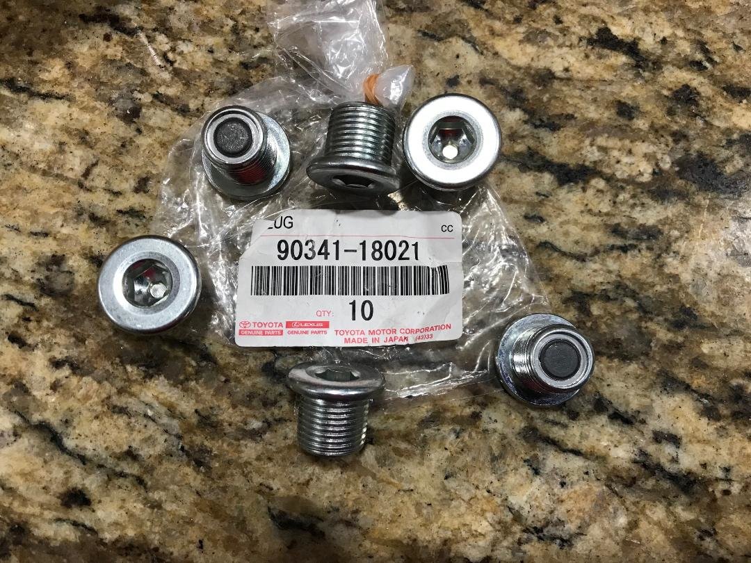

    Something worth mentioning is the short magnetic drain plug, p/n 90341-18021, that fits in the R150F manual transmission and the Tcase. The front and rear diffs. on my '97 Taco both have magnetic drain plugs from the factory. And I originally thought that since the OEM tranny & Tcase drain plugs were not magnetic, they were perhaps not needed. But then I read that the Lexus 4WD has them and Marlin also installs them on their rebuilt transmissions. My '97 Taco now has them in both the R150F manual tranny and the Tcase. They were only about $3 each, cheap insurance in my book, and will also be installed in my buddy's '03 Taco & my 3rd Gen Taco Tcase when I/we change the gear oil. I looked for an OEM Toyota magnetic engine oil drain plug but struck out.
    In 55 years of wrenching my own cars/race cars/4WDs, I have never removed a magnetic drain plug from a diff./tranny/Tcase that did not have at least a little ferrous metal gunk stuck to it. So I would think that these $3 each short magnetic drain plugs will be of value in our manual transmissions/Tcases.
