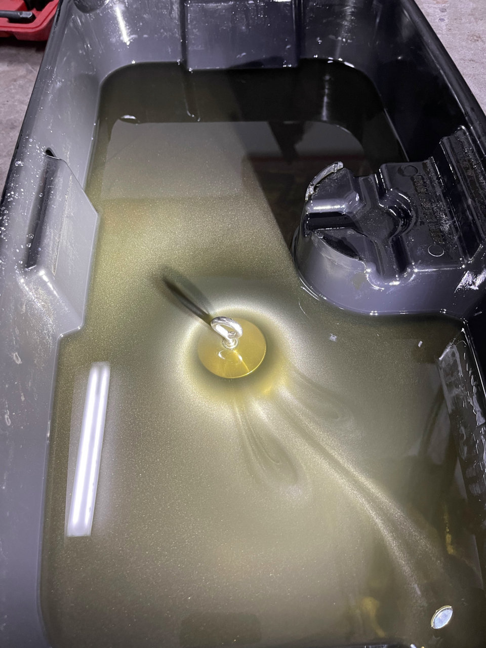

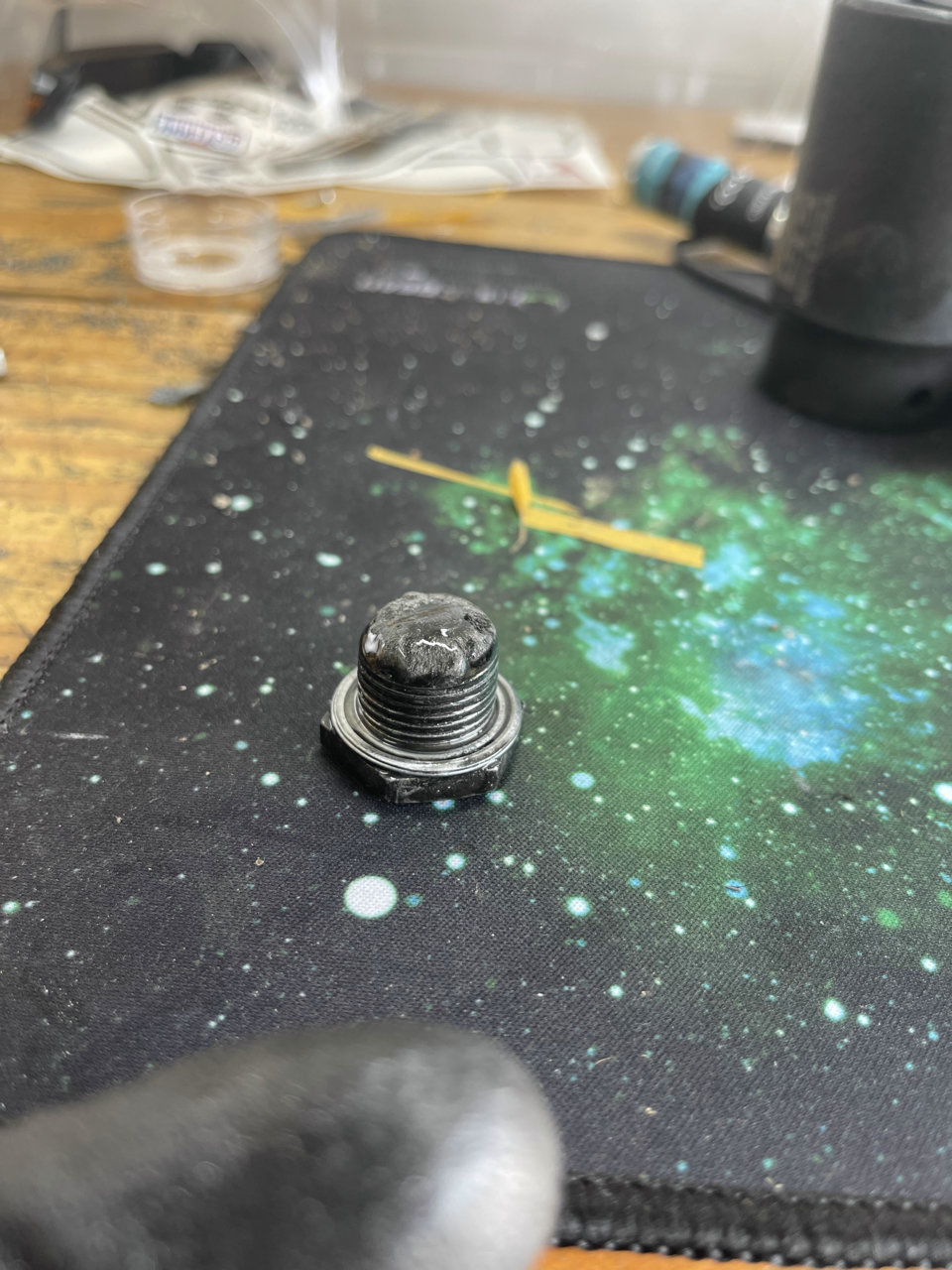

    Anyways, I changed the fluid after 800 or so miles and the fluid came out silvery throughout with metal "paste" accumulated at the magnet. I thought this was somewhat normal for the break-in period, ect didn't think much of it. Put fresh oil in it and moved on.
    150 miles later curiosity got the best of me so I drained the rear diff oil again. same outcome with silvery fluid, almost like a very fine sand-like consistency with the metal particles, magnet covered in metal paste again. Put fresh oil in it again, only this time a bit concerned with what's going on
    Changed the diff fluid AGAIN after 100 or so miles and still the same outcome with the oil.
    Is this normal break-in behavior for a diff that's been rebuilt ? 3 oil changes and I'm still getting metal dust in the diff oil. Wondering if there could be something else going on. Any diff experts out there have thoughts ?

    If it made that much glitter in only 100 mi something definitely isn't right.
    Is it making noise?

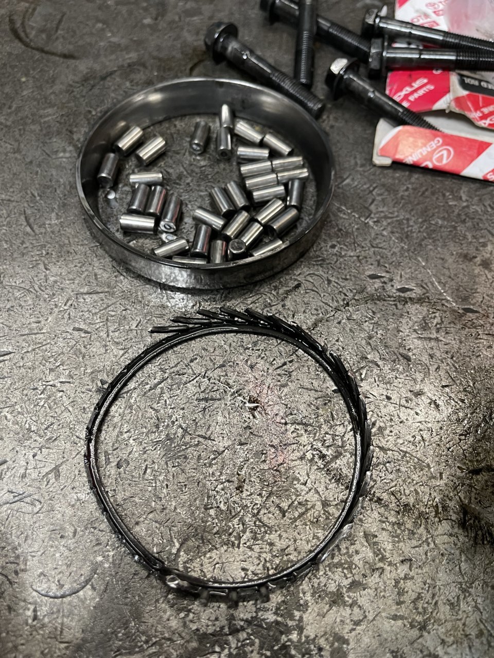

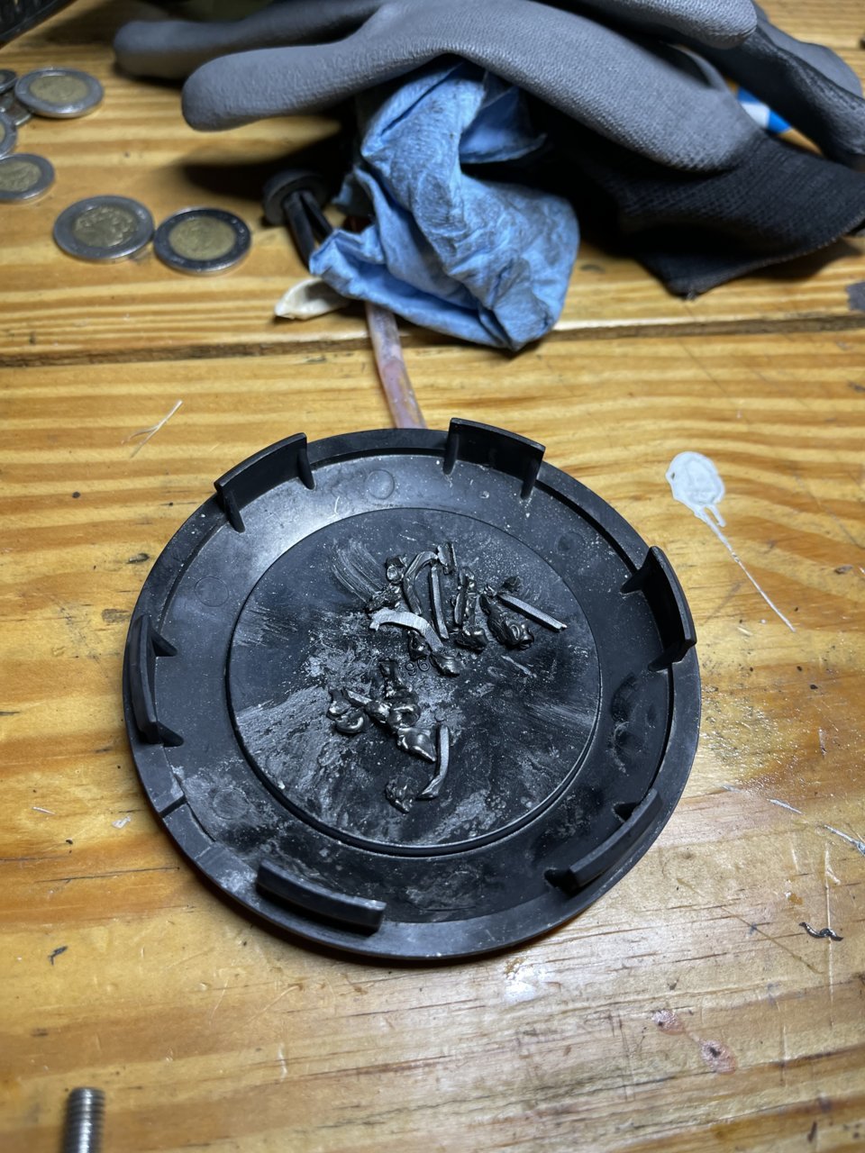

    Yea it did. When I drained the oil prior to rebuild I found glitter and metal chunks. When the shop took it apart they found one of the carrier bearings had called it quits

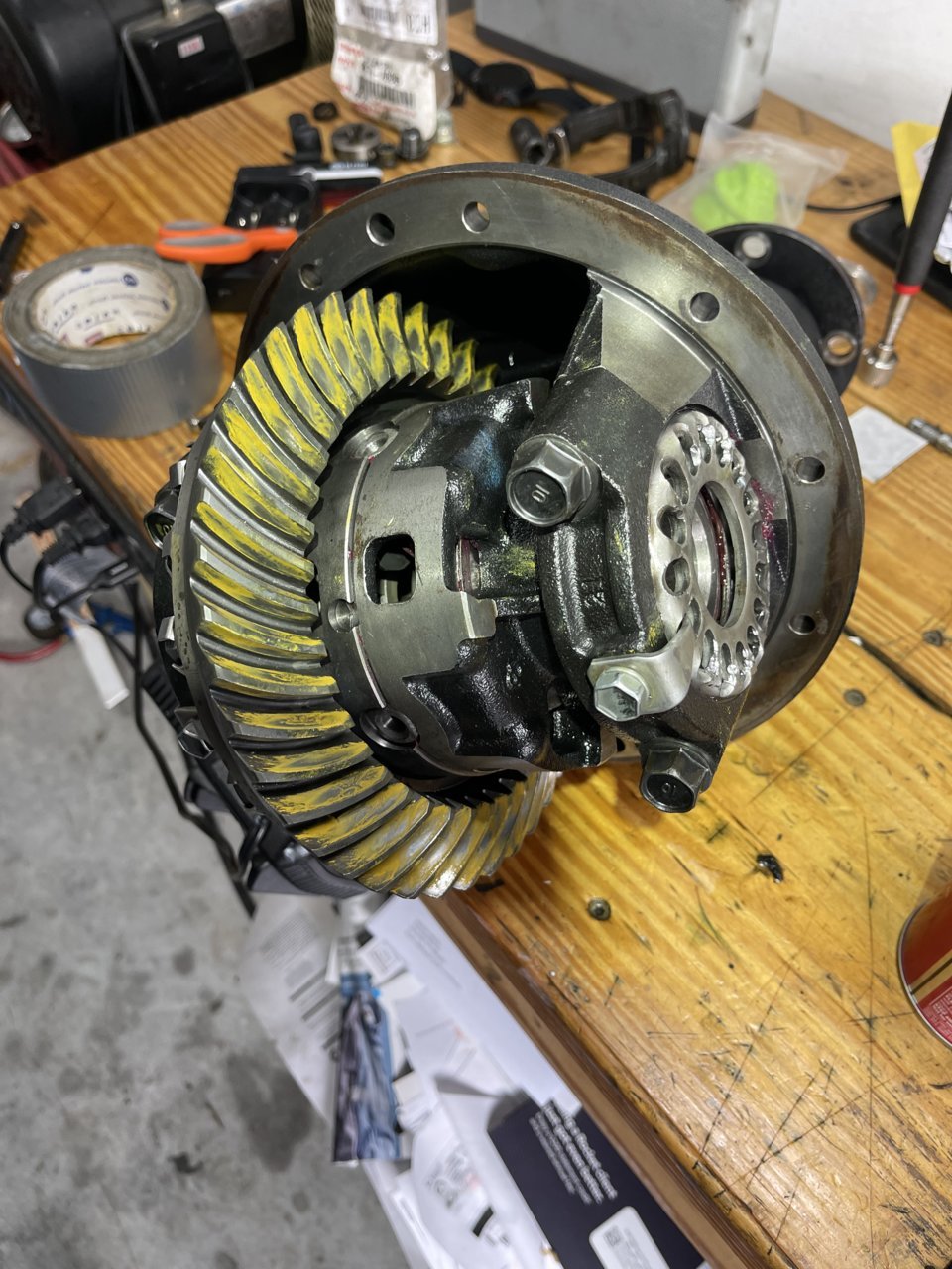

    this is how the wear pattern looked before I threw the rebuilt diff on. I don’t really know how to interpret this but I’m aware that you can tell a lot by the paint pattern. Does this look normal?

    First of all, there was still probably a ton of fine ''glitter'' left in the axle tubes and it takes VERY little to discolor the gear oil. You'll also almost always get some very fine particles [which is what I see on the magnet] when you initially install and run a new 3rd member. It may be set up properly but it still has to wear in.
    I sorta consider it to be like antiseize, one teeny tiny little dab goes a long way when you get it on something you don't want it to get on. It's also way you should change gear oil when hot and right after using it before some of it drops out of suspension.
    Grit and chunks, BAD, particles you can't even feel if you rub you fingers together, pretty normal. I'd personally like to see a little bit more contact between the ring and pinion gears but it's likely fine. It's pretty easy to set up a 3rd member nicely on a bench VS doing it in the axle housing.

    I would say based upon the wear pattern, and lack of noise, that you are fine. The glitter is nothing I would be overly concerned about. Diffs run on the dirty side predominantly anyway. I would check it within the next 5000 miles and see what it looks like from there.

    Checkout "gold plug". It's a drain plug with a very strong magnet. It can manage that glitter much faster than the stock plug.
