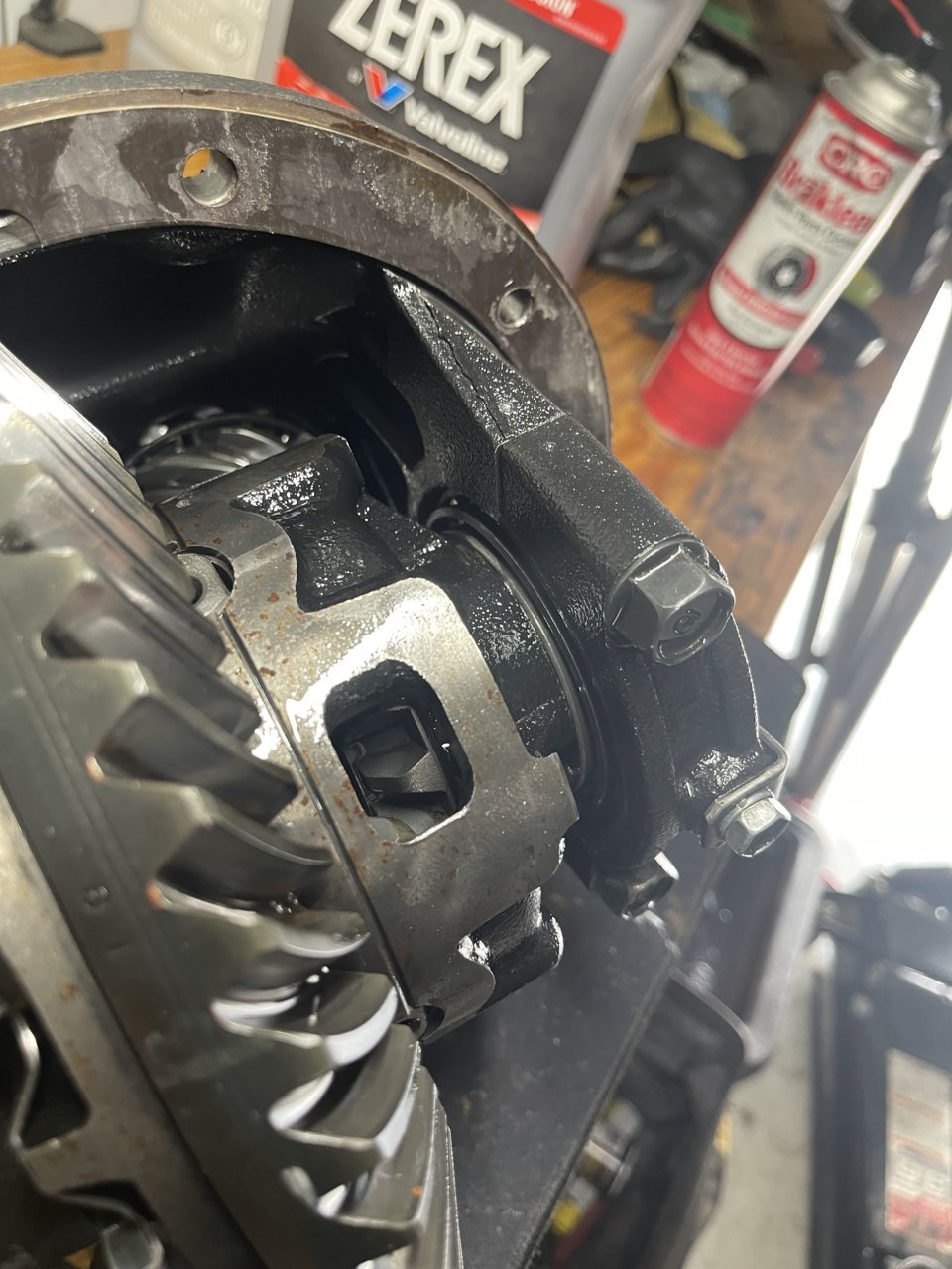

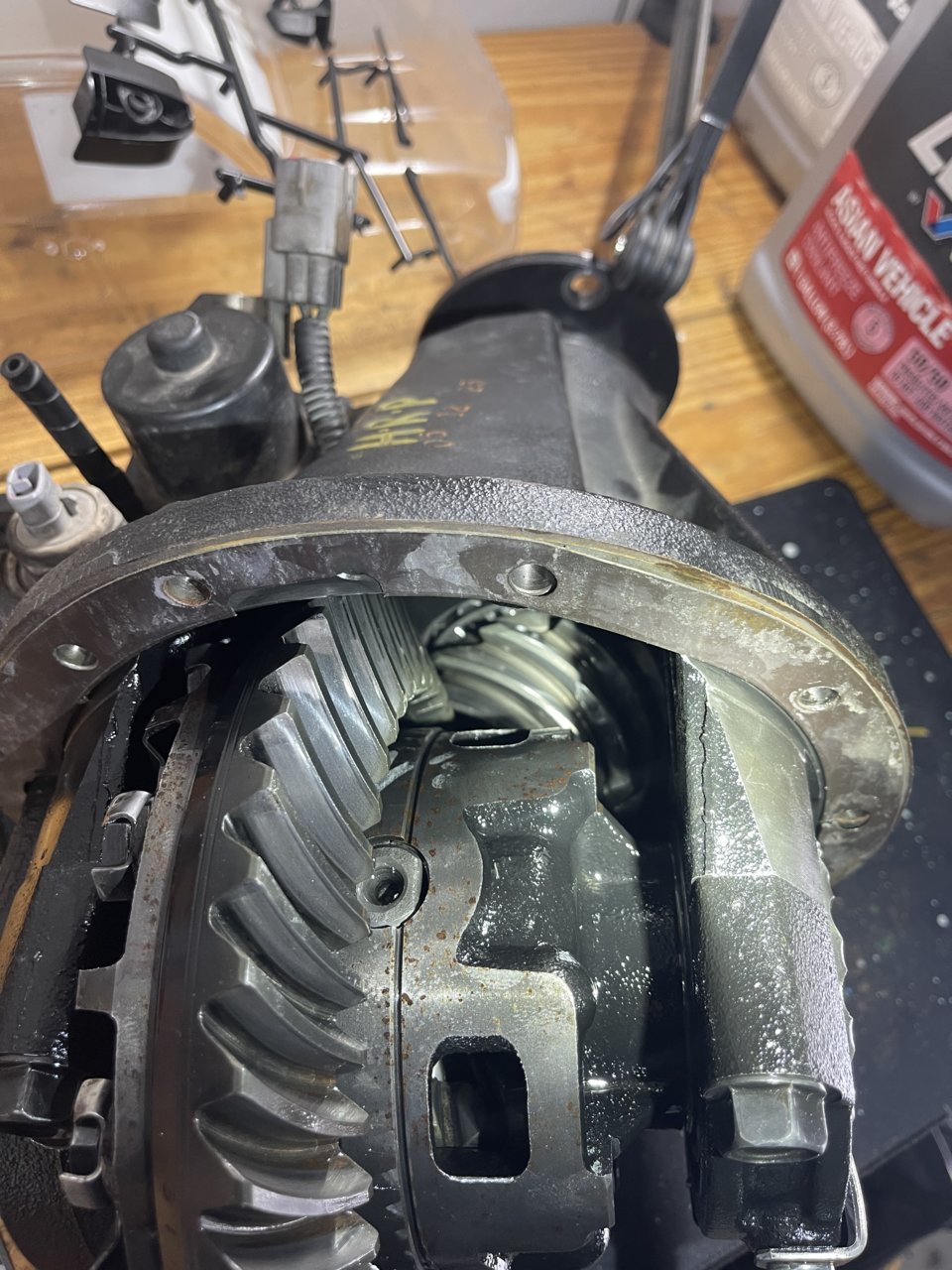

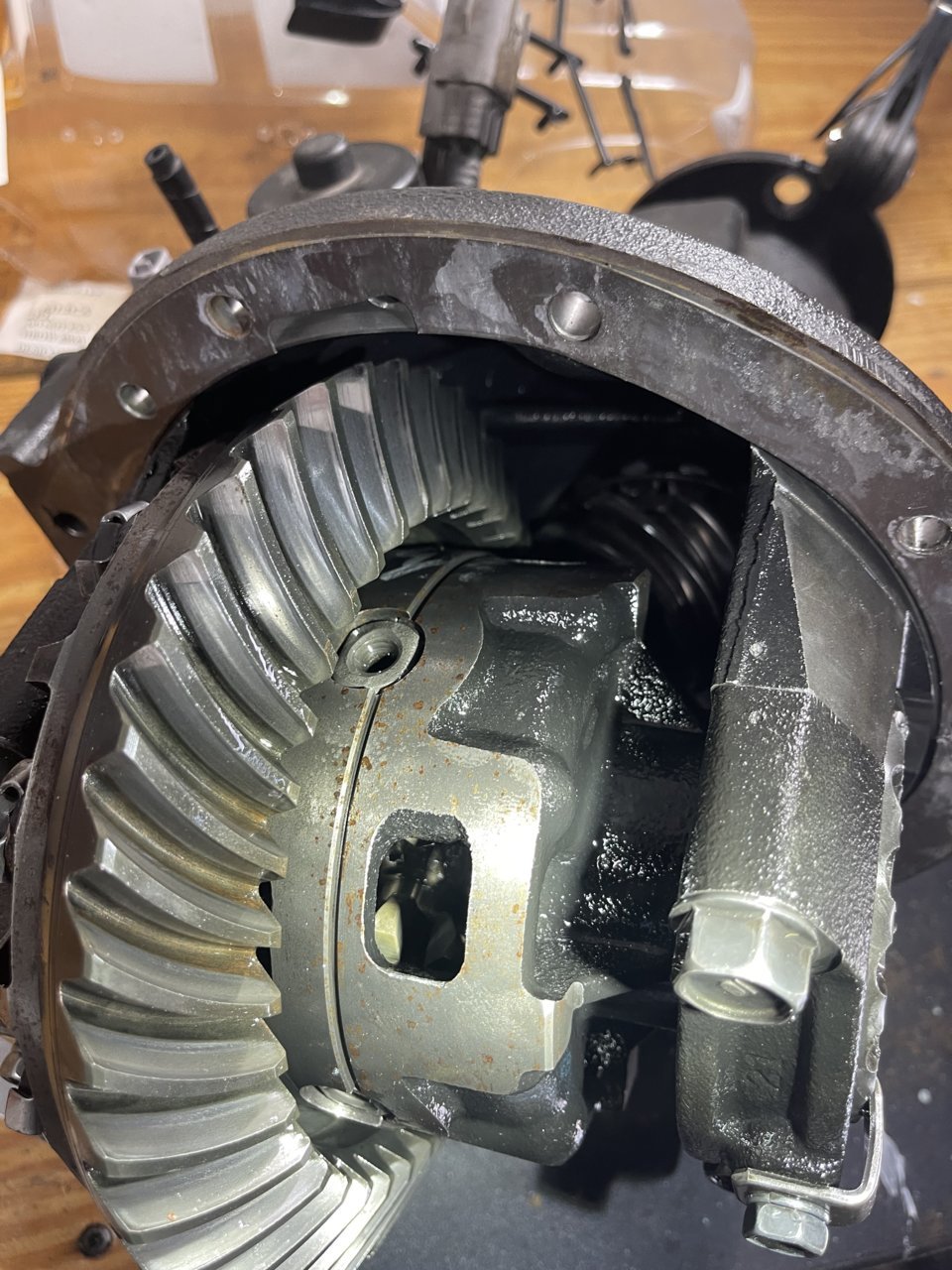

    Pulled the diff. Do y’all see anything here that looks suspect ?

    I think it's a little ''tight'' but the wear pattern is quite good and even. I guarantee you aren't getting any slop/play in that 3rd member.
