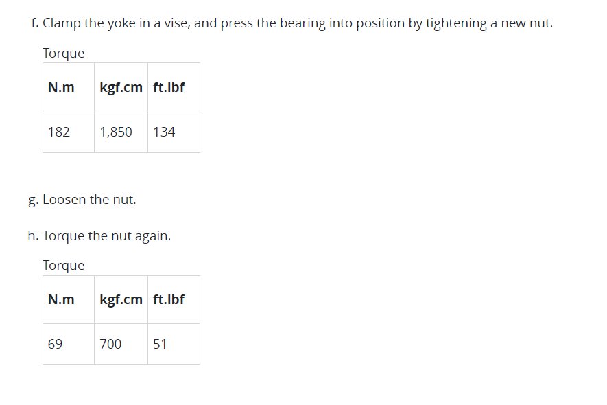

    What process did you use to press the Center support bearing on?
    What torque sequence did you use?
    It's a 2 step process. If you only torqued it to the final setting. The bearing may be loose.
    Other than that, It's likely a bad part. (If you put it back together the same way it came off.)
    Unless you truck is lifted. In which case, one could argue that when replacing the center support. You change the pinion angle.
    But your center support would need to have super bad, and you truck would need to be lifted. And even then, it's argument of "could".
    As that scenario is unlikely.

    There should have been an arrow on the center support.
    IIRC, the arrow points to the front of the truck.
    Also, the final torque on the nut is not as much as you'd think.
    I don't think that's the cause of your issue. But too tight can cause premature failure.

    Well dropped of the drive shaft to this well regarded driveshaft shop and the owner said he never heard of this? Not dissing anyones suggestions but will post the results. They work on shafts for all kinds of vehicles.

    It's right out of the FSM.
    Leaving too much torque on the nut and you can cause the bearing to fail prematurely.
    As that will "squeeze" the bearing too tight cause potential issues.
    The reason you over torque it to start with, is to seat the bearing.
    The same goes for the front wheel bearings. Too tight and they will fail prematurely.
    Blasting the axle nut on with an impact is not ideal. It works, but it's not correct.
