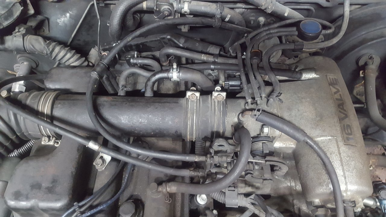

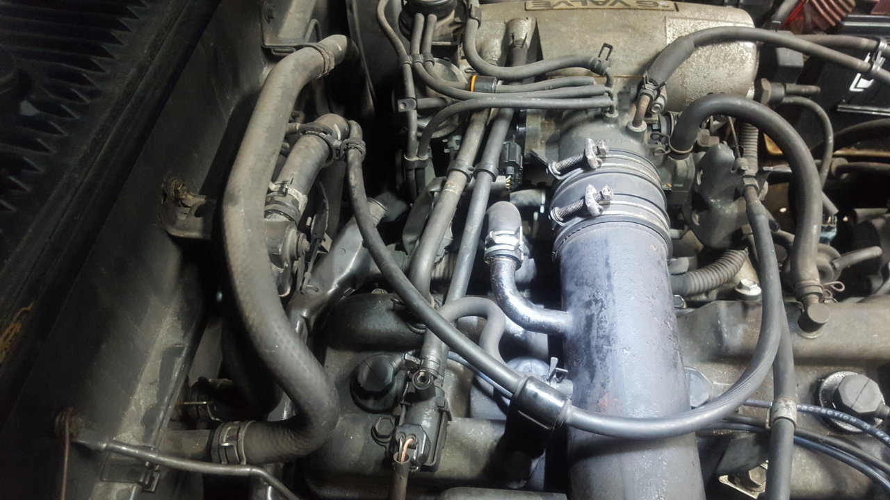

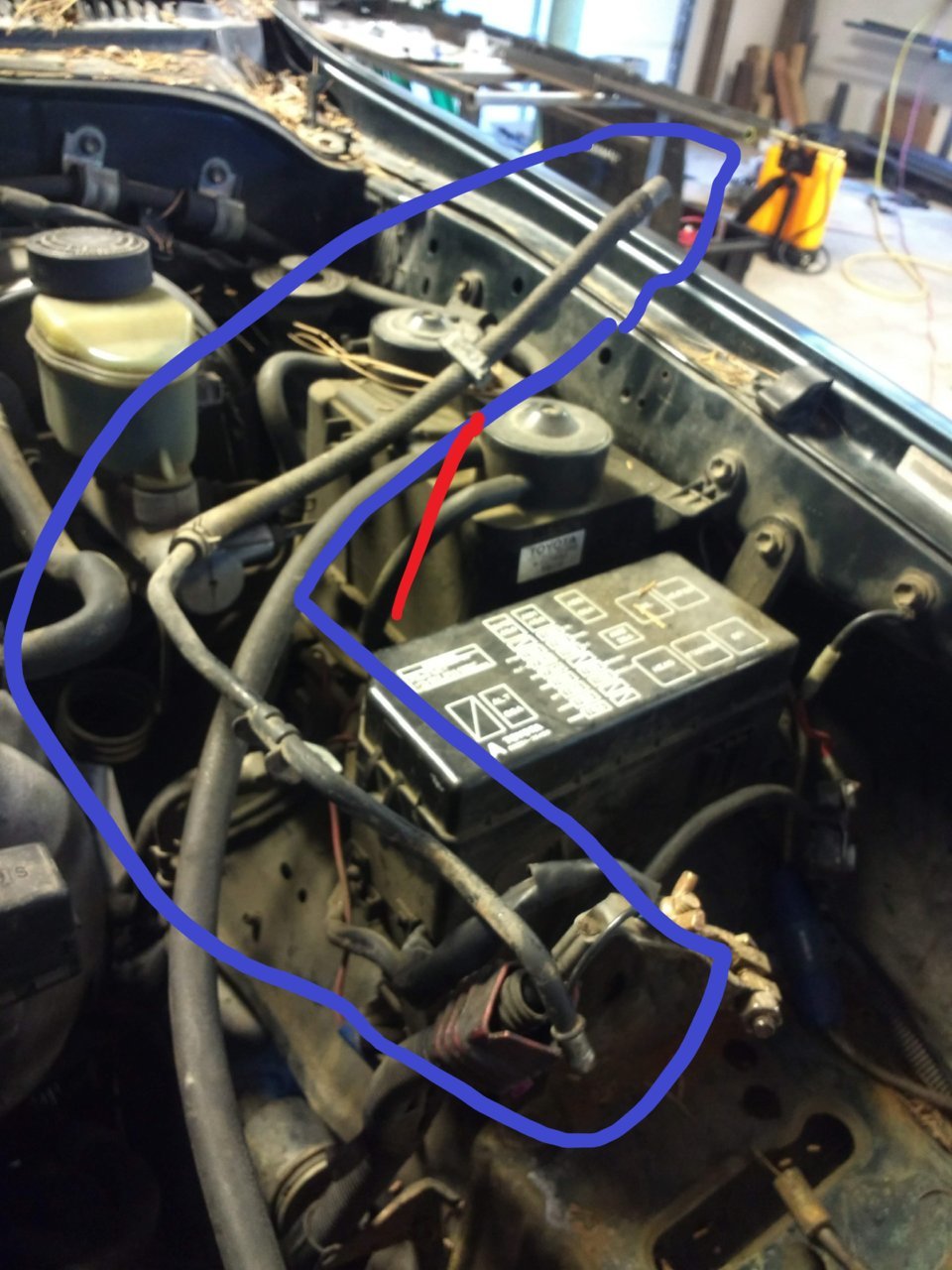

    I'm trying to figure out the where these hoses go. Some how I missed them when I was marking everything.
    The one circled in blue used to be clipped next to the ABS module as shown with the red line.
    The two connections circled in red: The hose comes off the bottom of the throttle body, but I'm not sure that it connects to the vacuum pot for the EGR which is the open connection in the circle.thoughts?
    Also some pictures of of 2.7s in the manifold area wouldn't hurt just for general reference.
    Thanks.

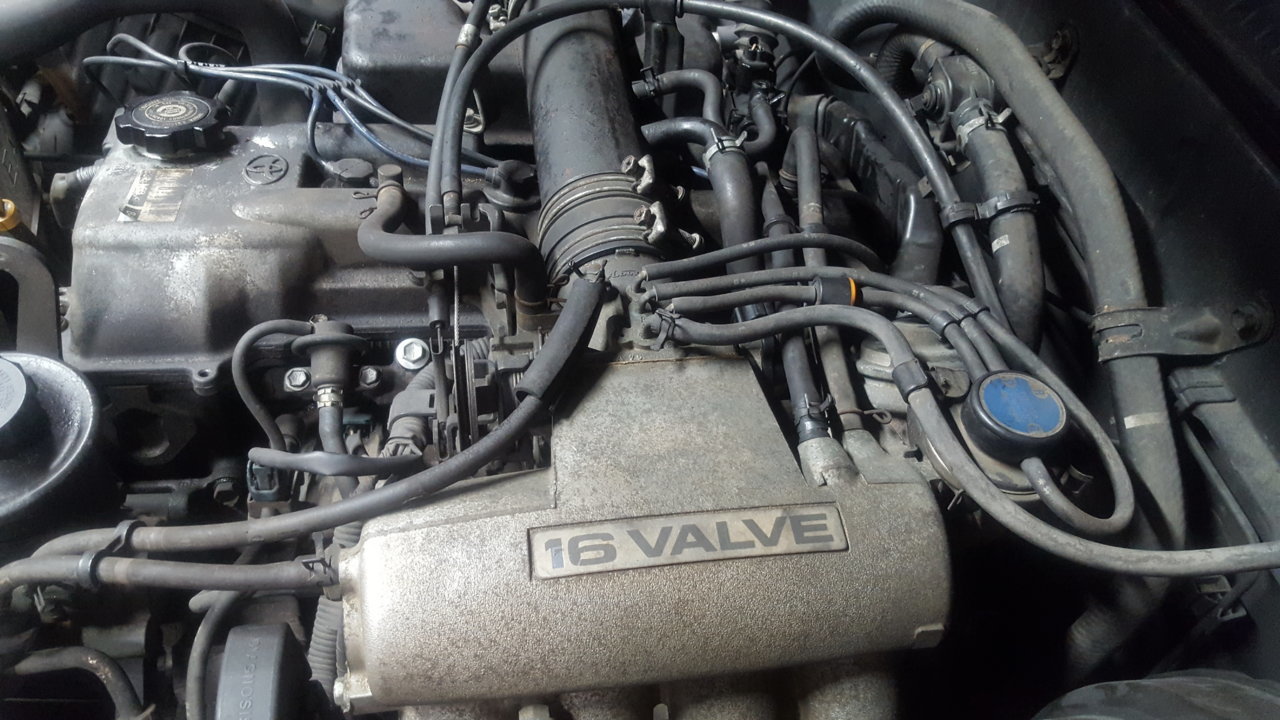

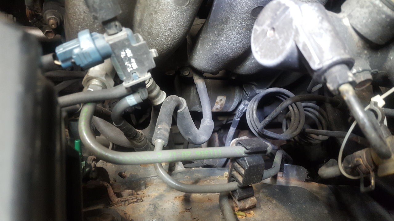

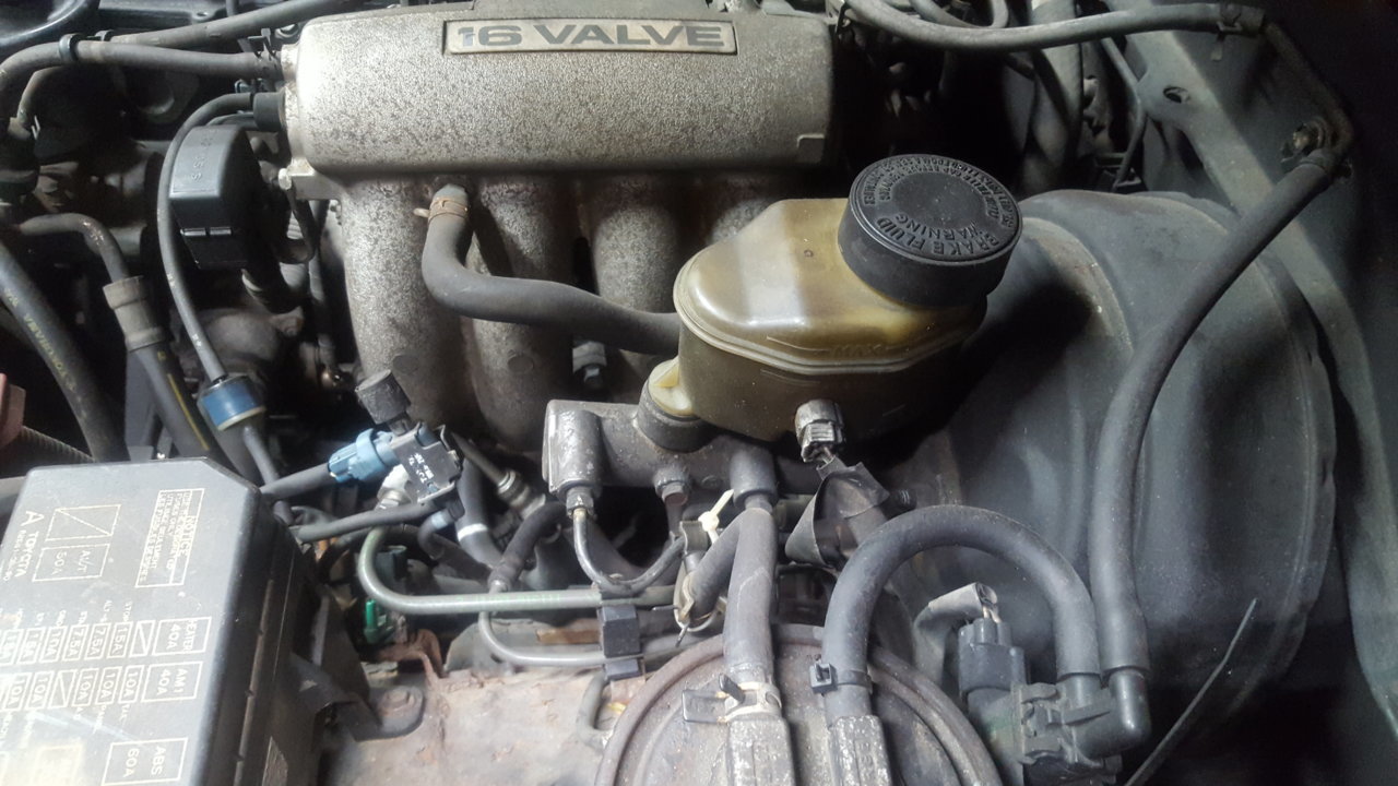

    My 1995 2.7L Auto without ABS, so not sure how much they will help. That creates some differences. In the last pic, ignore the fact that my ADD vacuum switch is hanging there out of place in the lower center. Original switch went bad and the racket was so rusted I left the old one in and the replacement is just hanging there.
    20180911_080053.jpg 20180911_080112.jpg 20180911_080128.jpg 20180911_080138.jpg 20180911_081410.jpg 20180911_081505.jpg

    Thanks for the pics.
    The tube next to the vacuum pot goes to the pot. I still have no idea where that plugged line goes.

    Do you still have the vacuum diagram sticker on the underside of the hood?
    The hose circled in red looks like a coolant line. The coolant goes to the EGR valve (1st hose), out of the EGR valve to the IAC valve under the throttle body (2nd hose), and back to a bigger coolant pipe (3rd hose). Every few months someone posts asking about these hoses, so try doing a search for more pictures.

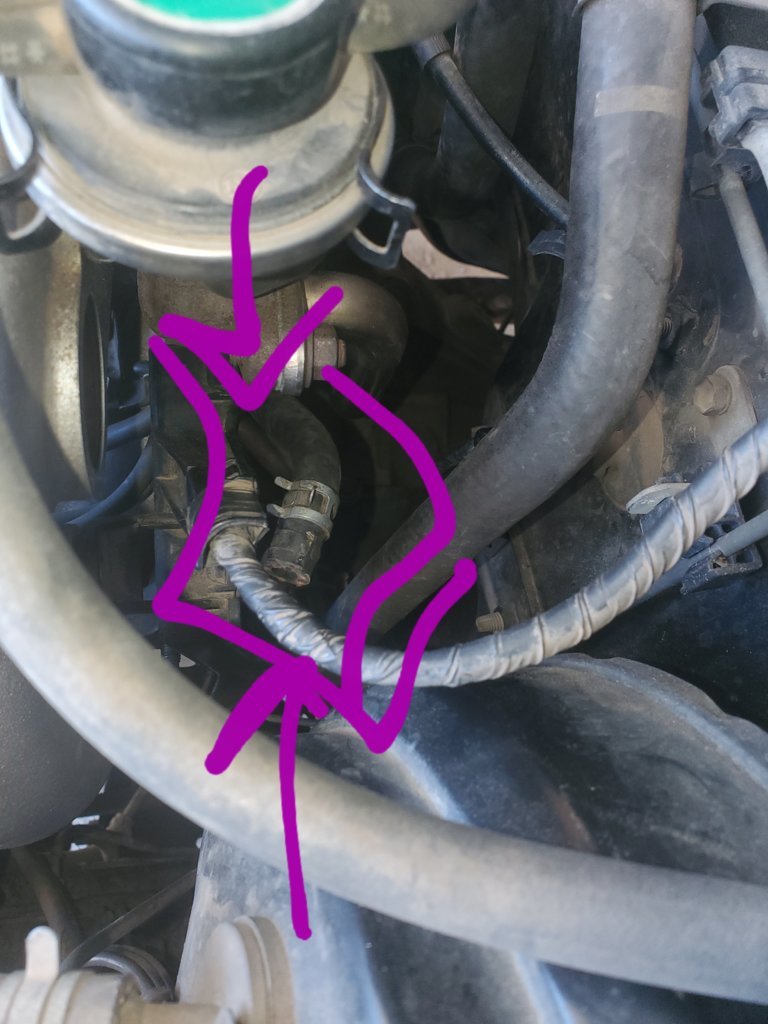

    Hello yall!!! This is sooo old but im having the exact issue with the hose circled in red. There is no coolant coming out of it, ive been flushing the system.
    Wheeerreeeee does it go????!?!??!?
