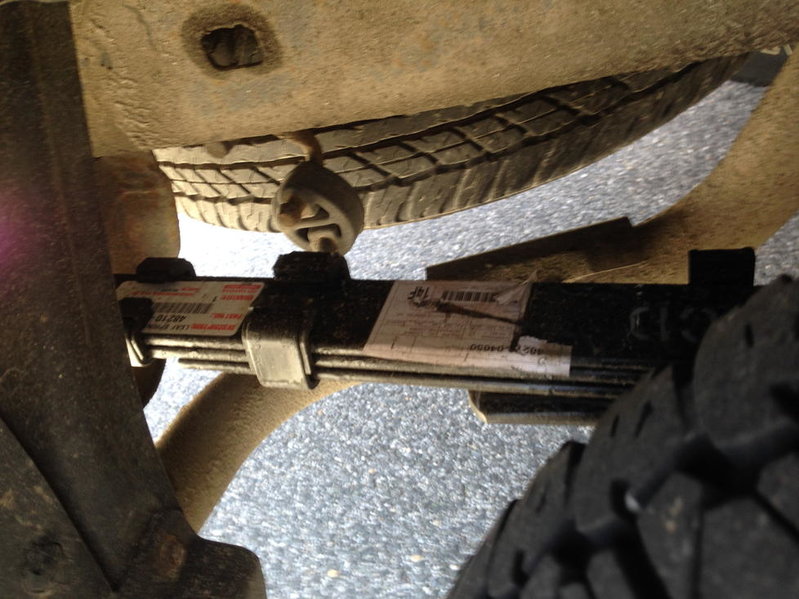

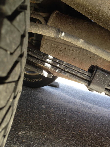

    one of my springs broke and i just got them replaced - has 1 more leaf than originals.
  10. Apr 14, 2015 at 2:14 PM
    #30
    AR15xAR10
    Apr 13, 2013
    #102024
    57,086
    2013 TRD Sport 4x4 V6 ACLBFTMFW
    You got TSBs then.
    Do they have four retention clamps or two?
  11. Apr 14, 2015 at 2:28 PM
    #31
    223440
    223440 Member
    Dec 1, 2008
    #11204
    13
    New Jersey
    08 DC SR5 V6 4wd
    Sirius
    Looks like just 2
  12. Apr 14, 2015 at 2:39 PM
    #32
    AR15xAR10
    Apr 13, 2013
    #102024
    57,086
    I see three which must mean you have four.
    In my studies, it seems like their new leaf springs have those four clamps so that when they break (thats right, i said when) they won't come loose and damage things. Leaf springs are a wear item and eventually break or sag. Seems like clamps is all they're going to do. But in the mean time, they're replacing the ones that break with TSB leafs that have four retention clamps.

    the ride does seem a little better.
    the bed looks like it is sitting a little higher too.
    maybe it will hold a half ton of pellets better.
