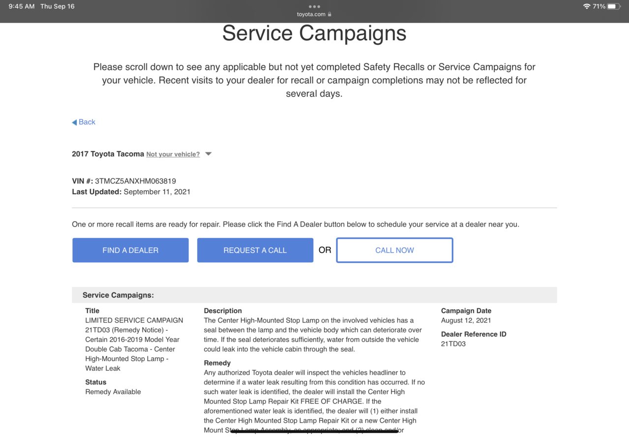

  11. Sep 16, 2021 at 9:48 AM
    minium
    minium Well-Known Member
    Dec 28, 2016
    #205885
    698
    2017 Inferno Tacoma TRD Off Road
    Use the Toyota Recal Website to check your VIN:
    https://www.toyota.com/recall
    I never received a notice but checked this morning, shows the recall as available. Also shows last updated Sept 11 2021, and the original campaign date was Aug 12, 2021 - so, fairly recent considering several people have had this issue since the 3rd Gen came out in 2016.

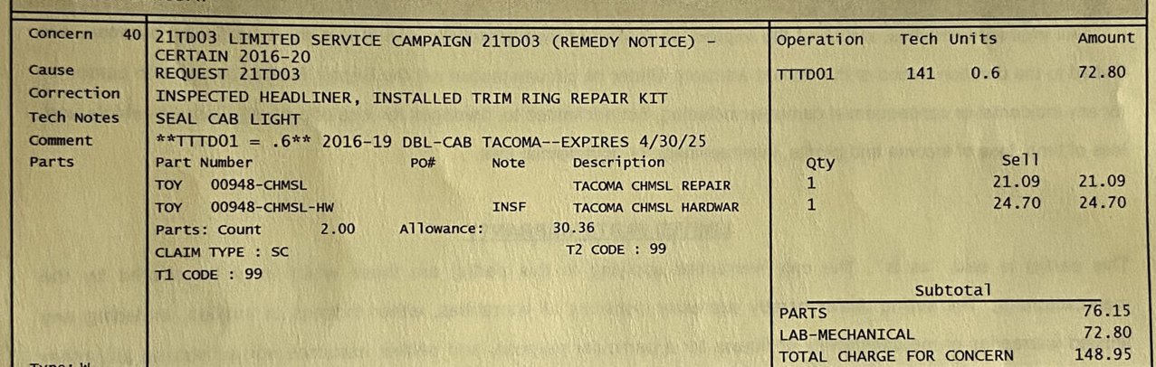

  14. Sep 16, 2021 at 9:56 AM
    mikesixtysix
    mikesixtysix Well-Known Member
    Jul 29, 2010
    #40947
    148
    North Jersey
    2018 TRD Pro
    i just had it done here in northern nj. didn't receive a notice but when i brought it into the dealer for regular service they mentioned it and took care of it. this is what they did:
