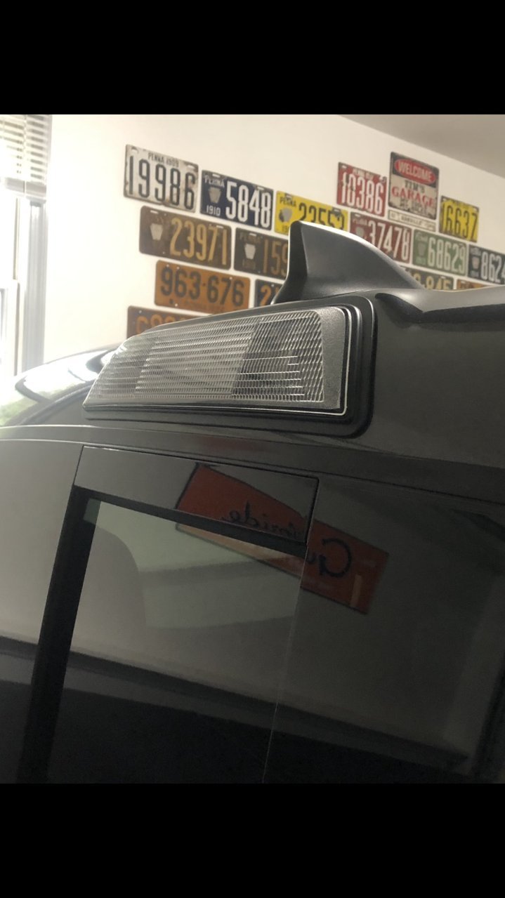

    The lens looks the same but not the rest. The bezel is huge on the new one.
    Old -
    yours

    They don’t replace the light, they run silicone around it and slap that bezel on. At least that’s my understanding as long as they don’t find a leak.
    If you don’t have a leak and take it in that’s what it’s going to look like when you get it back.

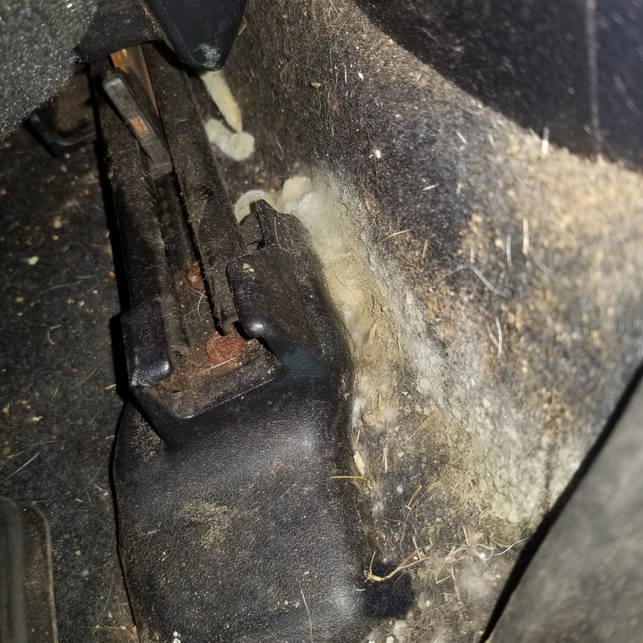

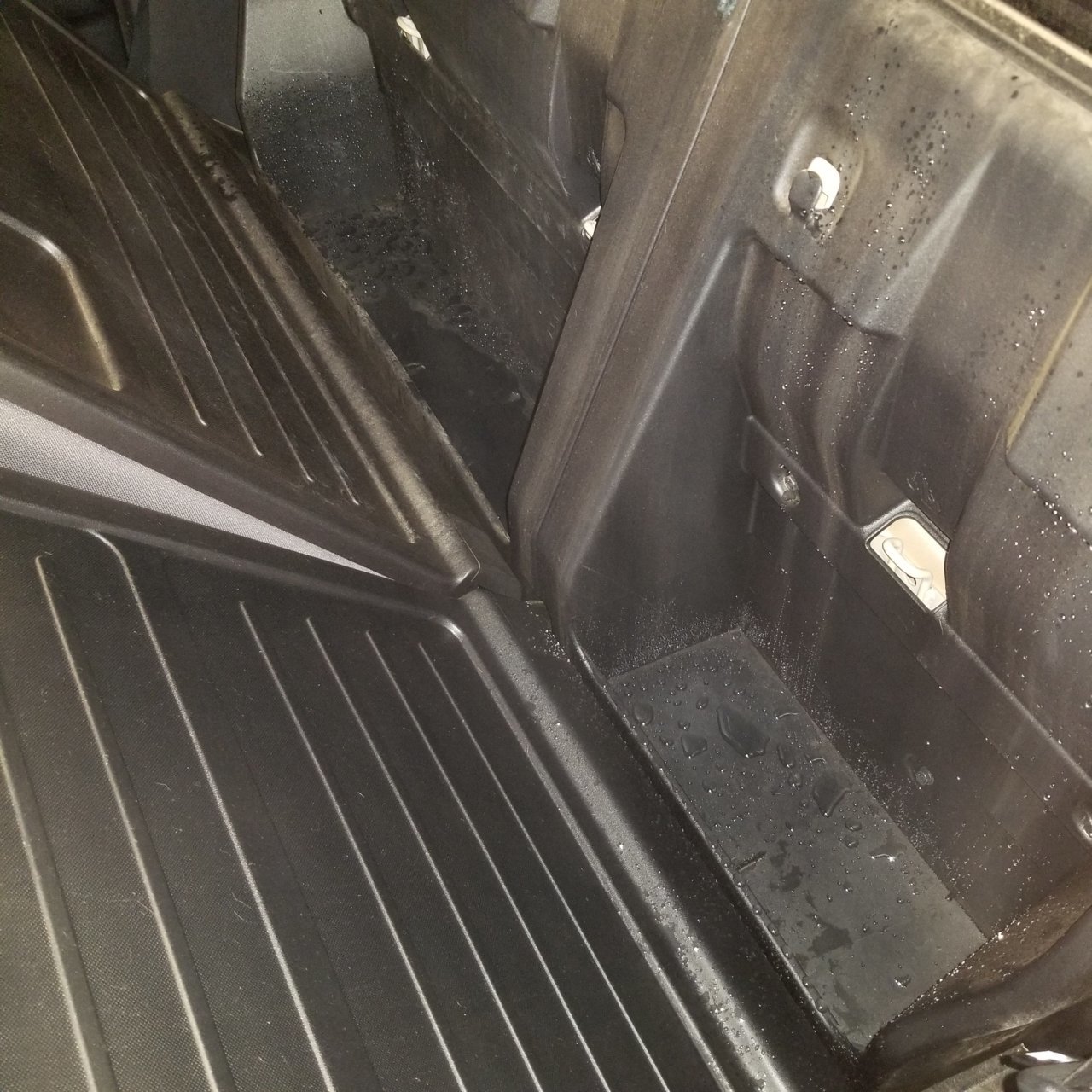

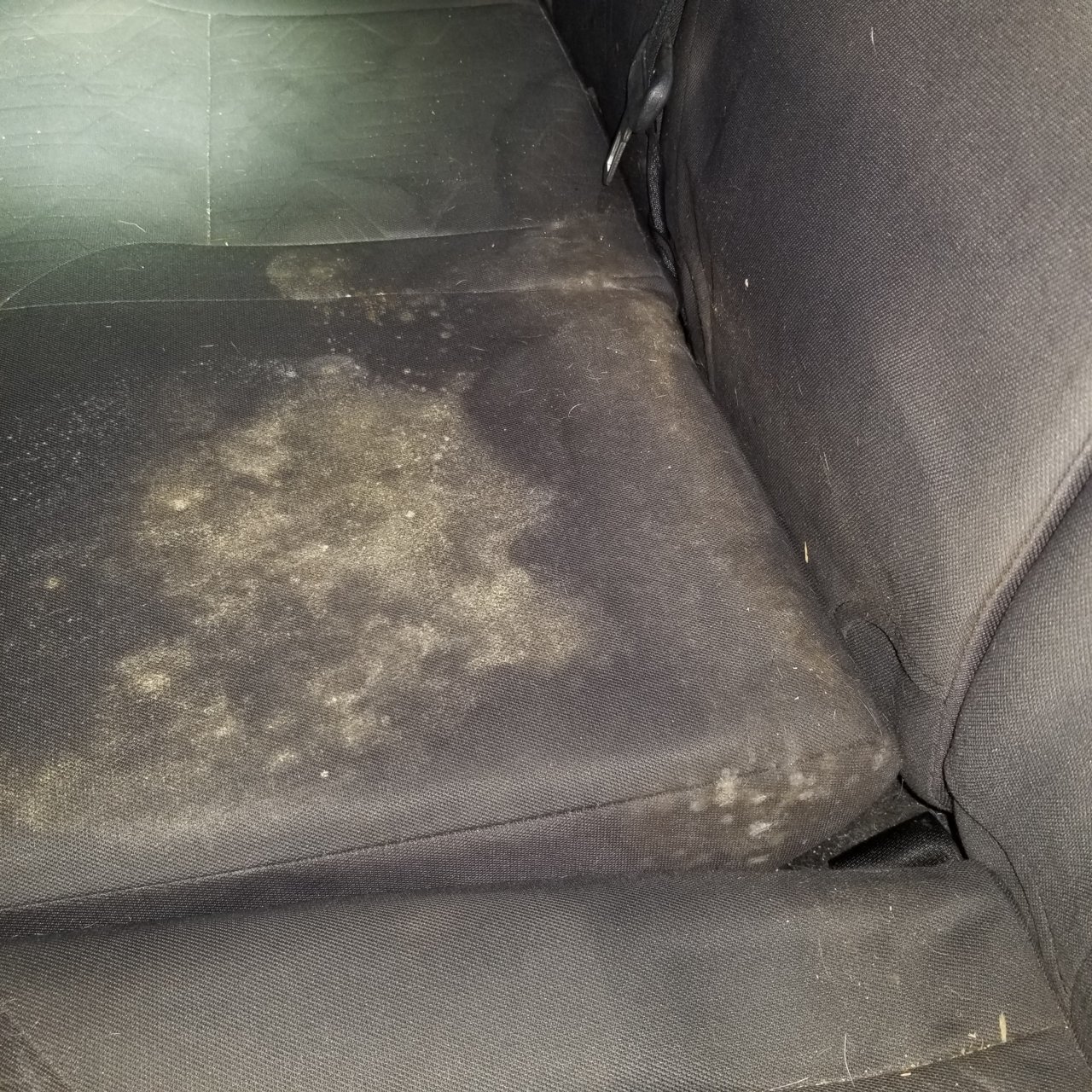

    I drop off my Tacoma tomorrow at the dealership, as I previously stated, it hasn't really been driving for about 6 months. in removing my stuff from my truck, there's legit stuff growing in the truck.
    It recently rained, so I went out there to see what was going on, sure enough, all the water was coming right in through the third tail light.
    I had my seats pulled forward so it wouldn't go into the seats, here's what that looked like-
    There are multiple electrical issues now. The AC won't turn off, and my LCD screen is all messed up.
