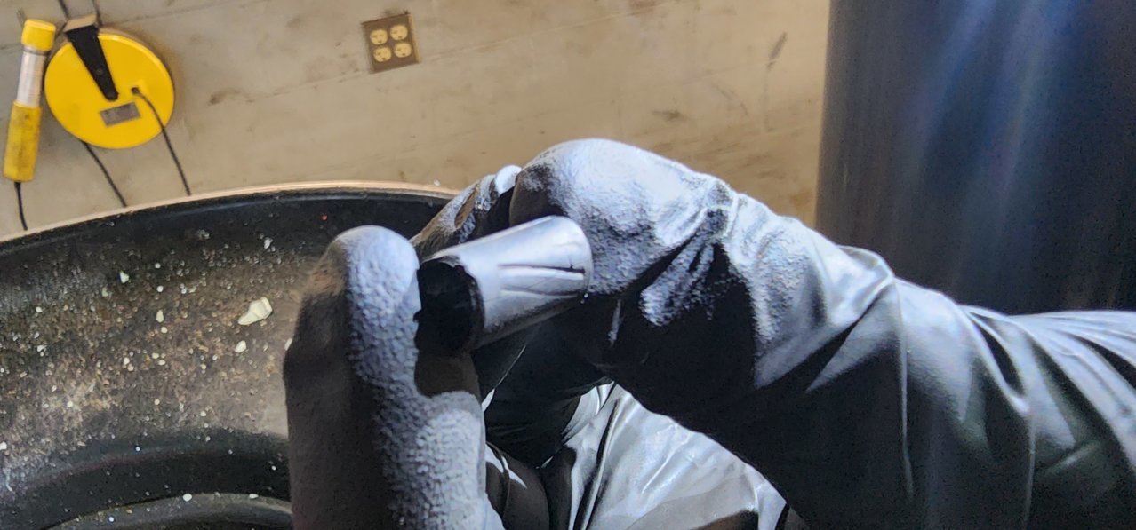

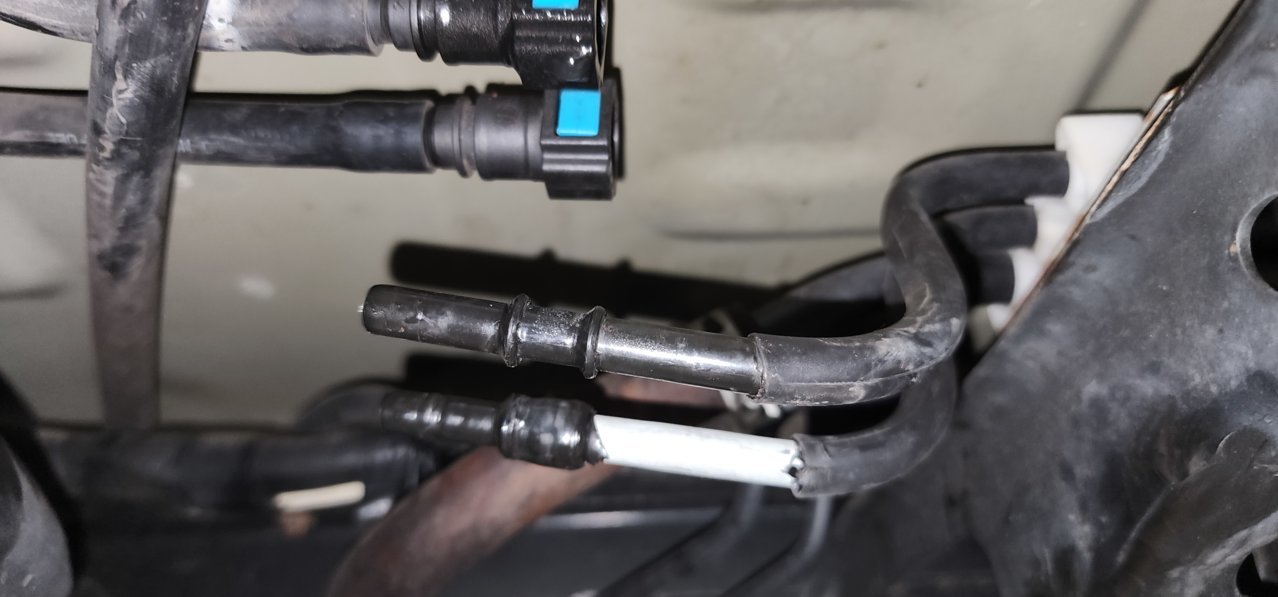

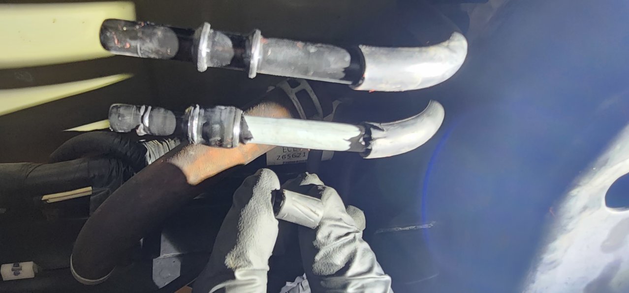

    The dealer which looked at the truck this past week is claiming the entire line has "swelled gaskets" due to connectors that were installed improperly using channel lock pliers that left marks in the plastic. They are saying that the entire cab would have to be removed from the truck! I can share photos if you would like...can't say I am familiar with this kind of repair. I appreciate your interest. Deano

    Sounds like they just don't want to do it. I could see the engine needing to be pulled, at most. And that's just to get to certain areas by the fire wall, assuming they can't get to them any other way. Cab removal is a bit excessive for fuel line repair, in my opinion. None of that was required to fix mine even though I couldn't physically get to the location of my leak due to all of the lines and other pieces in the way. Post the photos so we can see what you're working with.

  15. Sep 23, 2023 at 8:26 AM
    dherbert53
    dherbert53 [OP] Member
    Apr 22, 2014
    #128205
    11
    deano
    2010 Tacome
    I've posted a few of the (newest) dealer's photos above!

    okay, yeah the current dealer is right,,, the previous F'd this up something royal.
    I would take the safety tone here. Tell them to send a wrecker to pick it up, when they get done putting the clamps on the first dealer to fix this.

    Looks like the first dealer fucked up the fuel line and the 2nd dealer wants to replace the line which requires pulling the cab off.
