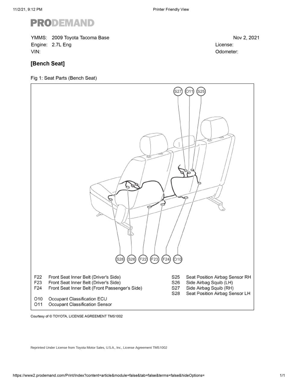

    Hi guys 2009 Tacoma base model (bench seat) Reconnecting the plug wires under the seat. I connected the yellow and grey wires, no problem but… what are the white plugs (the cable originates from the base of the seatbelt) and where do these plug in? Hopefully I didn’t cover up the male connections with the new carpet. Anyone out there that knows more about this? It is greatly appreciated

    Could be a prewired option that your truck does not have. IF you don't see any lights or hear a buzzer you should be good to go.

    I'm asuming your talking about the pigtail on the seatbelt buckle, it's for the Seatbelt Buckle Switch for the Airbag module although I can't find any connectors in the SRS System diagram that have a yellow and grey wire?
    Below is how the Airbag wiring should be routed for a bench seat, that's about the best I can do to help as I have a double cab with bucket seats.
