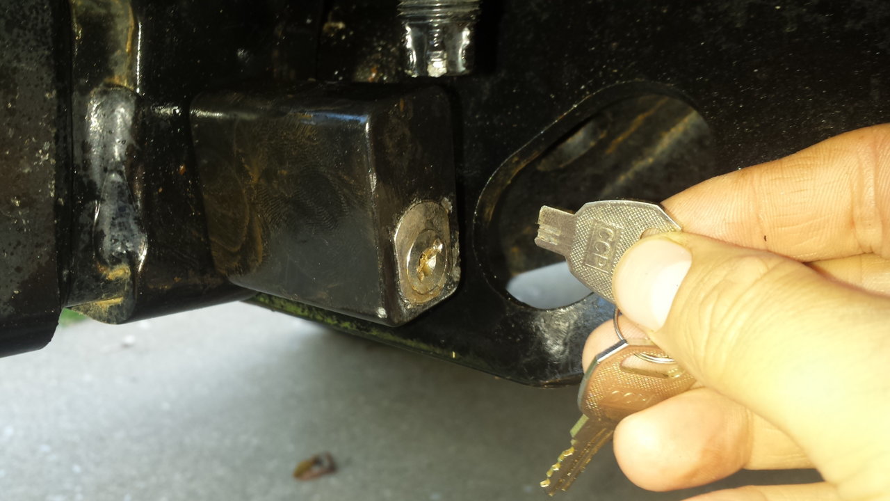

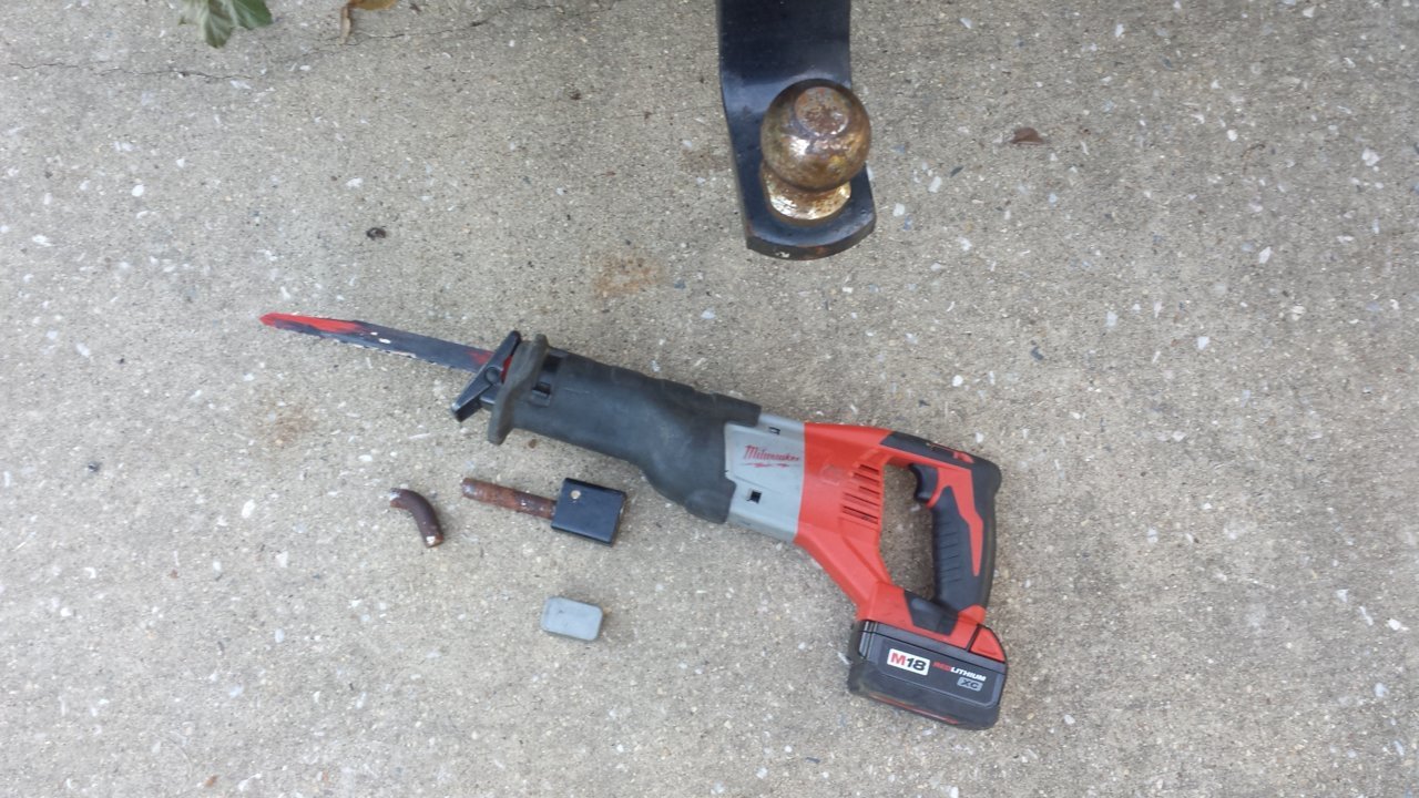

    Kept the cover on mine, but never sprayed it with WD40. Had to use a universal key for removal.

    I’ve had them seize up before and had to use the master key as well, that sucks. I just check it every so often and if it starts to feel tight a little oil and a few cycles of locking and unlocking loosens it up again. If it starts to get too tight I’ll just replace it.

    I had that happen. Lock seized after winter, and it was used occasionally to sway to a tow ball. Don't use them any more. But I also have an RCI bumper with the hidden hitch, so I don't keep anything in there unless I cam using it.

    I've walked into my own more times than I care to admit. Also up here after one good winter it's stuck in place if you don't remove it.
