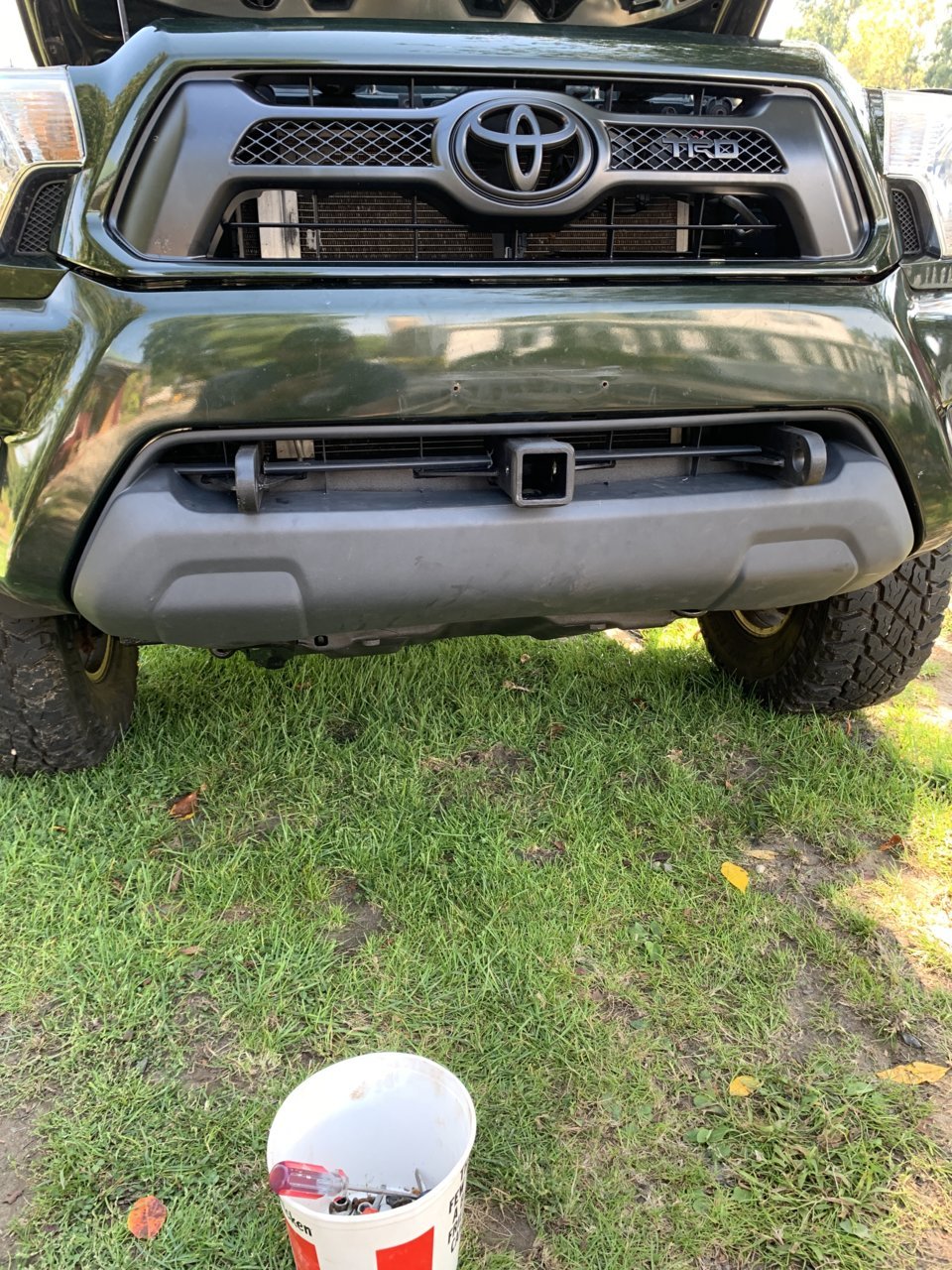

    Holy thread revival @qnyla !!!
    I'm wondering what you used to add that front receiver to your ARB bumper.

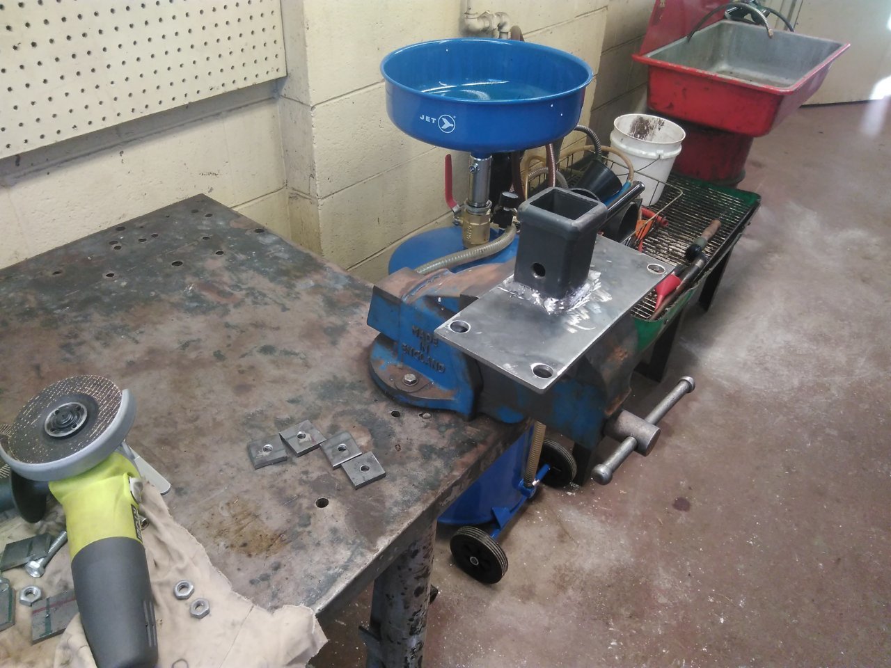

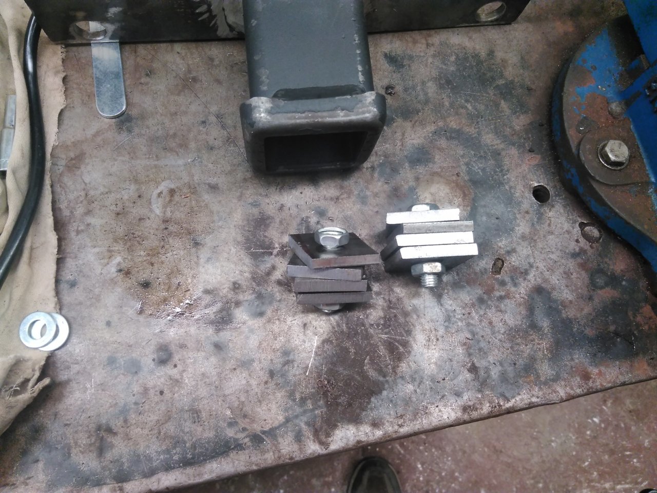

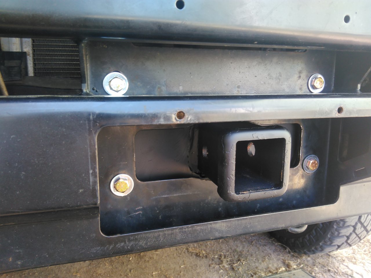

    @tacoma16 made this for me. Some spacers, nuts and bolts. A thick plate and the 2" receiver.
    It mounts to the already existing holes, no changes to the bumper. Other than slightly enlarging the opening for the weld around the base of the 2" receiver.
