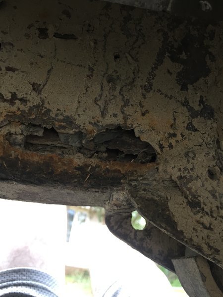

    i recently purchased a 2002 TRD Off Road 3.4 MT with 144k for $8500. Everything works flawlessly, but then I discovered something I missed while buying it, frame rust by the passenger leaf spring mount. Toyota is calling me back Monday to discuss options with me, but do shops repair issues like these?

    I've heard of a few members that had their frame welded and repaired. But I think it's pricey. But yes, there are shops out there willing to do it.

    Being a 2002 though, your frame recall should last up until 2017.

    Thanks for the quick reply.
    The truck was sprayed for rust, so I have a good chance of a new frame. Mainly just don't want to be without my truck for months.

    Quick update: Just got home from a weekend trip and decided to give the frame another good look. I've decided I don't feel comfortable driving the truck. I can push on the bottom of the frame where it's rusted through and visibly see the frame moving. The truck is gonna sit in my yard until Toyota tells me to take it to get inspected.

    Ok so Ohio is on the shit list, that's good. Now hopefully one of the previous owners paid attention to the notice from Toyota and had the anti corrosion spray done. If they did, it's covered 15 years past the "in service date". Which would cover you until 2017 POSSIBLY earlier depending on build date.
    If they didn't, you're not gonna be happy...did you get it from a dealer or private party?

    Private property. The truck was sprayed (at least that's what Toyota told me on the phone)

    Thank GOD it was sprayed... Now we wait.
