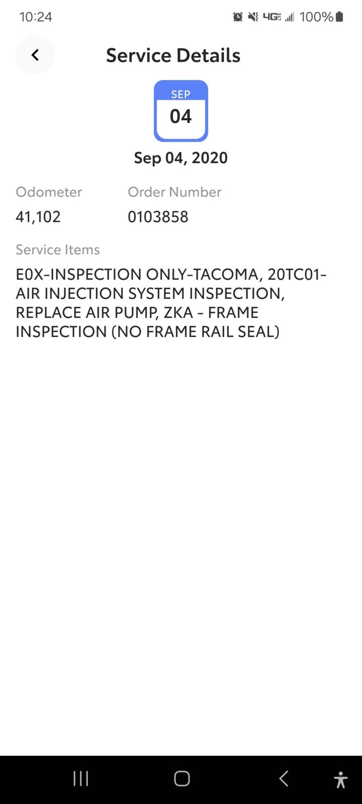

    FleaBoy
    FleaBoy [OP] Member
    Apr 11, 2024
    #447720
    15
    2012 Tacoma
    So I created an account and checked the maintenance history and found one that says replaced air pump. Not sure if that is the fix but I will look into it.

    #20
    Schlappesepple
    Schlappesepple Well-Known Member
    Jan 9, 2017
    #206998
    926
    Joe
    2020 4Runner ORP
    The "action" was to replace it if it failed; they didn't really address the root cause as far as I know.
    So even if the pump has been replaced, I'd still do the Unifilter mod.
