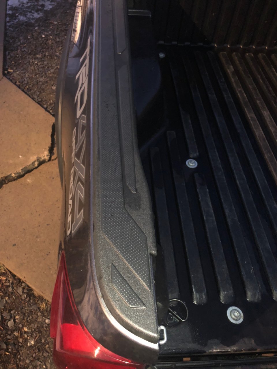

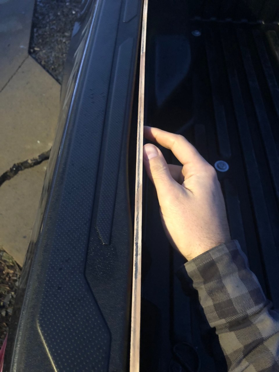

    After i took it in, they worked on it for much longer than they did during initial install. finally they realized what they saw as a major design flaw. Tacomas have the little curve at the end of the bed, by the tailgate. as seen here
    the rails for the cover seemingly did not address this curvature. i used a yard stick to try to illustrate.
    the issue was that if they tightened down the rail, bending it to seal tight against the curve, then the latches on the cover would not meet the rails. however if they left it straight, then there was the huge gap when the rails would not even meet the bedrail, so there was no seal at all. They tried jamming various materials in there to get the rails to seal properly but they were not satisfied that it would stay dry, so they just refunded my money. I was pretty pissed, I've been waiting on this model to come out ever since they discontinued the X2T cover. It was such an obvious flaw, i was floored how Leer would release a product that was that poorly designed. The guys a the factory outlet were also dumbfounded when they realized how bad it was. they were also embarrassed that they did not notice when they first installed.

    This all went down this past Friday. They said they were going to stop offering the Tacoma model until the issue was corrected and the covers were redesigned. So the guy called corporate on Monday, and as it turns out, Leer actually does address this issue by way of an independent seal that was made specifically to address that curvature. It was supposed to be in the box with the cover but it was not. Because I was the first Tacoma install, and the previous X2T model did not have this separate seal, the installers did not know they needed to use it. So i am going to go back soon and give it one more chance. I want to take a look at the seal, and watch them install it very carefully. They assure me (because Leer assured them) that the seal will keep the bed dry, as it was specifically designed with the curve in mind. If i don't like how the install is looking, i will tell them just to forget it, or if they do install and it still leaks, i will definitely return it and let my voice be heard. So...i recommend you wait a couple weeks to see how my install goes, and i will report back as soon as i have some data. I will be the guinea pig i guess.

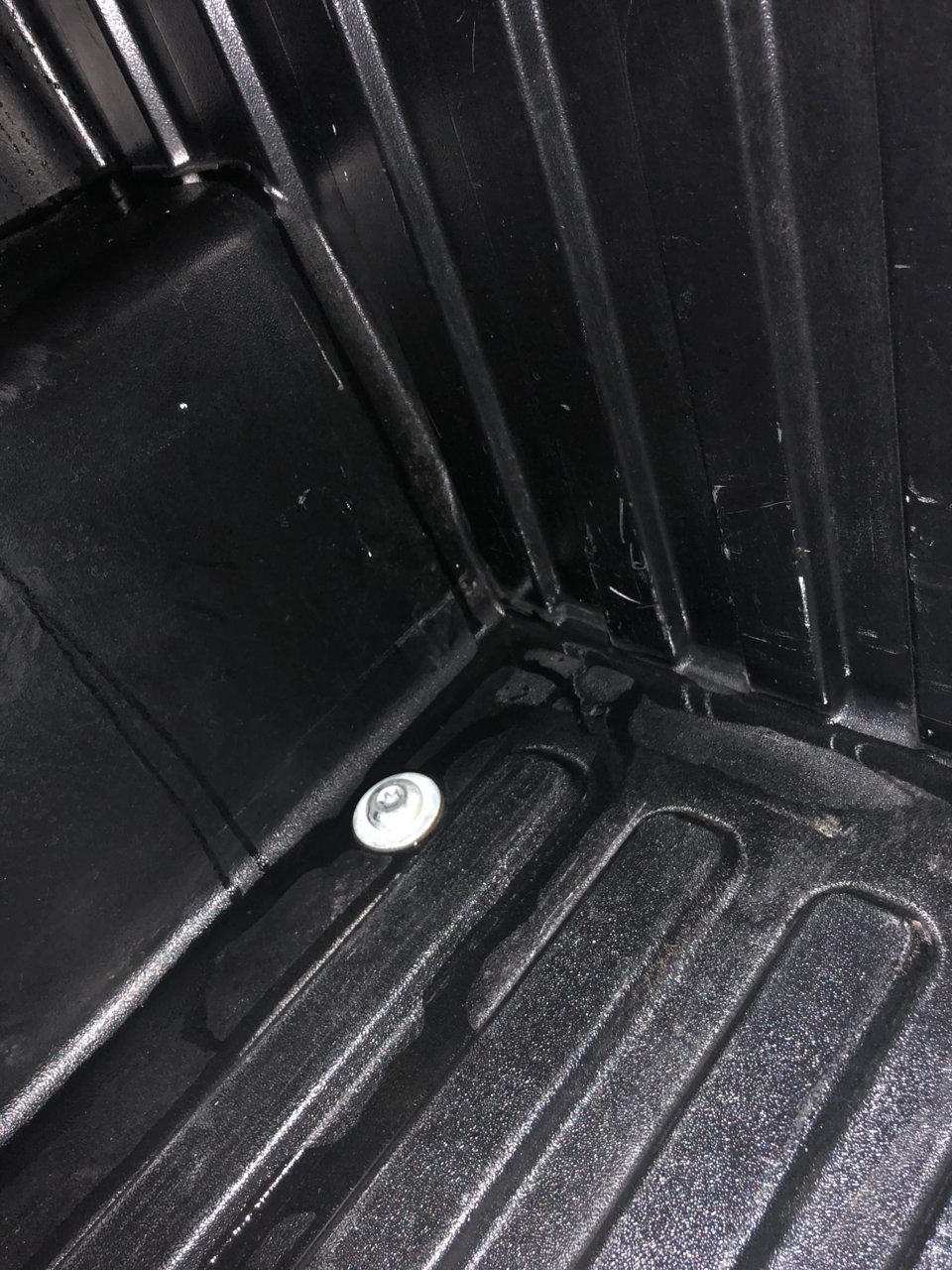

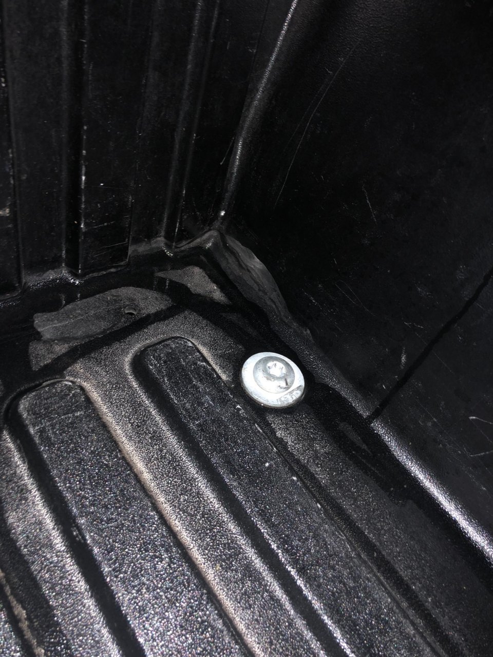

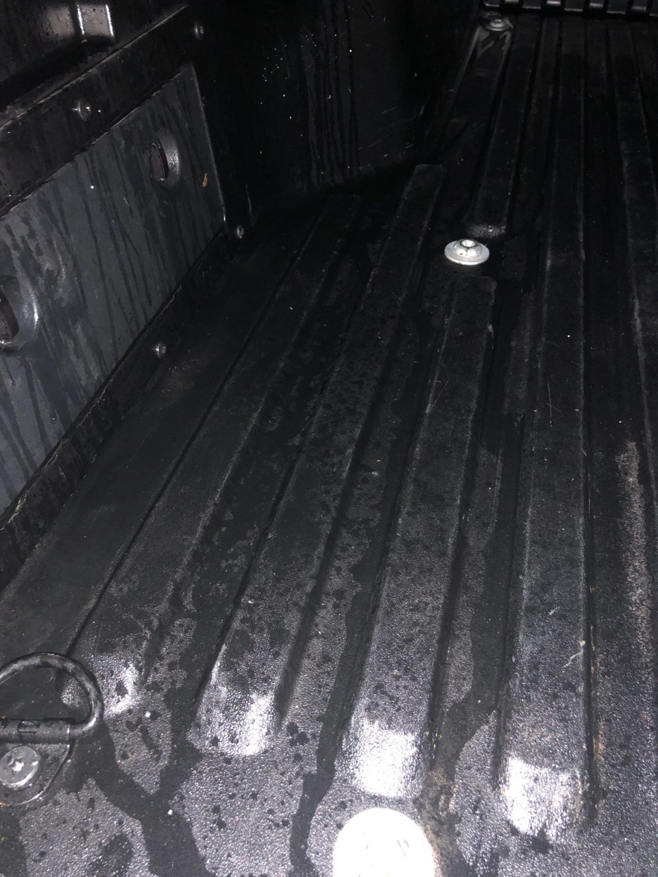

    so the seal came in, they installed. and within an hour of driving home in the rain, i had a fair amount of water in the bed. so i am going to have to give this cover a thumbs down, from a weather resistance standpoint anyway. there were a couple of points of infiltration i attribute to minor install mistakes, but the "seal" that they claimed was meant to account for the curve in our bed was an open celled foam type product. i did not get a picture of it, but it was about an inch or so wide, and 5 feet long. the idea was that it would compress more where the bed curved, and a little less everywhere else. it was made of rubber, but with the open cells it was basically a sponge. their thought and my hope was that after it was compressed and the rails were tightened down it would seal itself up but it did not. I am actually floored that an engineer at leer (presumably with an engineering degree) would think that this type of "seal" was the answer. now it wasn't a ton of water. it was better than my OEM was, but it was still enough to pool and run anywhere in the bed that happens to be downhill, which is too much for me. i understand trifolds are not going to be 100%. some drips here and there, or perhaps some moisture in one corner or another that is not enough to really run...i could accept that. and given that last night wasn't even a heavy rain, i think i am going to just move on and return the cover. a few pictures to follow...

    here's just a couple pictures to give you an idea of the amount of water. again, it was fair rain for few minutes, then it lightened up a bit. by no means a heavy rain.

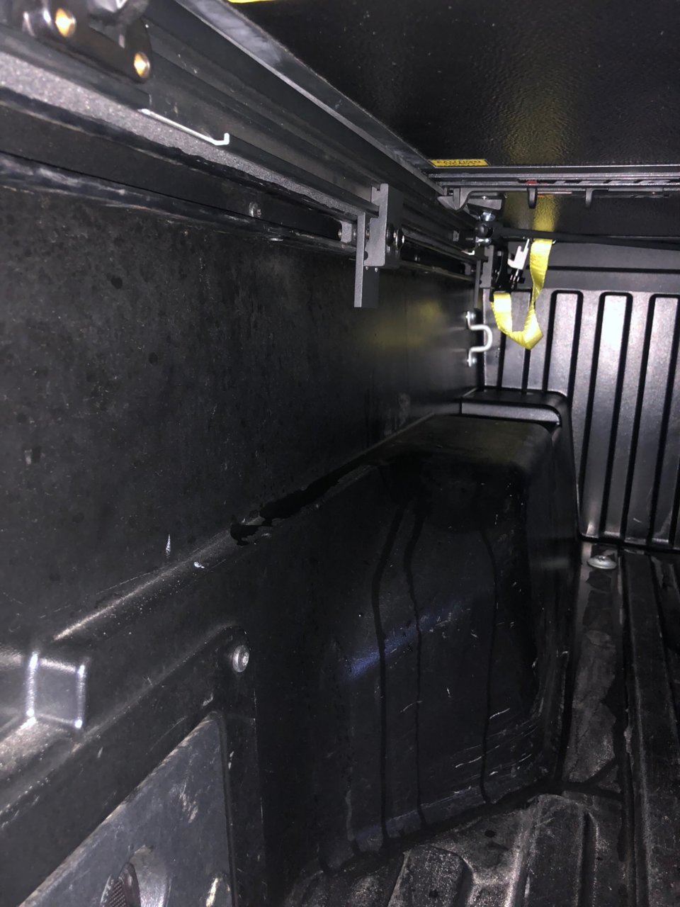

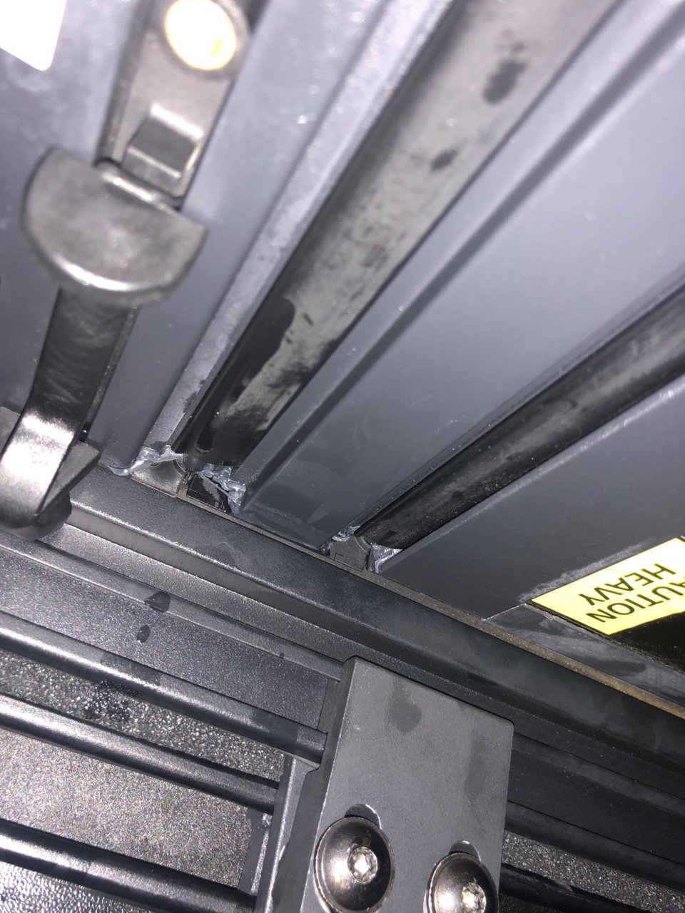

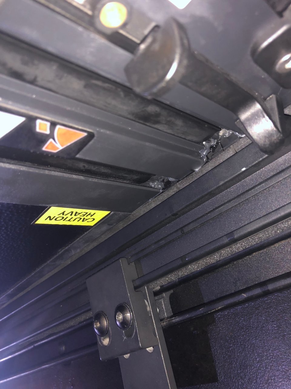

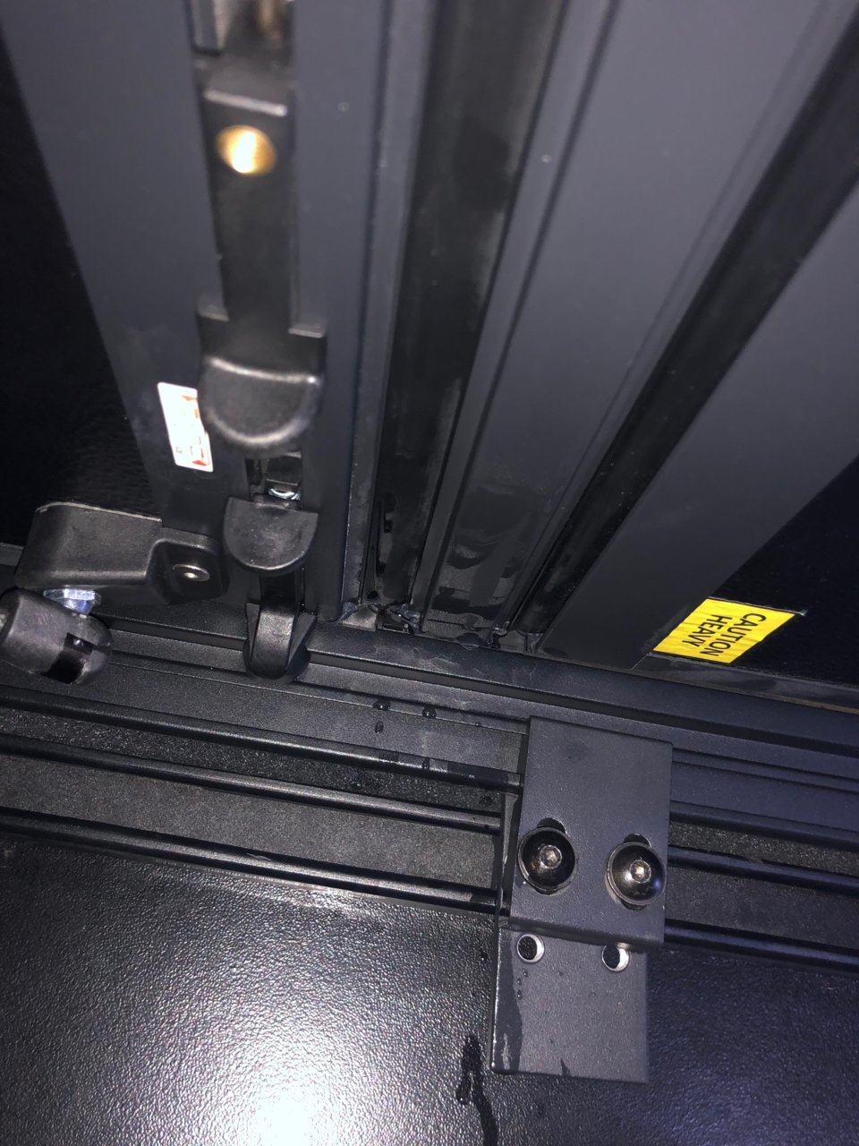

    what was the most concerning infiltration point was below. it was dripping from the under side of the cover itself, and if you zoom a little you can see silicon that was applied at the factory. so this was an obvious point of concern for them since they thought to silicon the area, this flat bar that you can see a drip clinging to, was damp most of the way across the cover, so water may have been getting through the joint. you can also see the "seal" that they thought was the answer in these pictures. its the grey foam looking stuff between the utility track and the cover rails. IMG_0963.jpg

    Just some further updates. I was able to get the rails and the corners pretty much sealed up so that no water came in around those spots. But once I was able to observe the cover during a rainstorm, I saw a bunch of water dripping in around the joints, where one panel connected to another. I decided to return it since it still let in too much water for my needs. Leer was pretty cool about the whole thing. They used my pictures and comments to take to their corporate engineers and I am told they are actually pulling this model for Tacoma installs until they can re-engineer the rails, and some of the issues I pointed out. I moved over to the Undercover Ultraflex based on some recommendations that I got here on the forum. Had it installed on Friday so I will update this after I have some time to live with it and it goes through a few rains.
