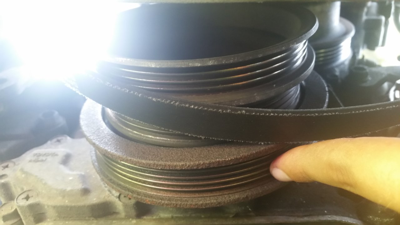

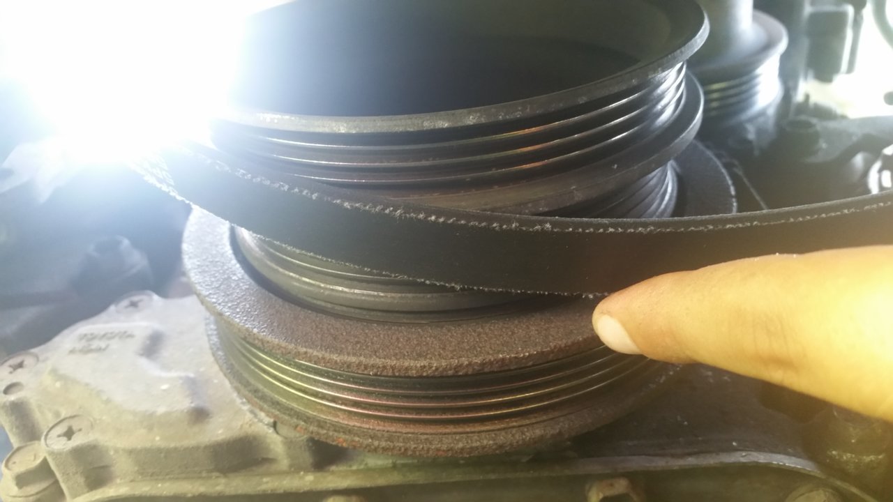

    Here is the real reason for the update; While switching out the belts I noticed one of the pulleys/rotors has a LOT of play. Free floating where I could move it and spin it around with a minor pressure (if I shove it back toward the vehicle and engine I cannot turn it but as soon as I pull it forward it free floats. This is the last pulley on the 3 pulley system (crankshaft?) and the same pulley which hooks up with the belt going to the alternator. I've attached two pictures (taken from below) to show some of the play (center line of the photo) in the pulley and identify the part in question. Touching the specific pulley.
    The other two pulleys are completely ridged with no play at all. Is this normal/supposed to move (could not find on google or youtube)? If its not supposed to move and free floating I could speculate if the (crank shaft?) spins and the pulley slips> belt would not turn as fast or consistently> alternator not turning as fast or consistently> diminished flow of power and recharge AND may appear intermittent.
    Photos below pointing to the pulley in question along with some of the play. Thoughts?

    I think that's the fan pulley? And yes it shouldn't have that much play

    Does the fan bolt to those pulleys? If not then its the ctankshaft pulleys? Thats not good.

    Nope, fan is separate on this engine. I think its a difference in engine size (liters) based on a few youtube videos of how-to "X".
    This is my thinking, if I cannot spin the pulley freely then I'm sometimes getting a charge (pulley sitting back). Then over time if the pulley drifts forwards I get more slipping and less recharge but its a hit and miss of the day causing unknown and intermittent issues. This could also explain why a perfectly good belt with no signs of excessive wear may split in half. If the pulley slides forward and the belt is holding it back this could cause faster wear ending up in a split.
    I don't know much about vehicle repair other than the few things I've done but I'm thinking this may be the cause of my issues... Short bit of googling I think is an 'alternator pulley' as I have 3 belts and none attached to the fan. Should get me in the right direction at the auto store. Now how much and who has a fence I can paint for some $$?
    Other thoughts on this?

    Oh it's the back one that is loose. That's the harmonic balancer for the engine.
