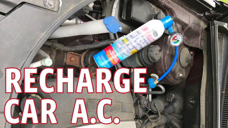

    This is a simple job that believe it or not many people do not know how to do. Recharging your truck AC refrigerant is one of the better low cost truck improvements you can make.
    This video will take the novices through how to do it. Read the instructions on the can carefully because they are not all exactly the same. The one in the video also has some oil and small leak sealer.
    Please subscribe to the youtube channel
    Watch Video HERE
