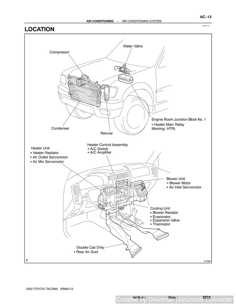

    So there are tons of videos on replacing the blend door actuator but I haven't found any on the recirculation door actuator. Anyone know where it's located, any diagrams?

    It's called the Air Inlet Servo, looks like you need to remove the glovebox to access it.

    Thank you, much appreciated!!
