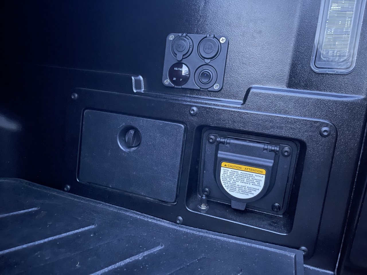

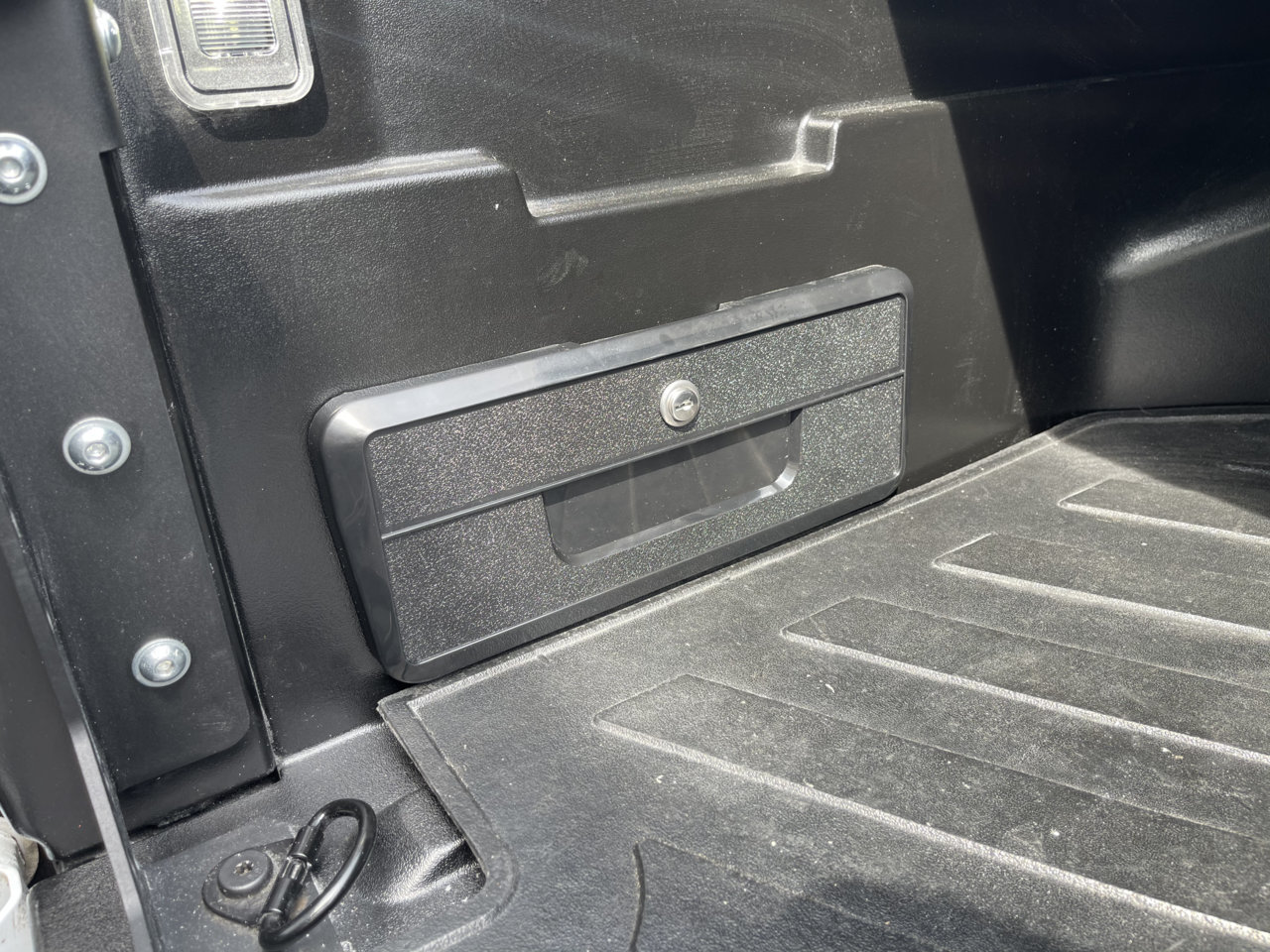

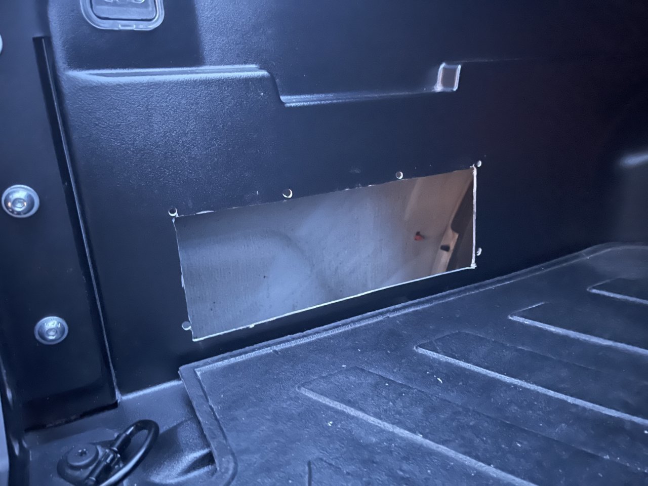

    Came across this post last week and talked myself into needing the extra storage. :rofl:Bought the lockable box off Amazon for $40. My wife and friends thought I was nuts for cutting up my bed :crazy: And While I was at this I also decided to add in a power port on the opposite side. I think it all turned out perfectly!!!

    For those cutting into the bed. I recommend using a drill bit at the corners to get them round.
    Cutting them square will create stress risers. As the bed flexes they will be prone to cracking at the squared edges.
