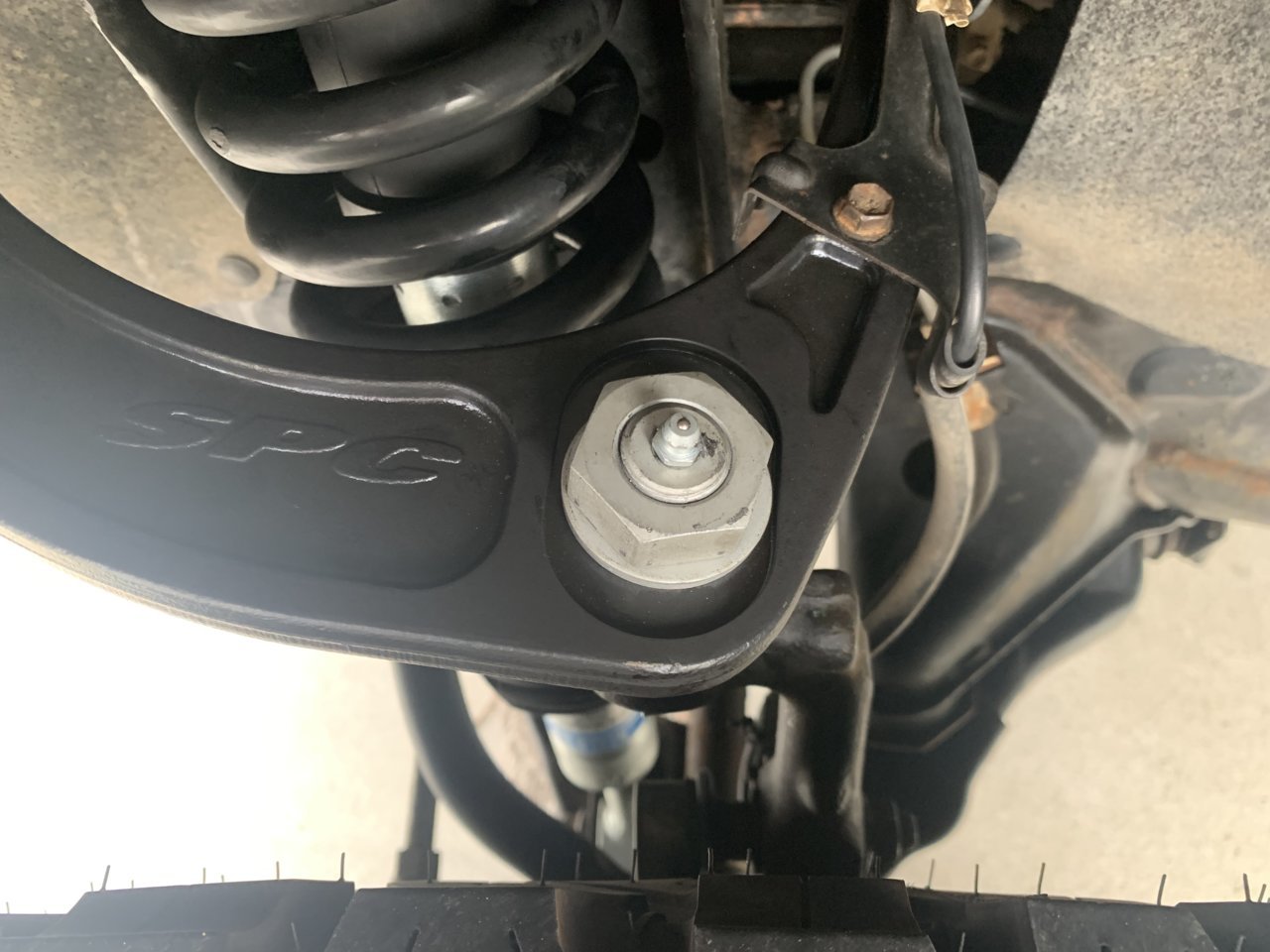

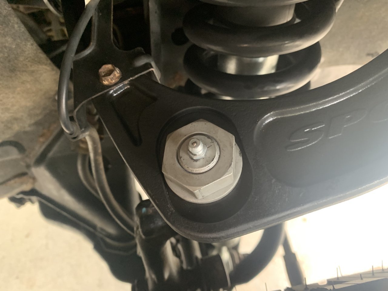

    thanks @SUMOTNK and @Michaelo for the leads. I will be sure to give them a call and explain the situation. when you say outmost position, this is on that huge 32mm adjustable but right? and by sliding outmost, would that mean towards the outside of the car, because that would give a ton of positive camber no like \ / i think if you slide it towards the car then that would give you more negative / \ camber. I'm aiming for no camber so I slid the 32mm nut right in the middle. not sure if thats right or not, but its not too bad on the car. i definitely need an alignment bad though. Wheel Works in prospect is closer to me than san jose so ill likely try them first with a call
    @Michaelo how did you set up your UCA prior to handing it off for alignment? Where was your 32mm nut in approximation.
    Also, i used to take my prior cars (s2k, sti) to Auto Innovations in miliptas, but wasn't sure if they did lifted trucks but wouldn't hurt to ask them if they can mess with the SPC UCA.
    Here are what mine looks like:

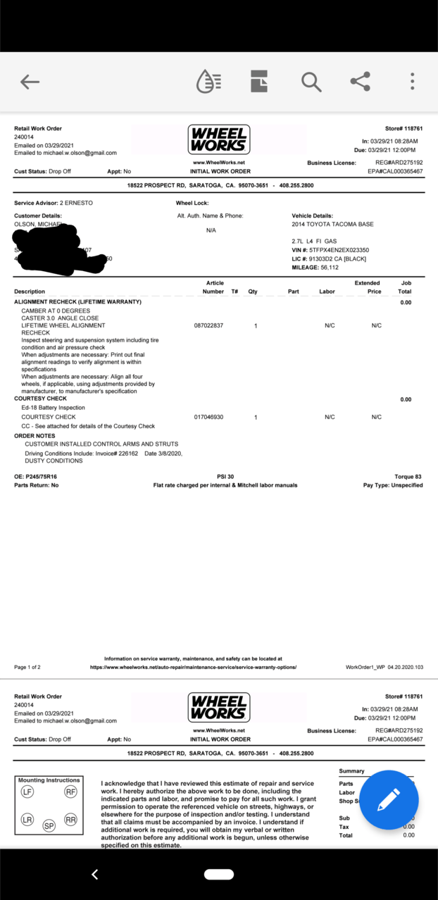

    I set it on "d" and the nut was about where yours is. They actually moved the adjuster to "c" without me telling them anything about the spc uca when they did mine. My LCA bushings were shot at the time though so that's most likely why.
    I can't find the sheet but here's an invoice if they give you crap.

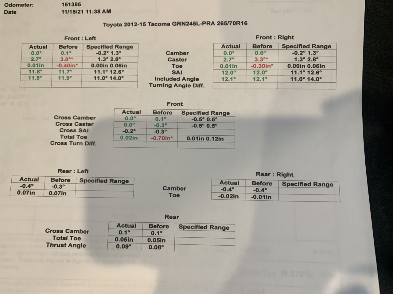

    Just got back from Auto Innovations and Orlando was able to set me up. In case anybody else needs another reco for them, here it is. Just a bunch of great guys that know what they're doing and take care of your car like it was their own. My tire spec is actually 265/75/16 so ignore what it says at the top. This was with the SPC upper BJ at the "D" position and the camber slider in the middle.
