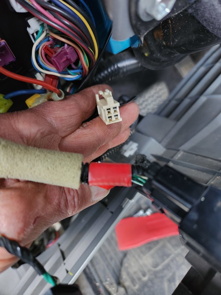

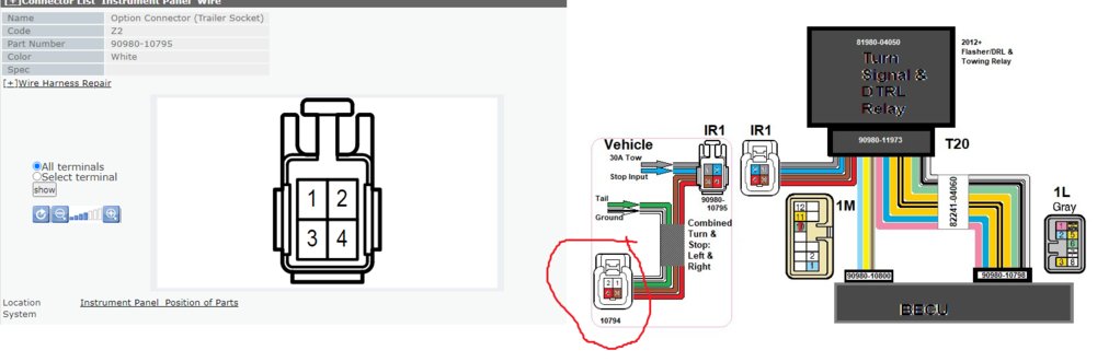

    20250201_163055.jpg Does anyone recognize this connector? It's behind the lower dash panel to the left of the steering wheel.

    Wire colors are?

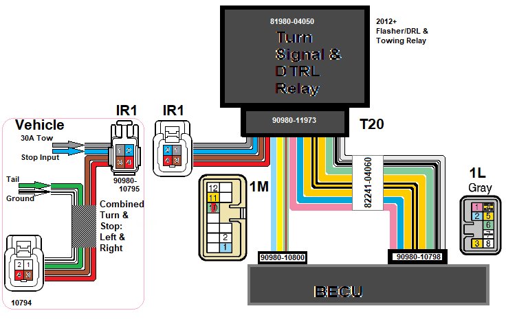

    Wire colors would confirm but I believe that is Connector IR1, it is half of an inline connector for part of the trailer tow package wiring.

    I can check wire colors tomorrow, but this is a regular cab with the 2.7L 4 cylinder engine. Definitely no tow package. Could it be just part of a standard wire harness, whether you get a tow package or not?

    Yes, manufacturers often do this as it cuts down on the number of different wiring harness configurations they need to produce.

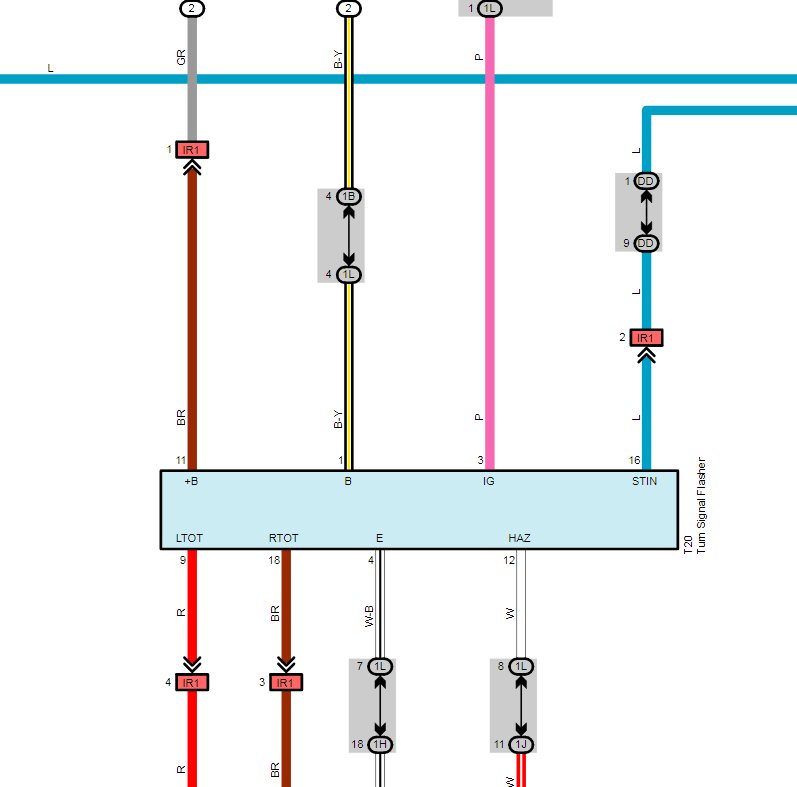

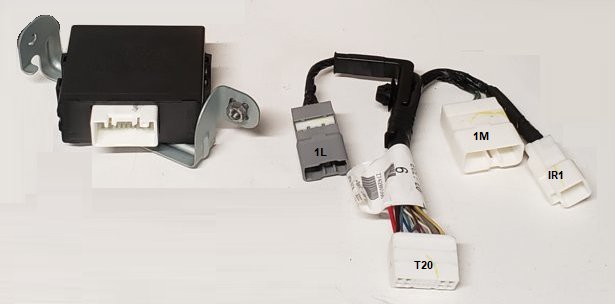

    Not exactly:
  8. Feb 1, 2025 at 7:08 PM
    caribe makaira
    caribe makaira Well-Known Member
    Feb 13, 2011
    #51121
    11,782
    Caribbean, Puerto Rico
    05 PreRunner TRD Offroad AutoTrans
    Hood Struts, My version Fogs always ON, Map & Overhead Light Mod,

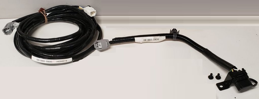

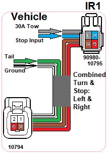

    It provides a source for a missing harness to add a basic 4 pin towing connector:
    It seems to be the vehicle side to the towing/turn relay.

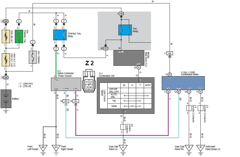

    Interesting, I didn't know there was a kit like that.
    I guess that's what Option Connector Z2 is for as well?

    Z2 is on earlier Tacoma's, but yes, for same 4 pin towing harness.

    Even 3rd Gen SR have it. (Z4 designator)
