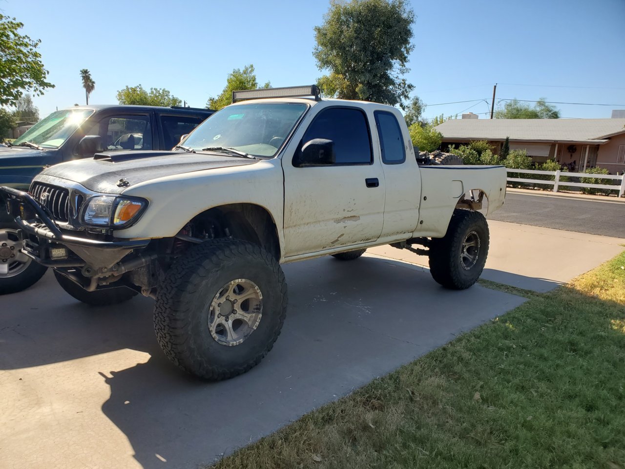

    Zuk ftw!
    For another perspective, I have 1st gen V6 auto, 4.10s and 33s. Thing was gutless going up any grade. Added boost and it was much better, but I knew ultimately all of it had to go through the transmission. 4.10, auto and turbo felt great and could easily spin the tire.
    Today I put a 4.56 rear diff in and it was very noticeable. Truck accelerates very easy without spooling the turbo as much. If i was N/a i would probably consider this option, but 4.30 would be a little better on highway.
    So I tossed some 35s on it and feels great now. Little quicker than the 4.10/33s, and not as quick as the 4.56/33s. Very happy overall. Now I need to slap the front diff in and clearance the wheel wells.
