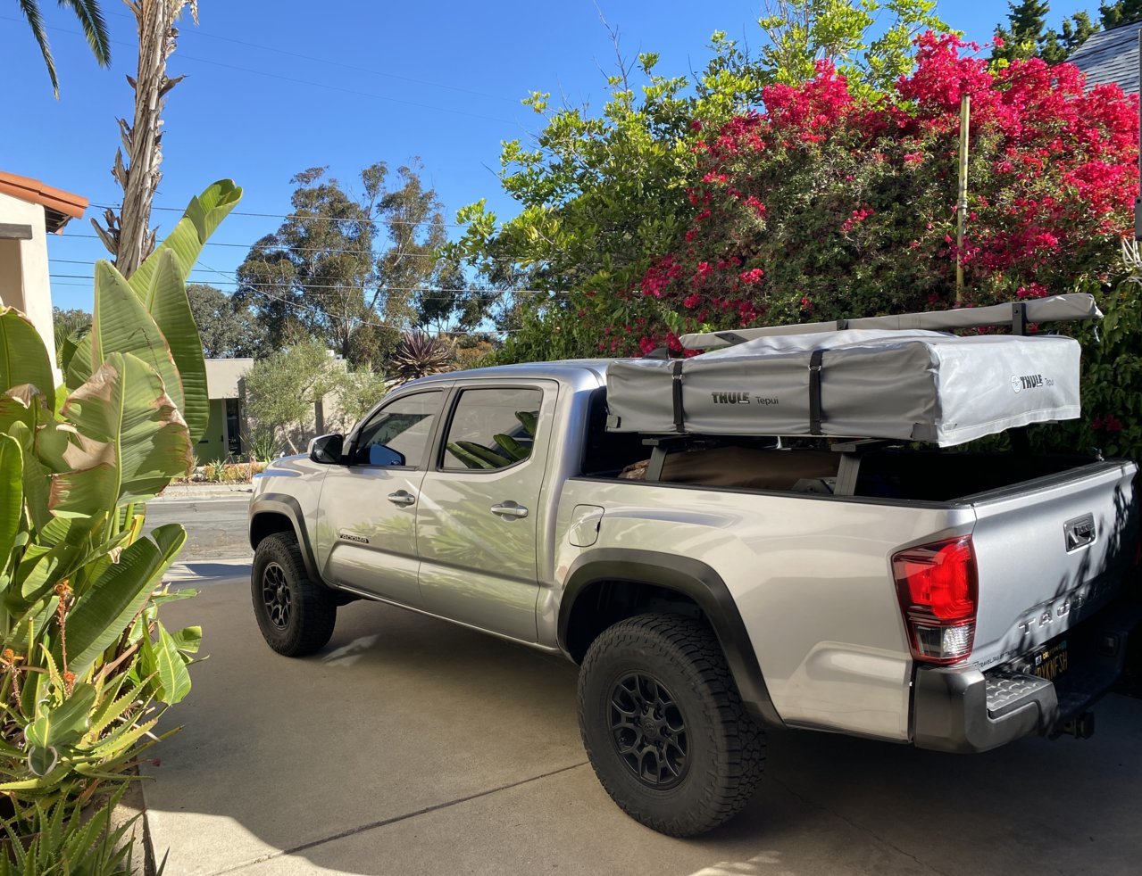

    I used a 3 leaf Progressive AAL from Icon and it is great. Holds my tent and gear with little sag Slight rake without gear. 1" front lift (5100's) and 1.5 rear with AAL. Easily 500+ pounds fully loaded for camping. Good luck. https://www.youtube.com/c/TravelingbyTacoma

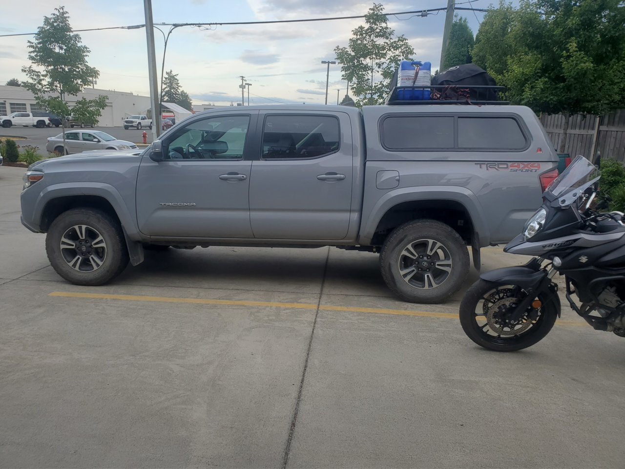

    3 leaf AAL from wheelers, with overload left in.
    happy with it, rides great! If i had to do it all over again I would look at full leaf packs, and give them more consideration.

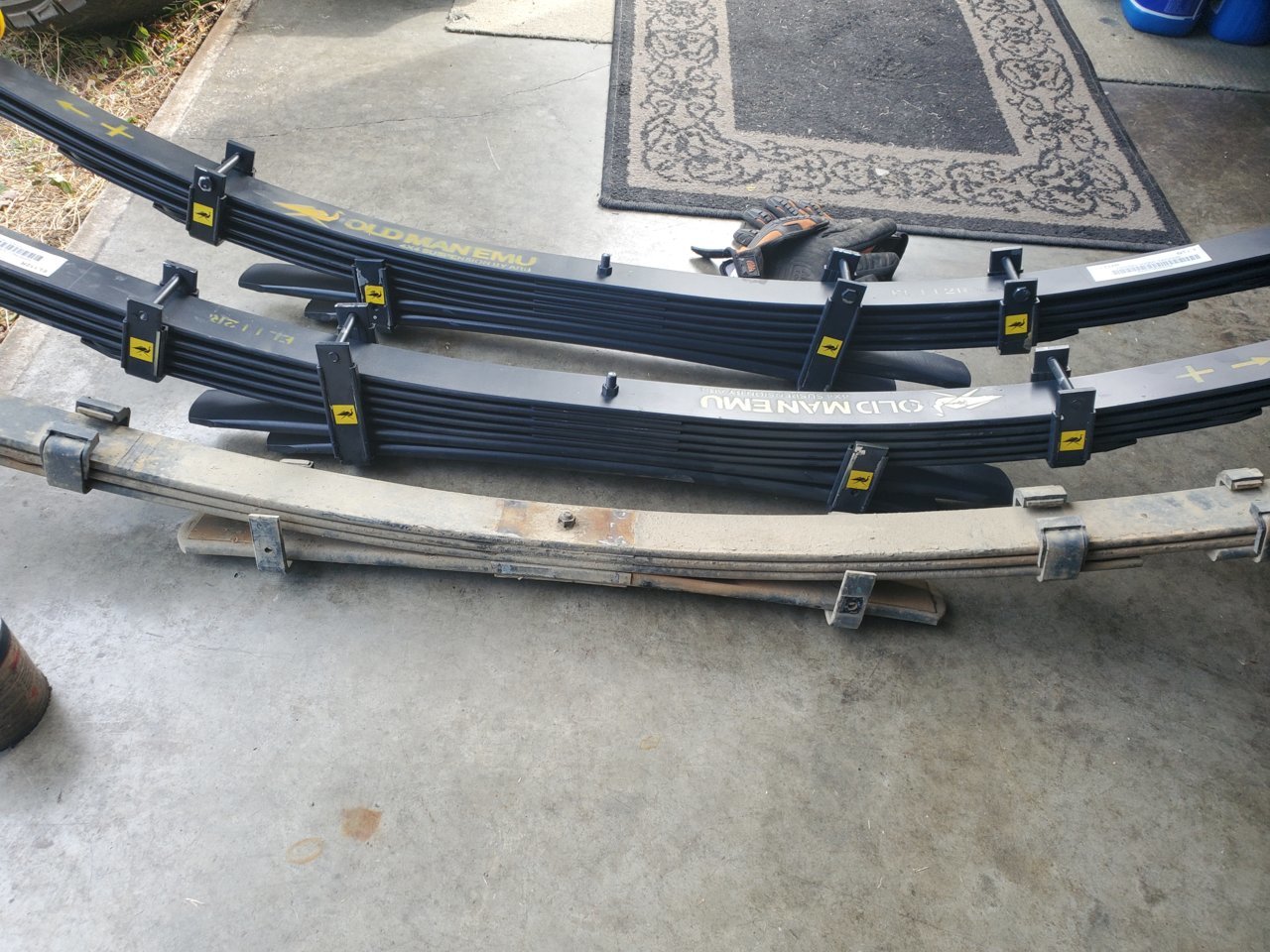

    Dobinsons 110-R or 111-R depending on weight etc.

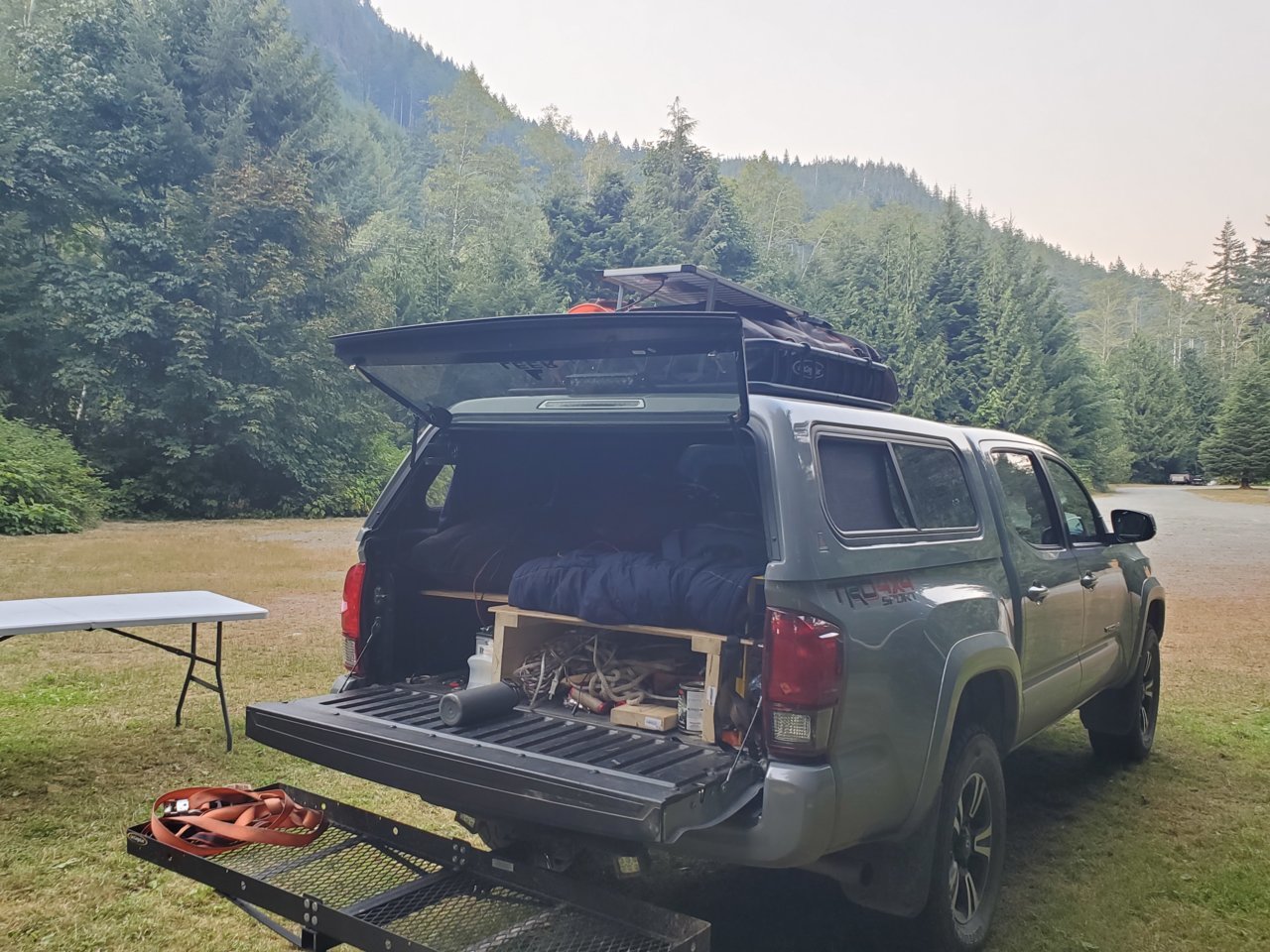

    Ome heavy duty rear leaf springs. El112r. Canopy is semi camperized, pull out tool storage , solar power with rear agm deep cycle battery. Light bars. Front rear sides. Roof basket.
    I did the ome full leaf packs el112r heavy duty

    I did just the rear leaf pack with 1 degree shims and stock shocks all around and havnt had any issue. Not a hard wheeler but definitely not a pavement princess lol i enjoy the ride now vs stock.
